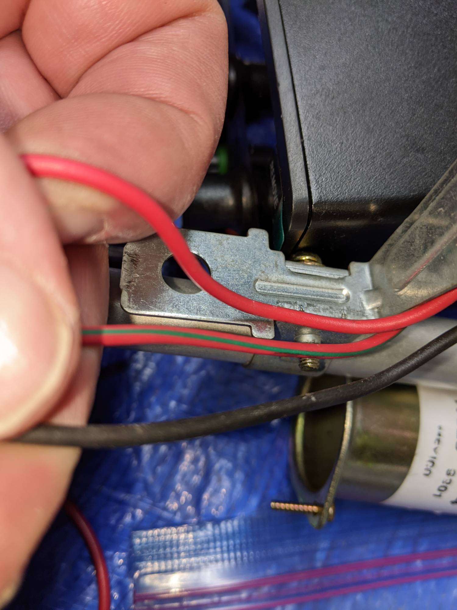

That is great help except my wires are different at the antenna end. Pictures below:
This is a genuine Volvo unit based on the picture with the motor cover below:

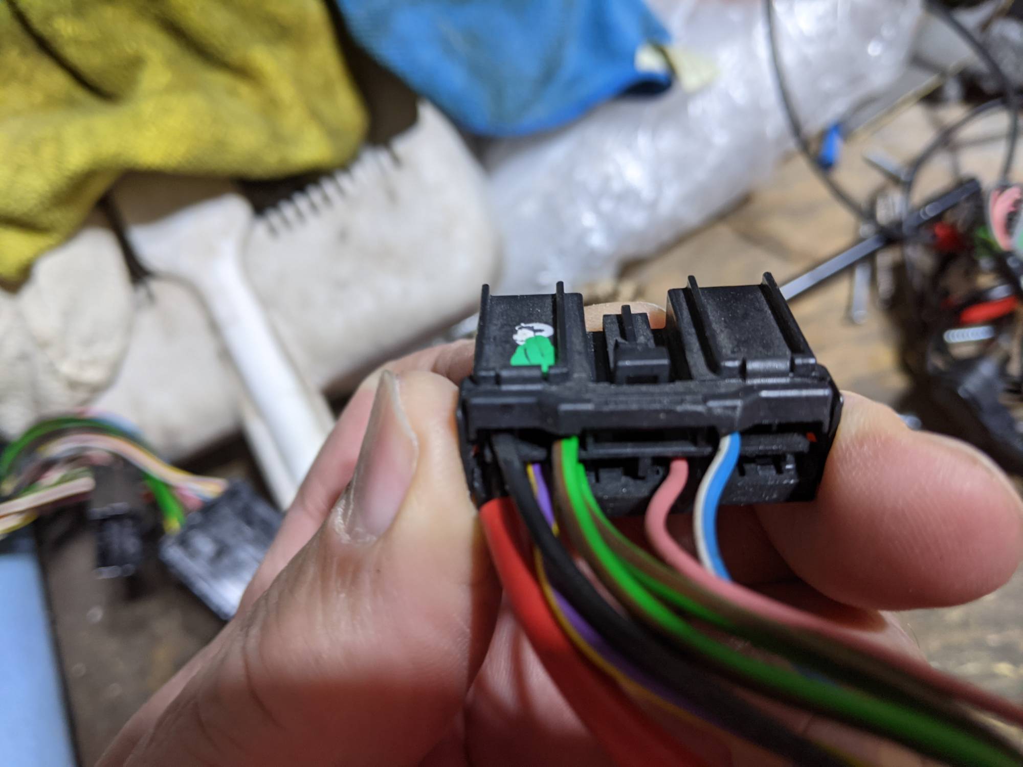

I believe the colors you may be talking about are the ones for the wiring harness from the head unit? I believe the wire from there is blue/white if I recall. You can see it here in this picture at the harness at the back of the head unit
Looking at your info, I would see it as:
I need constant 12V on the Red/Green wire and a ground on the black, but then a switched power signal to the solid Red wire? Does that sound about right? I can easily do that with my power supply for my audio test kit and run 2 switched power wires. Switching the Red/Green on first and then the Red which should then power the antenna to raise. Switching the Red wire power off it should lower. Seems simple enough............!!

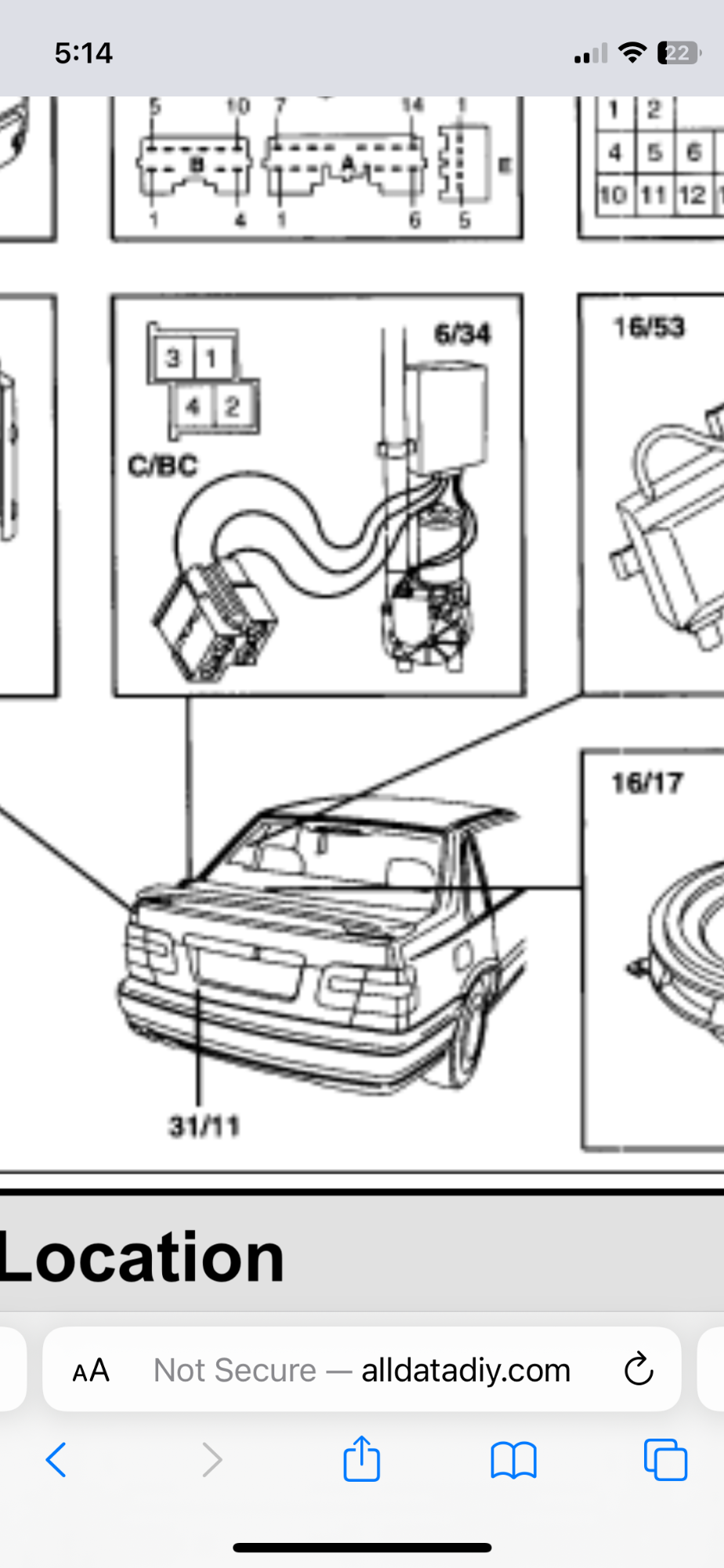

- Posts: 36145
My diagram shows power up on green red , ground on Black , and control signal on Blue White

Well it worked. Well sort of. I used some crocodile clips and wires and connected to my switches and when the red/green wire was switched on Nada, nothing. Then turned on the Red wire and the motor hummed but not much happened. Switched it back off and it hummed again. So I am assuming either the mast is stuck or the plastic toothed drive cord has stripped a few teeth. I have a spare MTC mast so I can install that.

Still trying to figure it out, but at least realised from Abscate's wiring diagram above, that the GR (green)/R (red) wire is a constant power line which runs directly to the antenna.
The BL (blue)/ W (white) wire runs from the back of the head unit and not from the ignition switch as I assumed.
The only other wire remaining is the SB (black) wire which is the ground wire.
