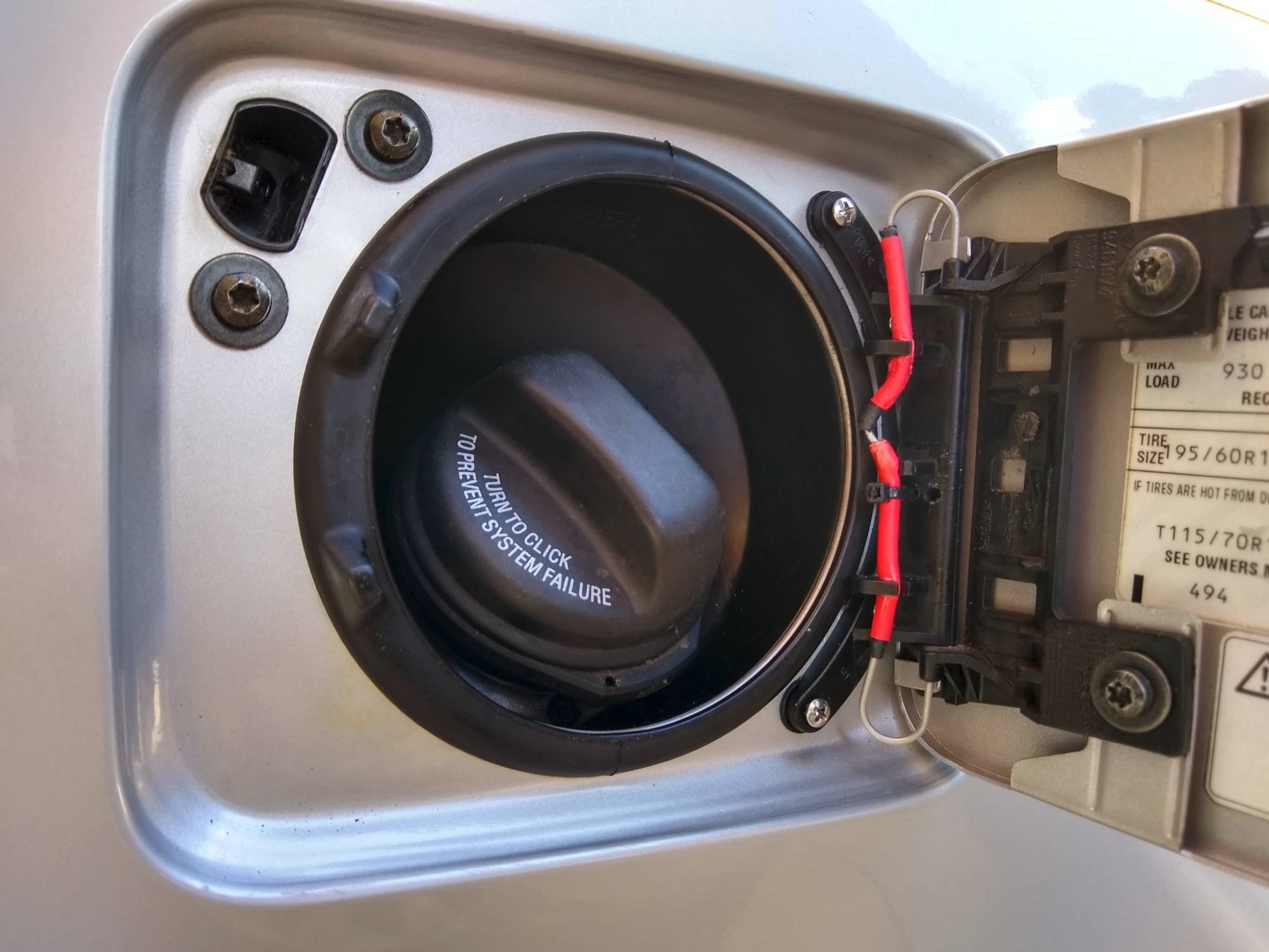

.MrAl wrote: ↑19 Feb 2023, 08:22 Hello there,
One of the gas station attendants banged on the gas door hatch and broke one of the pins that holds the hinge on the car body.
It's not the hinge itself that broke, just the pin that holds it to the body of the car near the gas cap.
Is that pin a rivet or a machine screw or something else?
Is there some way to fix this, and if so, what would be the best fix?
Thanks much for any ideas especially if you've had to do this before too.
May be similar enough. As mentioned it would no longer be a break away, perhaps as Volvo intended design.
viewtopic.php?start=20&t=100706&sid=f69 ... 582b9142dc

MoVolvos wrote: ↑19 Feb 2023, 12:31.MrAl wrote: ↑19 Feb 2023, 08:22 Hello there,
Hi,
Thanks that's exactly what i would like to do. I do have a question though. I see those nice two phillips head screws but what are they anchoring into? The holes behind the holes in the plastic where the screws go through on the hinge are about twice as big as the holes in the plastic hinge. So the holes in the sheet metal body are bigger than the holes in the hinge. That means i cant put a screw that fits into the existing holes in the hinge and expect them to anchor into the sheet metal.
So how are you getting the screws to anchor into the sheet metal directly behind the plastic hinge mounting part?
Also, what is the red tubing for? I see you used a tie wrap too to hole the spring thing in the right place. That's a problem with mine too.
