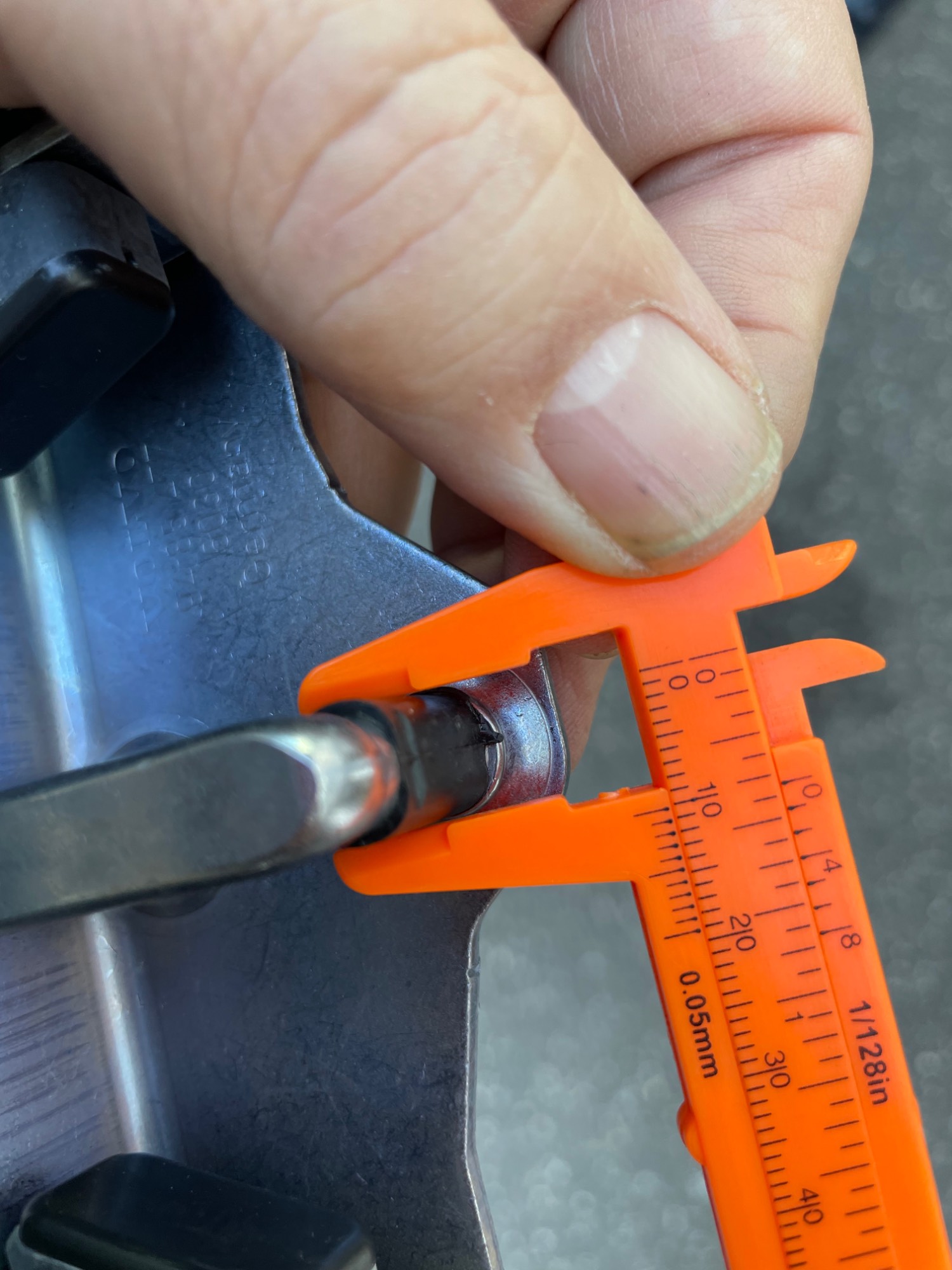

- Posts: 36137
- Been thanked: 4064 times
Since I’ve got a new one in my parts box for Shagg I can measure that thickness and report back.

- Posts: 36137
10 mm diameter on the brand new latch hook
