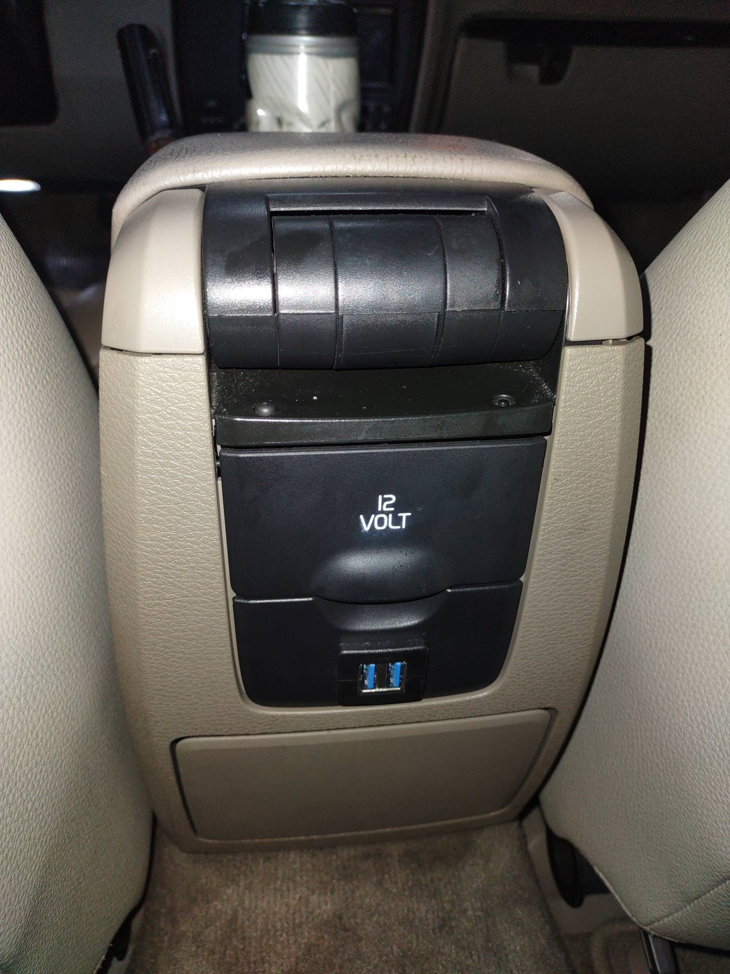

I posted this picture of USB ports I added under the rear 12v charger a few days ago In the "What did you do today'" thread. I choose this placement because it keeps the wire out of the way and had a near by 12v source. But you could be place it anywhere.
You need a 12v to 5v step down convertor. There are many ways to accomplish this. This might be the easiest if you have a USB-C port on your phone.
If you want to add ports, like I did, the step convertor is identical but with different wiring. Search Amazon for "12v to 5v step down converter car"
The basics are to find a 12v source to wire the step down to and the other end is 5v safe for USB charging.

I don't know where you got that information. This device is a buck convertor, it does not convert DC to AC. If you are referring to switching, that is not AC. Brand names don't have any special technology, they all use off the shelf IC for step down conversation. Also, whether it's hard wire or not doesn't influence how the voltage step down is achieved.abscate wrote: 26 Feb 2023, 04:36 When you buy a wired USB port for an auto the 12 to 5 volt conversion is built in. It’s done with DC to AC conversion , step down , and rectification. It’s cheap and horrriblr electronics and often a large source of electrical noise.
Stick with the names like Belkin , Blue Sea
There so much wrong with this statement I don't know where to begin explaining the theory behind step down converters. But AC and rectifying is not involved.
