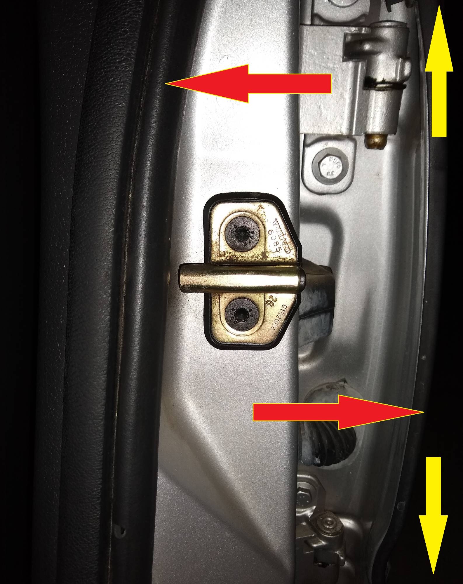

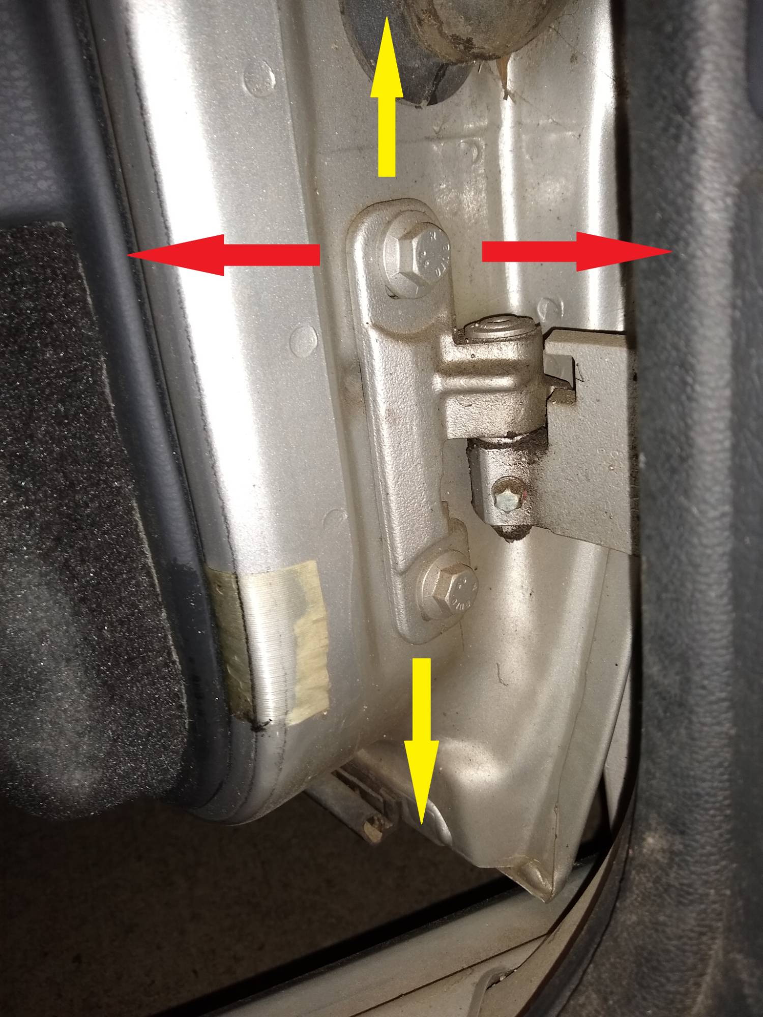

Looking at the back door hinge, first photo, the whole door can go up and down while the top and bottom moves in and out. The door can't move forward to the left nor back to the right if you facing it. Adjust as close as possible and tighten the striker end first and then use that as the pivot for the front hinge adjustments. Understanding the door movement when closed will help you adjust accordingly.
1) Rear hinge when door is closed for movement reference. This is key!
2) If the door or chassis is not within spec you may have to angle the striker slightly for smooth entry while shifting slightly up or down to close.
3) Front door hinge for reference
