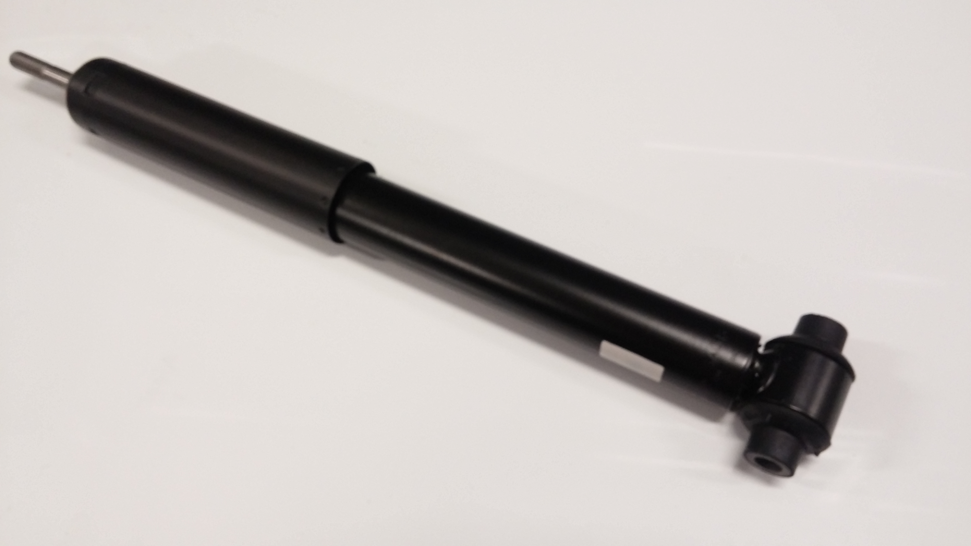

Post by ggleavitt »
Suspension code plaque on the vehicle will tell you exactly what you have. See this link for reference- viewtopic.php?t=96671
Regular rear shock (tube and tube)
Nivomat rear shock (look for the much larger tube on top plus the rubber accordion)
edit- add link, change Nivomat photo
