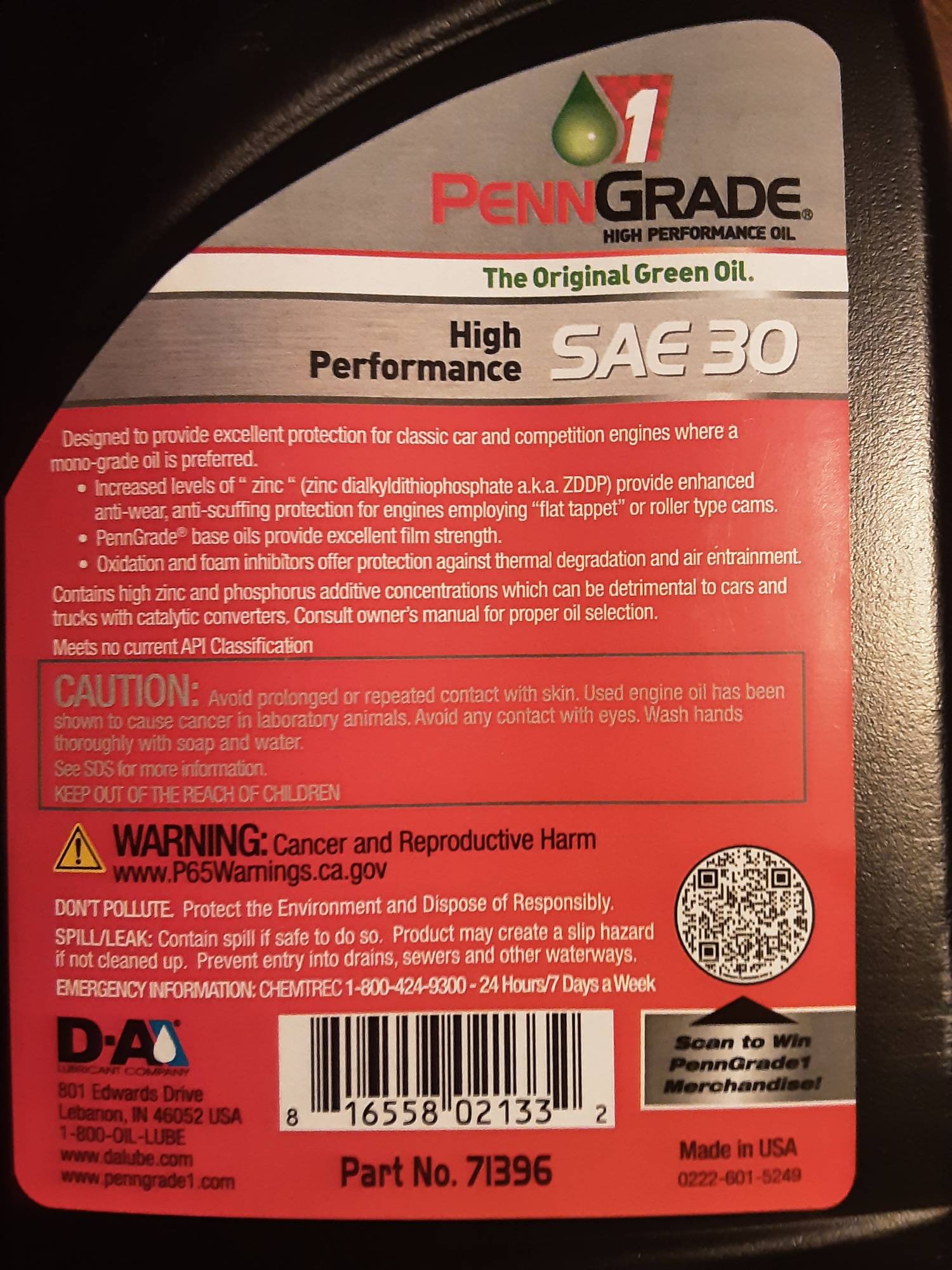

In the Porsche world Swepco & Brad Penn are both used for the high ZDDP.
Swepco 306 and Brad Penn Racing 1 oils

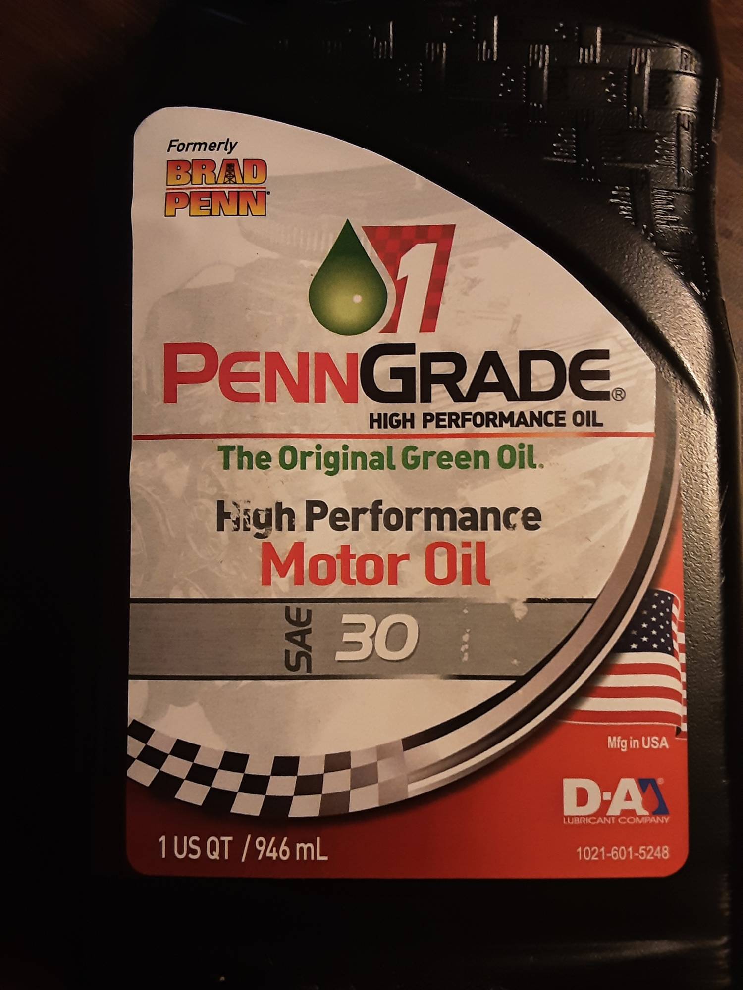

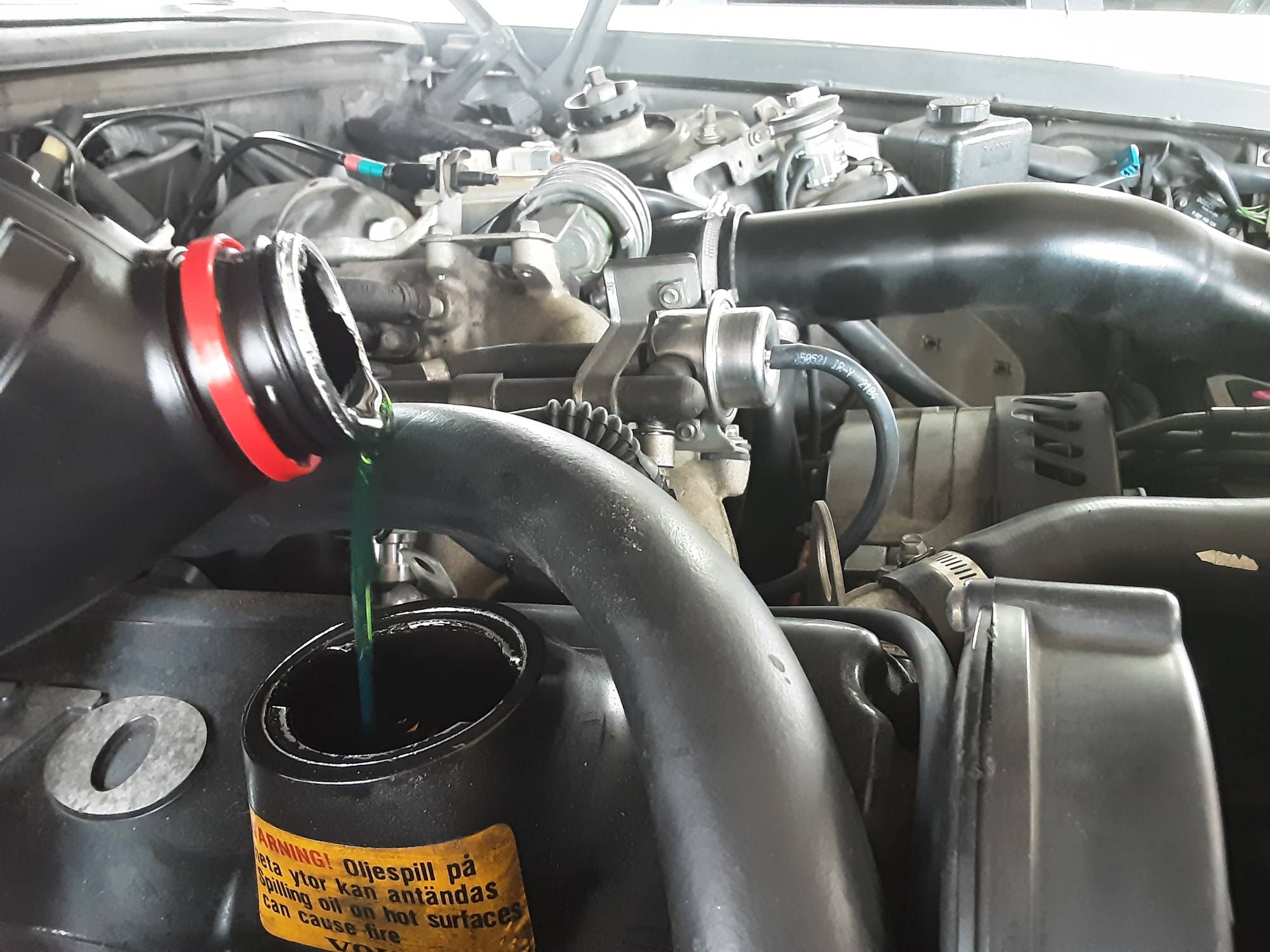

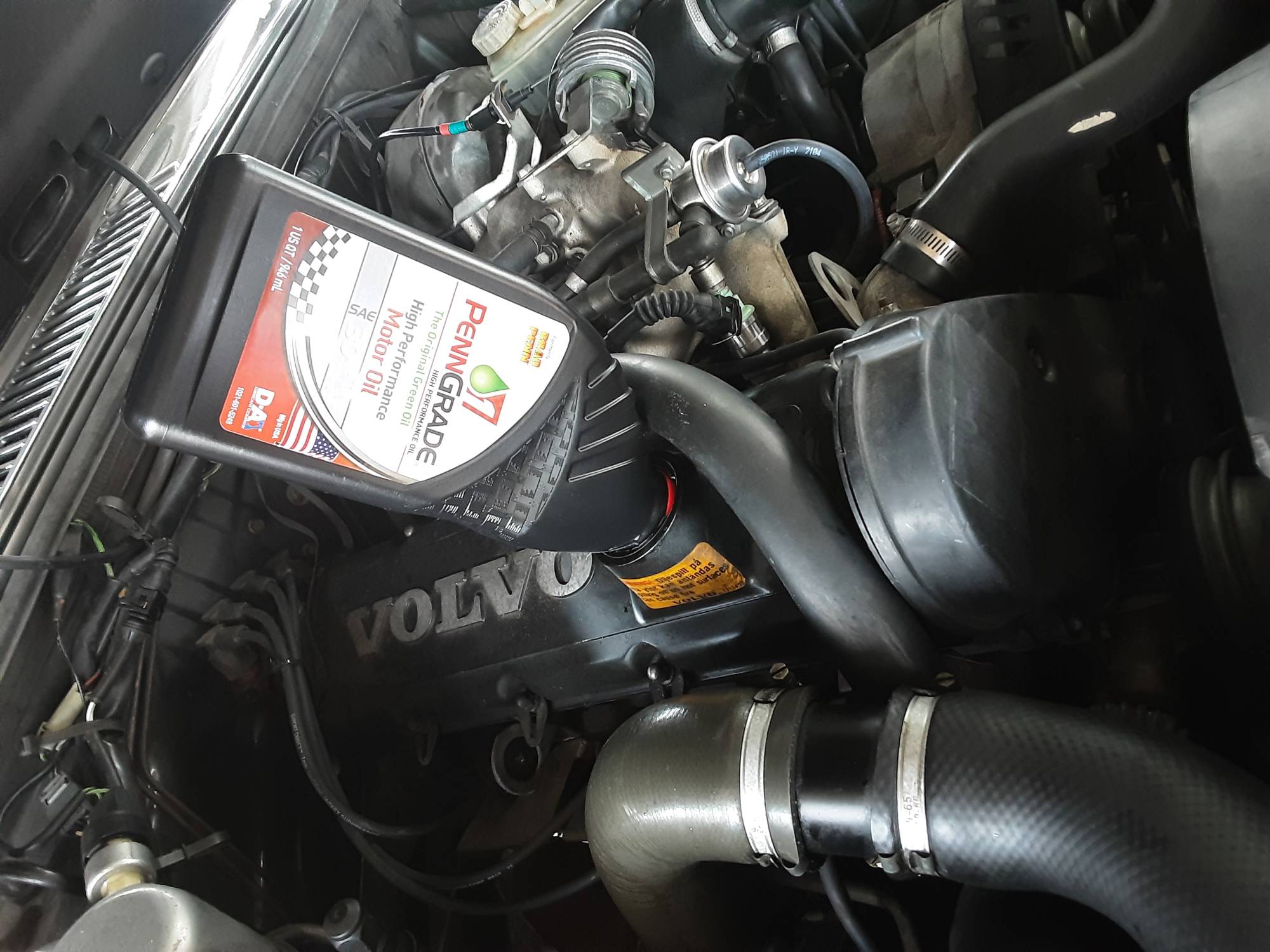

+1 for the Prad Penn oil MoVolvos recommend. It's called Penngrade 1 now. I am using the SAE 30 high performance oil in my 1991 740 Turbo. The car really likes it. It is green in color. June
