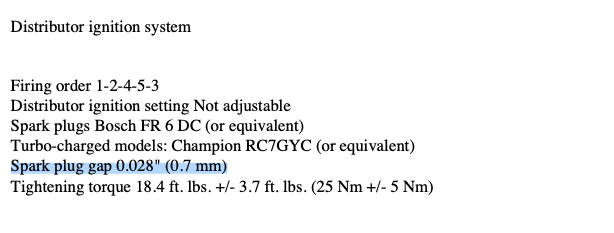

All 850 models should have the plug gap set to 0.028" (0.7 mm)
Taken from the owners manual
plug gap.png (32.15 KiB) Viewed 819 times
