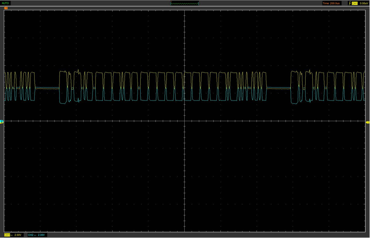

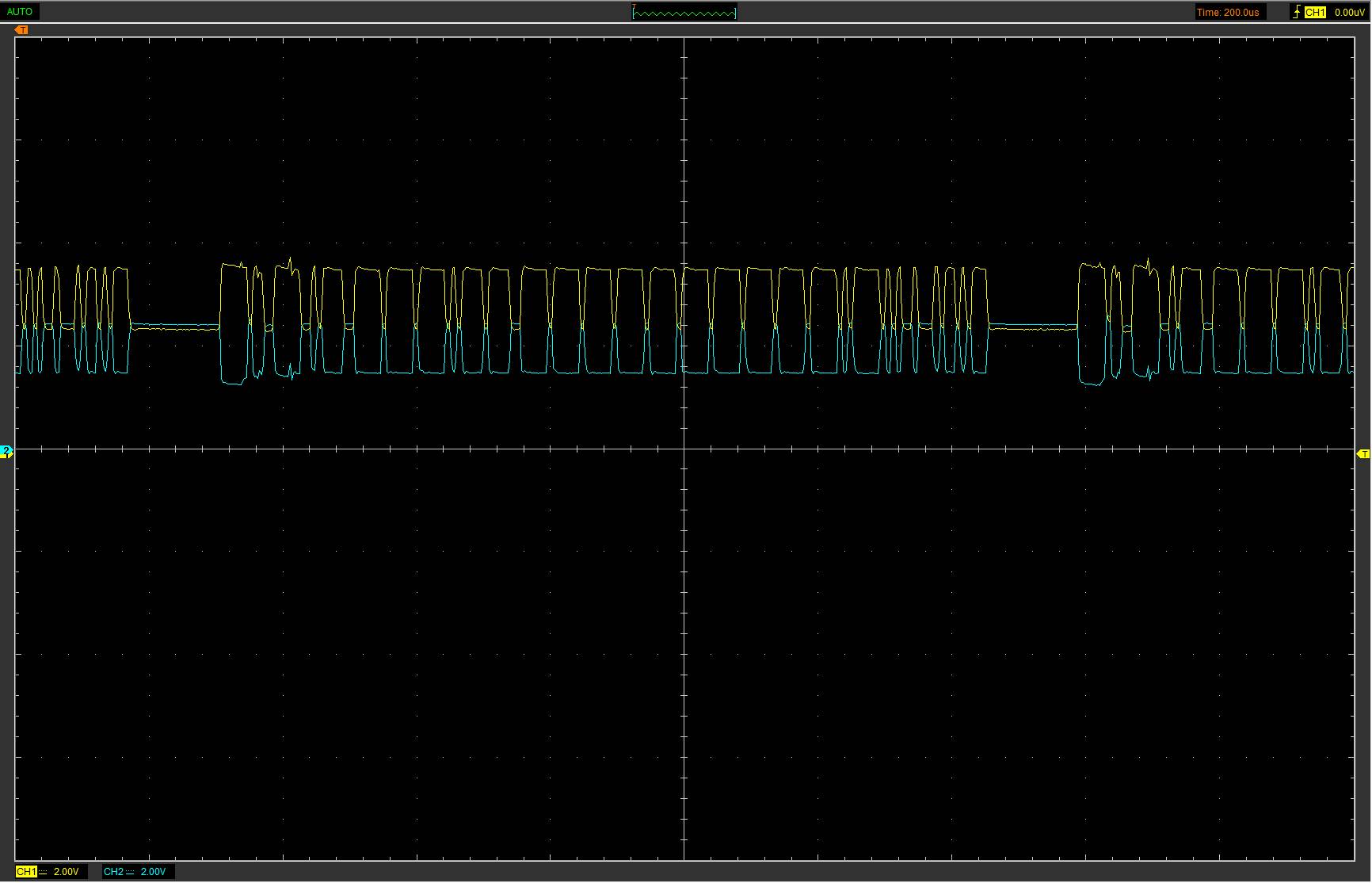

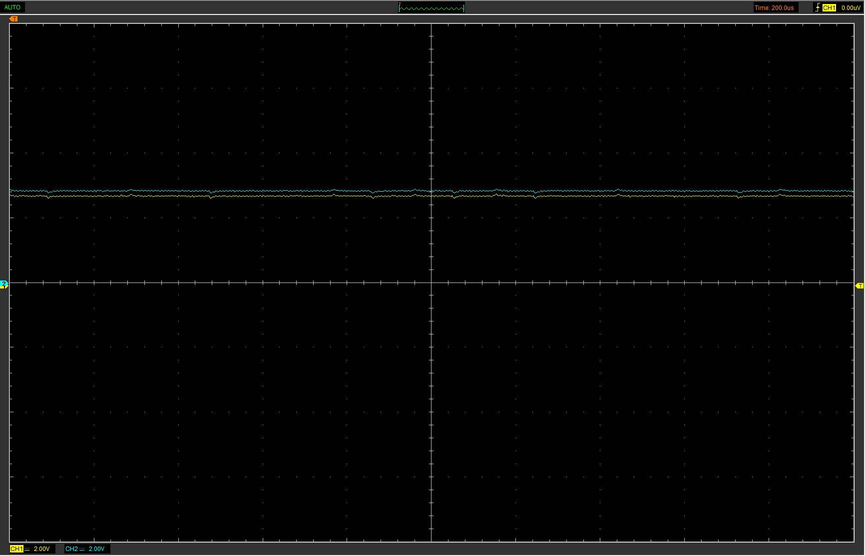

I just picked up a Hantek 1008C oscilloscope and started testing CAN BUS lines. The lines into the DIM showed good waveforms, as did those into the steering column. I pulled down the CEM and 4 of the 5 CAN BUS lines showed good waveforms. One green/white pair, however, showed about 2.3V but with no waveforms (see file).
Anyone how to identify where this pair leads? Anyone have a pinout for the CEM connector?
