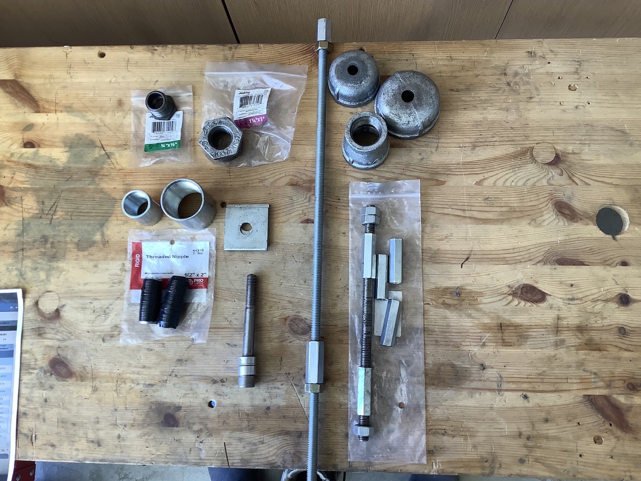

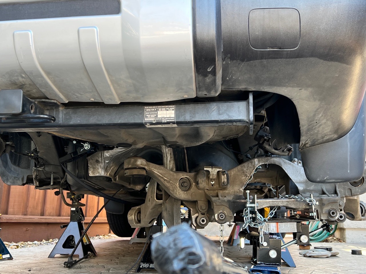

Since I have removed the rear differential and all the suspension components I wanted to replace some of the rear suspension bushings while I have everything apart.
The main reason for pulling the rear sub frame was for the upper control arm bushings (number 12). They were in worse shape than the trailing arm bushings.
I used a Jack adapter from Amazon (Performance Tool W41044 Transmission Jack Adapter for Cars, Trucks, and other Vehicles https://a.co/d/hkrAl5f) and was able to remove the rear subframe through the wheel well opening, while the car is on 6 ton jack stands. I pretty much followed the Vida procedure except I unbolted the charcoal cannister and Evap pump from the sub frame instead of disconnecting 17 year old hoses.
I already have replaced the trailing arm bushings, bushing 4 in the parts overview,(https://www.fcpeuro.com/products/volvo- ... r-31277893) while the sub frame is still sitting on the Jack adapter.

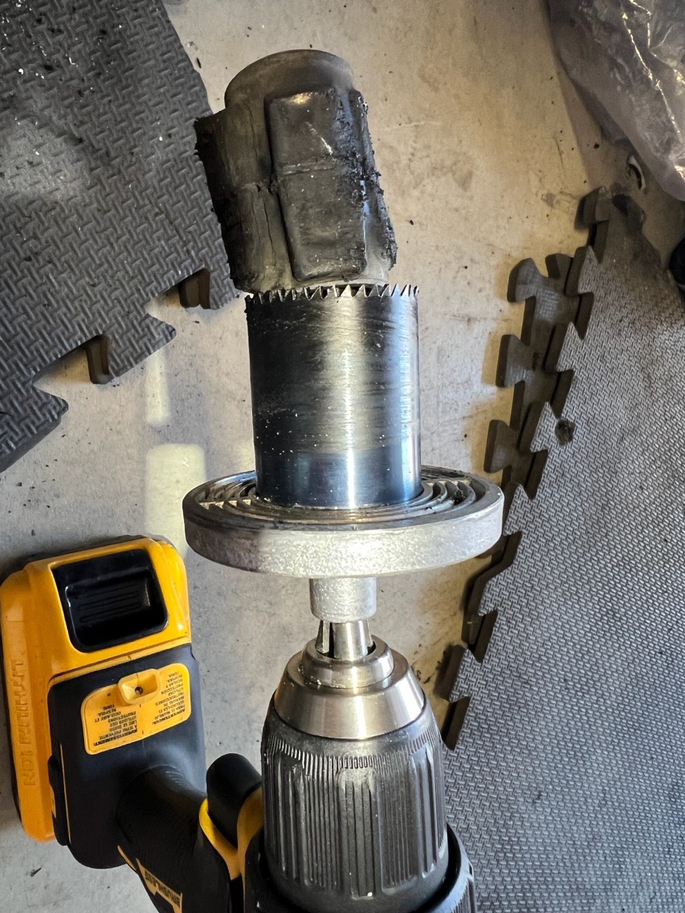

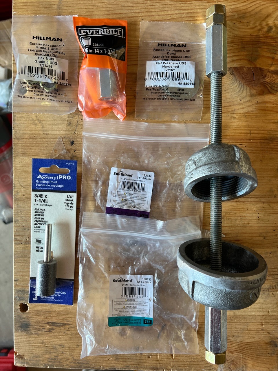

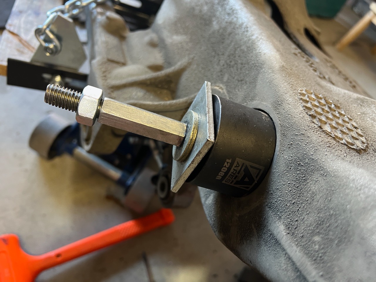

I ended up modifying galvanized end caps. Al you need for tools is a 1/2” drill, drill and grinder with a flex disc. All parts can be purchased at Home Depot. See the pictures for the parts I purchased (FYI threaded rod I used was 6/17 thread, 1/2” was a backup plan) The small end cap needs the trough hole and the casting burr’s removed at the bottom.
The larger end cap burrs from the bottom, chamber on the bottom outside edge and the inner threads removed with the grinder to clear the bushing outer dimension. Make sure to apply grease to the threaded rod and washers.
The bushing went in smoothly with a bit of silicone spray and leaving the bushings in the freezer overnight. I did not want to risc it with plastic parts breaking half way and loosing the effect of putting the bushing in the freezer.
Also it is much easier to setup than with a heavy c-clamp and many loose parts. Tried this on other bushing replacements.

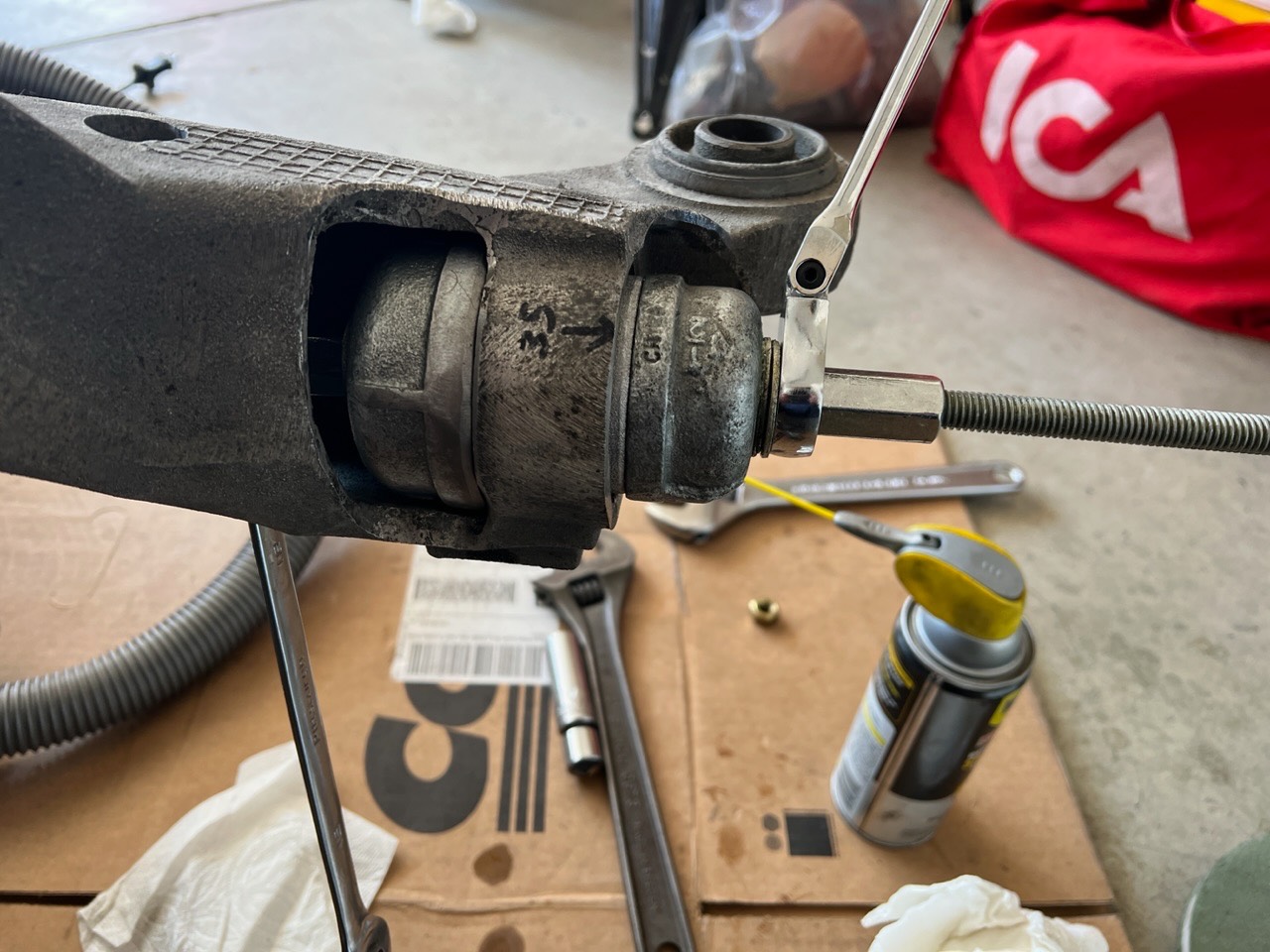

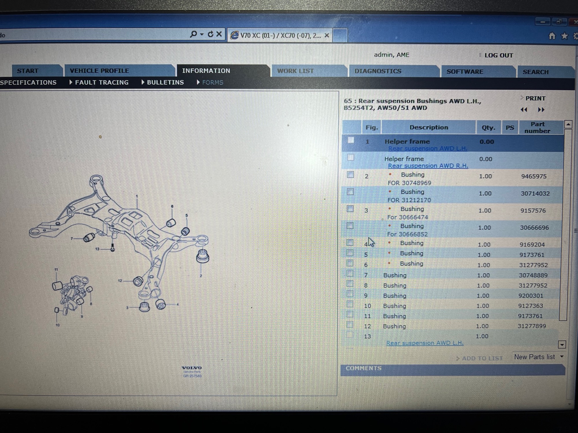

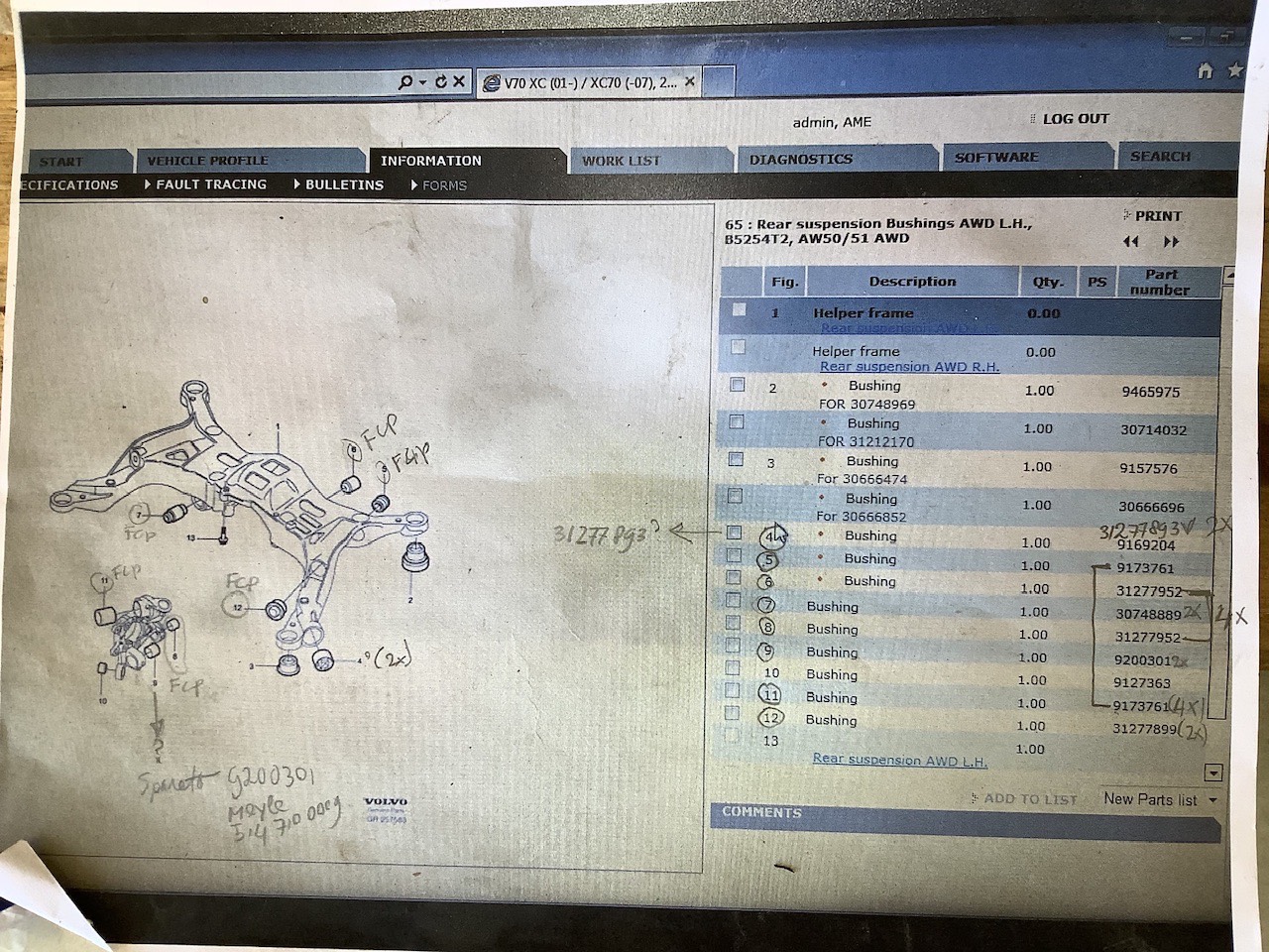

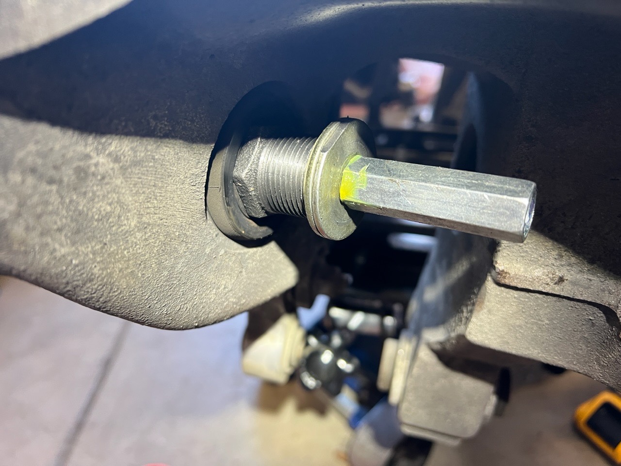

Bushings 12,5 of the upper control arm replacement: (see picture 1)
https://www.fcpeuro.com/products/volvo- ... er-9173761
https://www.fcpeuro.com/products/volvo- ... r-31277899

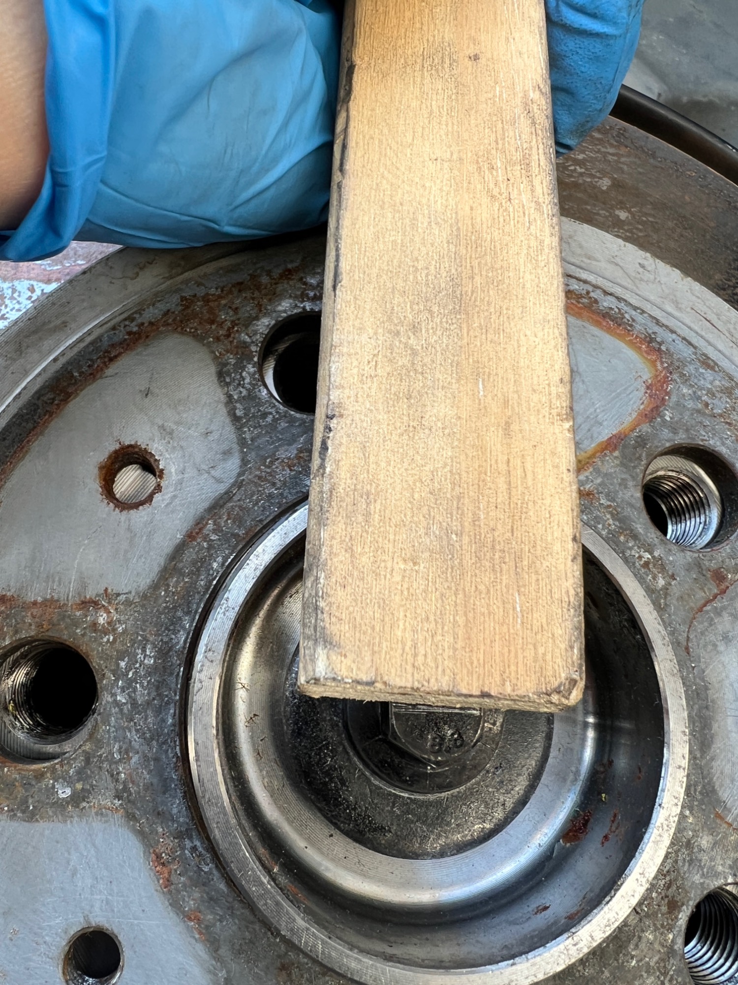

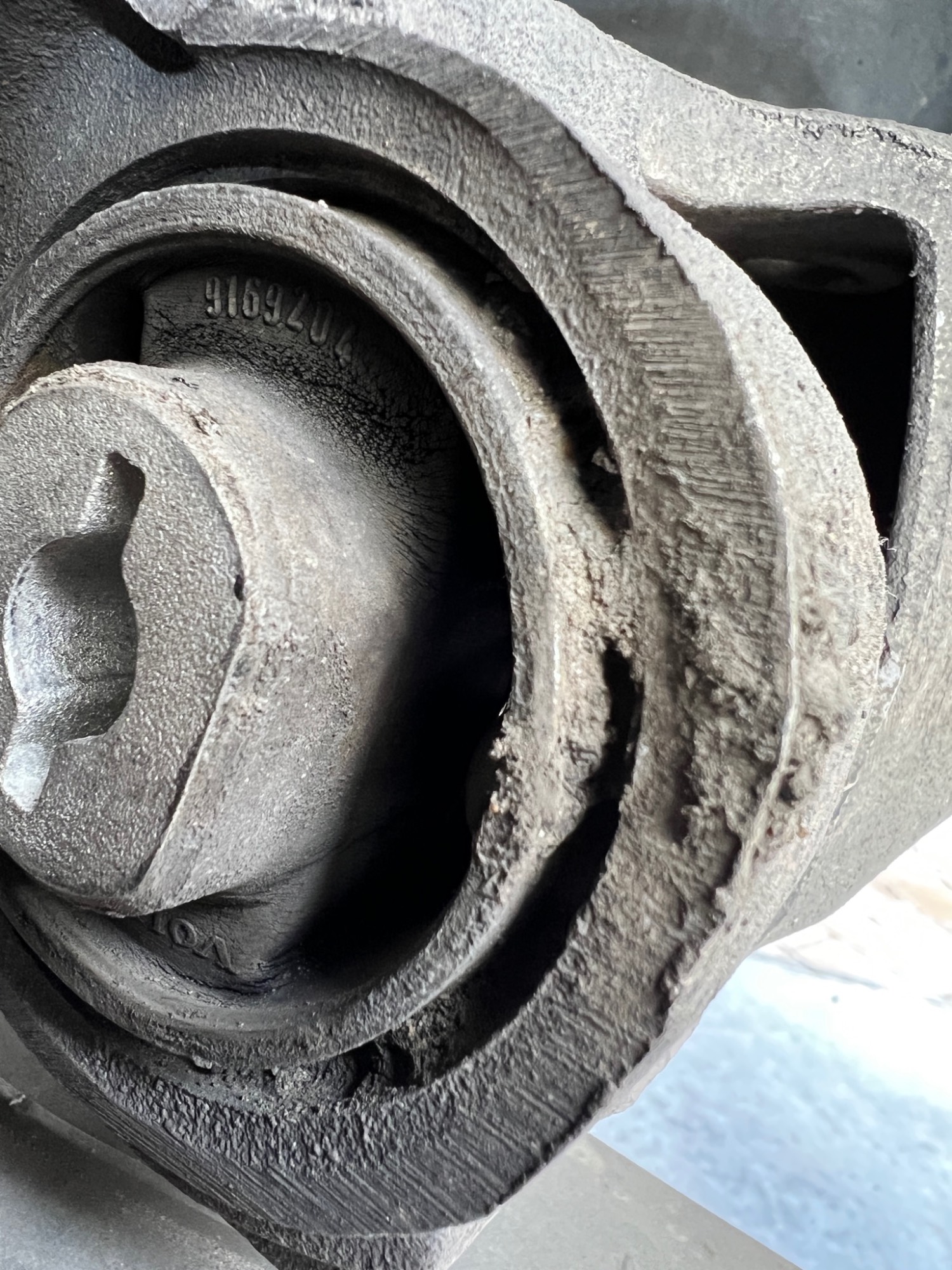

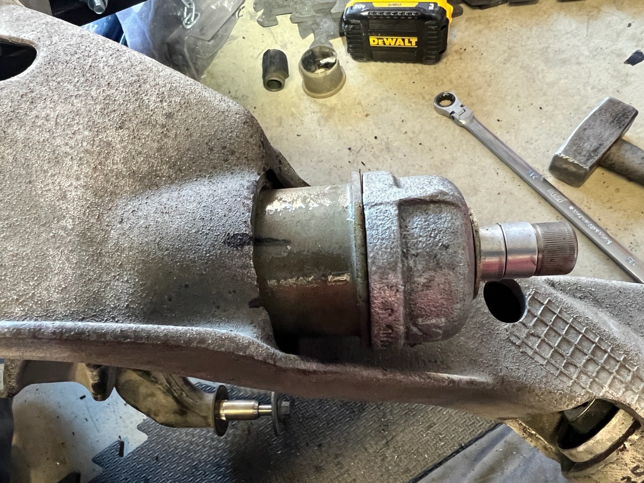

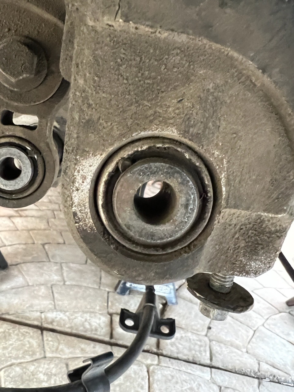

Removing bushing 12 first allows you to remove the control arm. (Picture 5,6) the sleeve appears to made from a pvc like material.

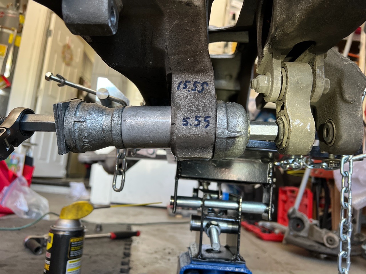

Than push out bushing 5, (picture’s 4, 7, 8 )
Install a new bushing 5 first, (picture 9) I used silicone grease on the bushing.
Install bushing 12 in the same orientation, mark position beforehand. Meyle bushing don’t have an orientation mark (picture 10) silicone spray as lube.

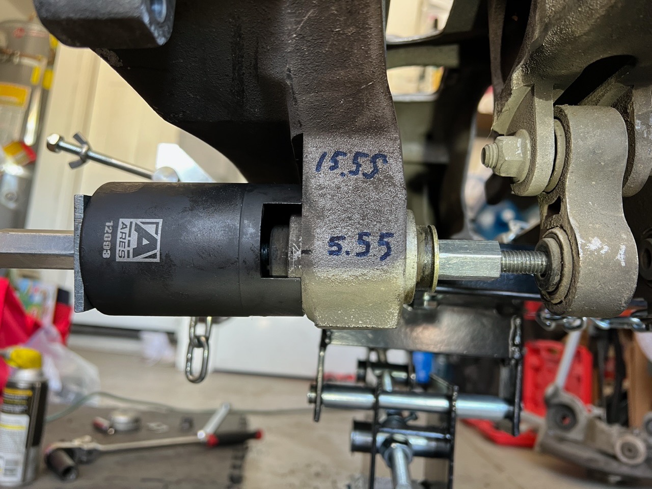

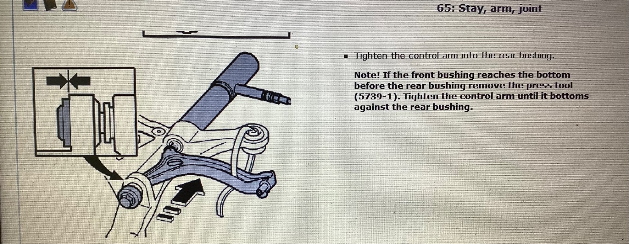

Then pull in the control arm with the M12 threaded rod adapter from the Ares kit and bushing 12 bolted to the control arm with a M12x90 bolt and an end cap. (Picture 3, 11) make sure it is fully seated. See picture 12.
Vida instructions tell you to keep the arm in a position measuring from the sway bar. This is hard to do, but after installing, you can force the arm up and down , wearing down the serrated surface digging into the bushing and install at ride height when putting the complete suspension together.

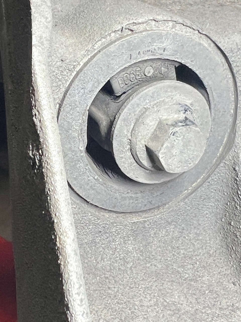

Tools:
ARES 12072 – 14-Piece Ball Joint Press Adapter Expansion Set – Use with Starter Kit 12068 and for Master Kit Coverage – Services Ball Joints and U-Joints on 2WD and 4WD Vehicles https://a.co/d/eJlDqlt
M12 X 1.75 x 50mm Long Rod Metric Hex Coupling Nut, Zinc Plated 5 Pcs https://a.co/d/hguievh
Feelers 304 Stainless Steel M12-1.75 Fully All Threaded Rod, Long Threaded Screw, Right Hand Threads, 250mm Length https://a.co/d/fexNiGP
Other pieces purchased at Lowe’s and Home Depot.( Picture 2)

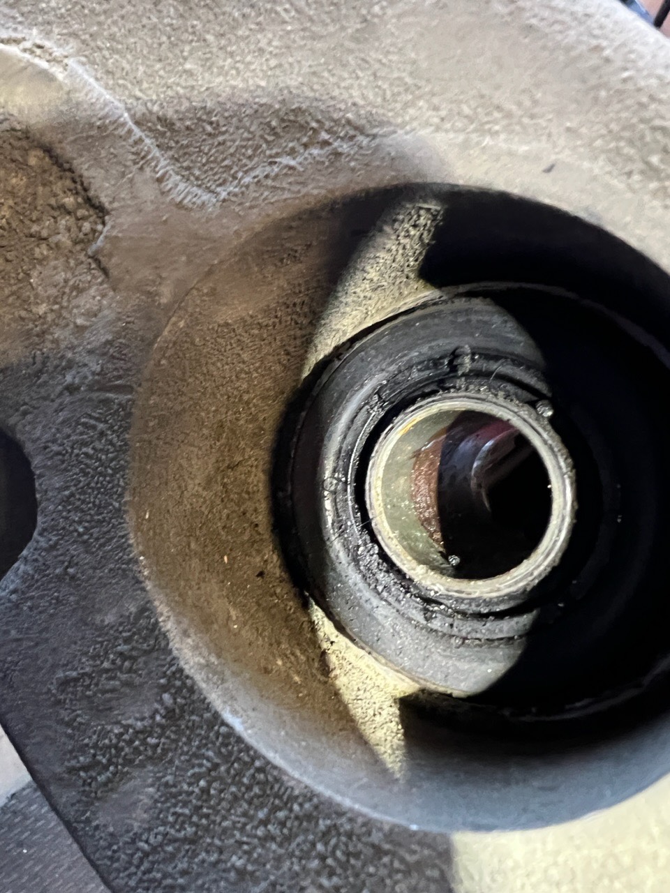

Installing bushing 7: see picture 1, 2
https://www.fcpeuro.com/products/volvo- ... r-30748889
I tried to cut out the bushing but the saw was getting stuck and opted for simply pressing out the complete bushing. See picture 3, measure the install depth beforehand, other wise the arm will not fit in the opening.
Press in the new bushing, picture 4. Put it in the freezer beforehand and use silicone spray.

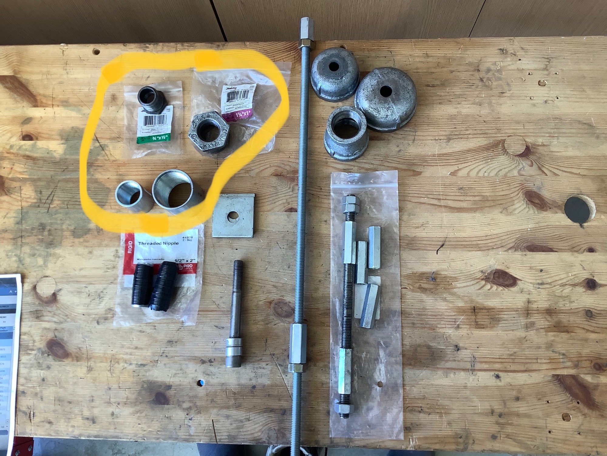

Installing bushing 9 into the knuckle.
https://spareto.com/products/meyle-cont ... 4-710-0009
Was not available at the time from FCP
I forgot to take pictures, but just press out the complete bushing.
And press in the new bushing. Make sure to putt them in the freezer and use silicone spray. And measure the install depth beforehand.
I used the sleeves in the yellow circle. I did this with a large c-clamp I purchased for this job. But it was very cumbersome. I would recommend using the the threaded rod instead.

Installing the subframe, I used the threaded nipples 1/2” x 2 and electrical tape the reduce the play to align the subframe. Picture 1
For setting the ride height before torquing down the suspension hard ware I marked the axle bolt and cut a wooden stick to length. Picture 2
