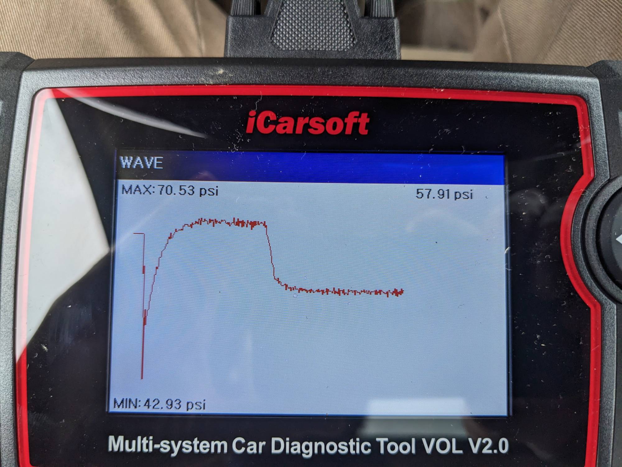

For the fuel pressure sensor, it seems to read the pressure at the rail reliably and I don't think this could be the problem (see picture below).
For the fuel pump, since it can deliver up to 80 psi consistently, so I don't believe it's the issue either.
Fuel pressure at start (70 psi for a few seconds then down to 58 psi)

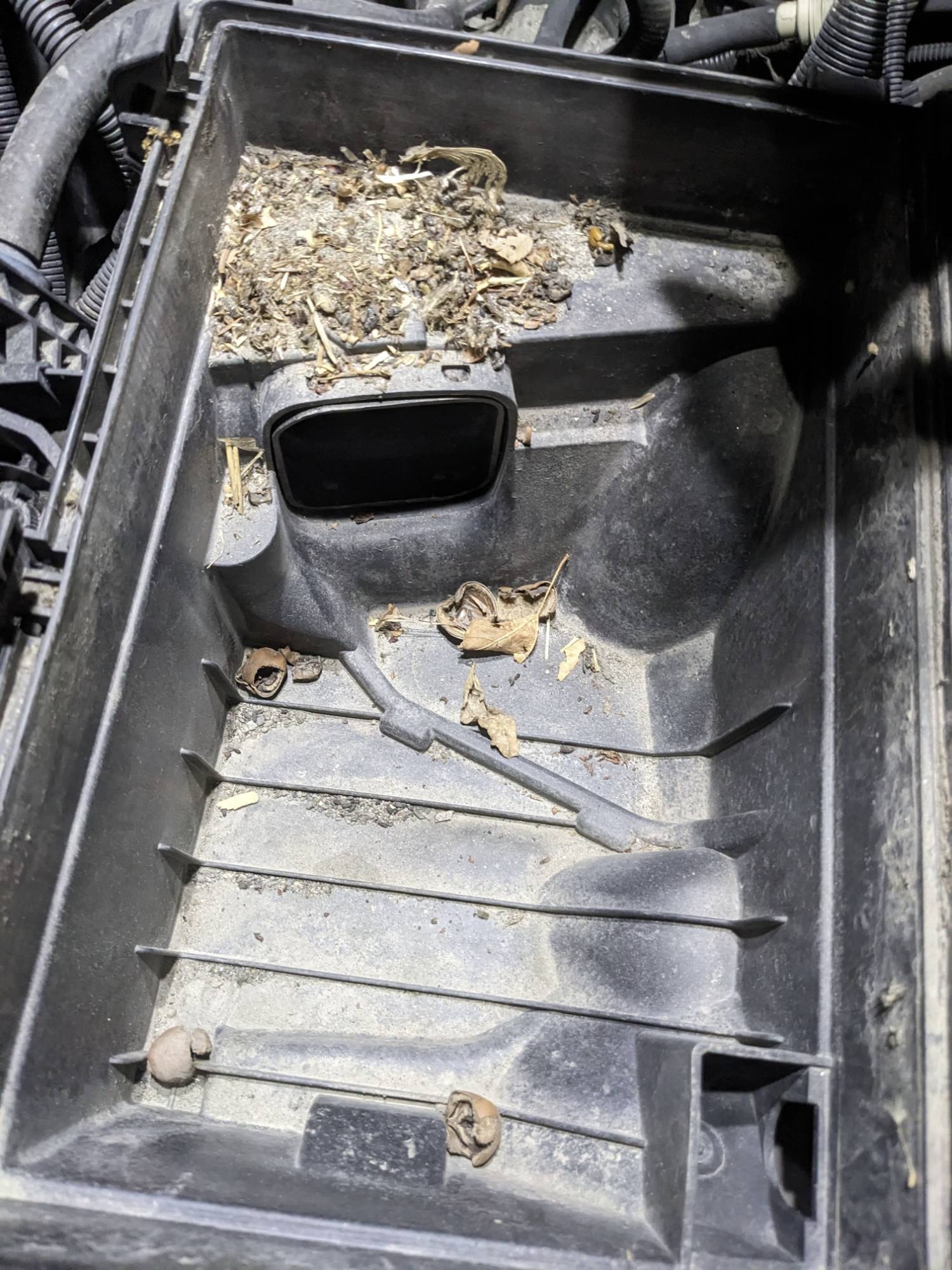

All right, here's some news from some early assessment of the air hoses.
First, the fresh air hose wasn't fully seated in the front of the car (the end with a rectangular shape).
Second, the air filter was full of debris (see picture below).
I doubt those two problems were the issue but I could be wrong.
That's the only thing I found for now. I'll keep looking I guess!
