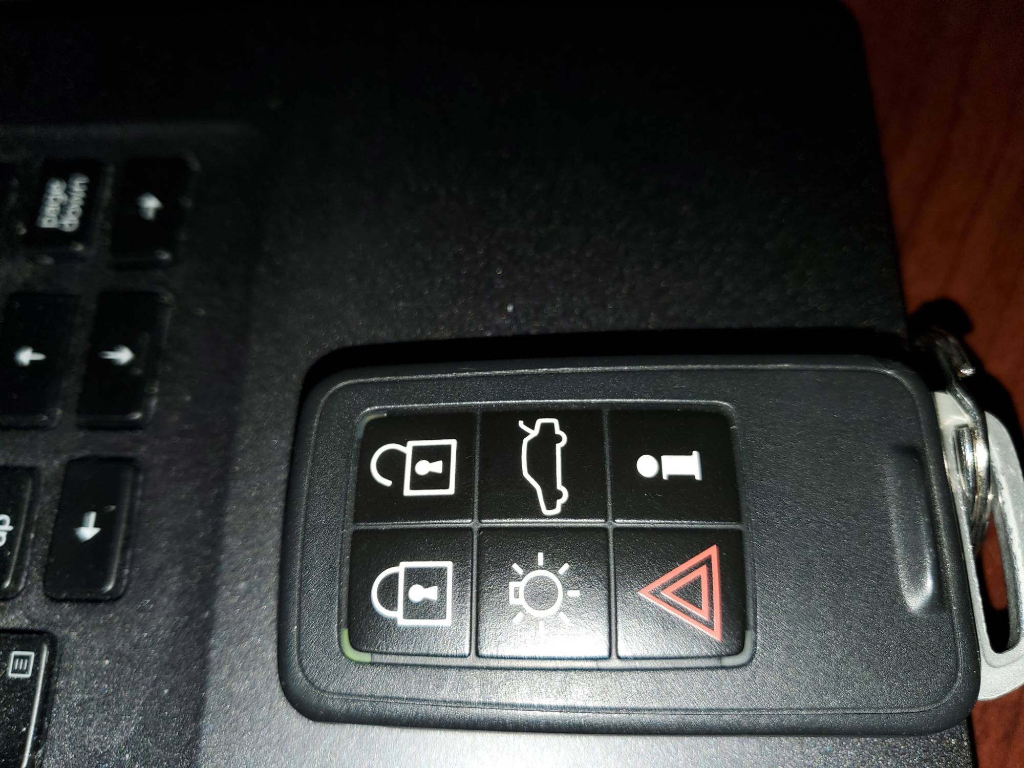

Hi Regent,
Thanks voor your response, I do not have the PCC option on my car, at least I do not have that type of key, I have the 5 button key without LED's on it. (this PCC looks a very nice addition but would cost allot to add to my car I guess)
i noticed that I kdo not hav 100% loss of locking the door. sometimes it does lock and other times it does't. I did change the "My V60" settings to only opening driver door when unlocking.
I am not giving up and will do some more approaches/tests.
