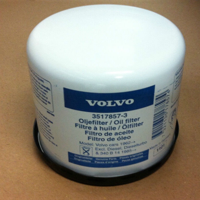

Genuine Volvo filter isn't expensive. Part number 3517857

misha
Posts: 5379
Joined: 7 December 2008
Year and Model: '97 850 2.5 20v
Location: Serbia
Has thanked: 152 times
Been thanked: 402 times
Post by misha »
It costs around 5x more in Volvo dealership than one Mann,Knecht(Mahle) or Bosch...at least in EU.
Genuine Volvo oil filter could be one of those brands.
We can't get them nowhere except at dealership only.
Bosch,Mahle or Mann are around 7-8€.
Genuine Volvo is 40€+.

Post by P80GLT »
Someone taking the Micky in the USA then, they are around £7-£10 in the UK for genuine Volvo filters
