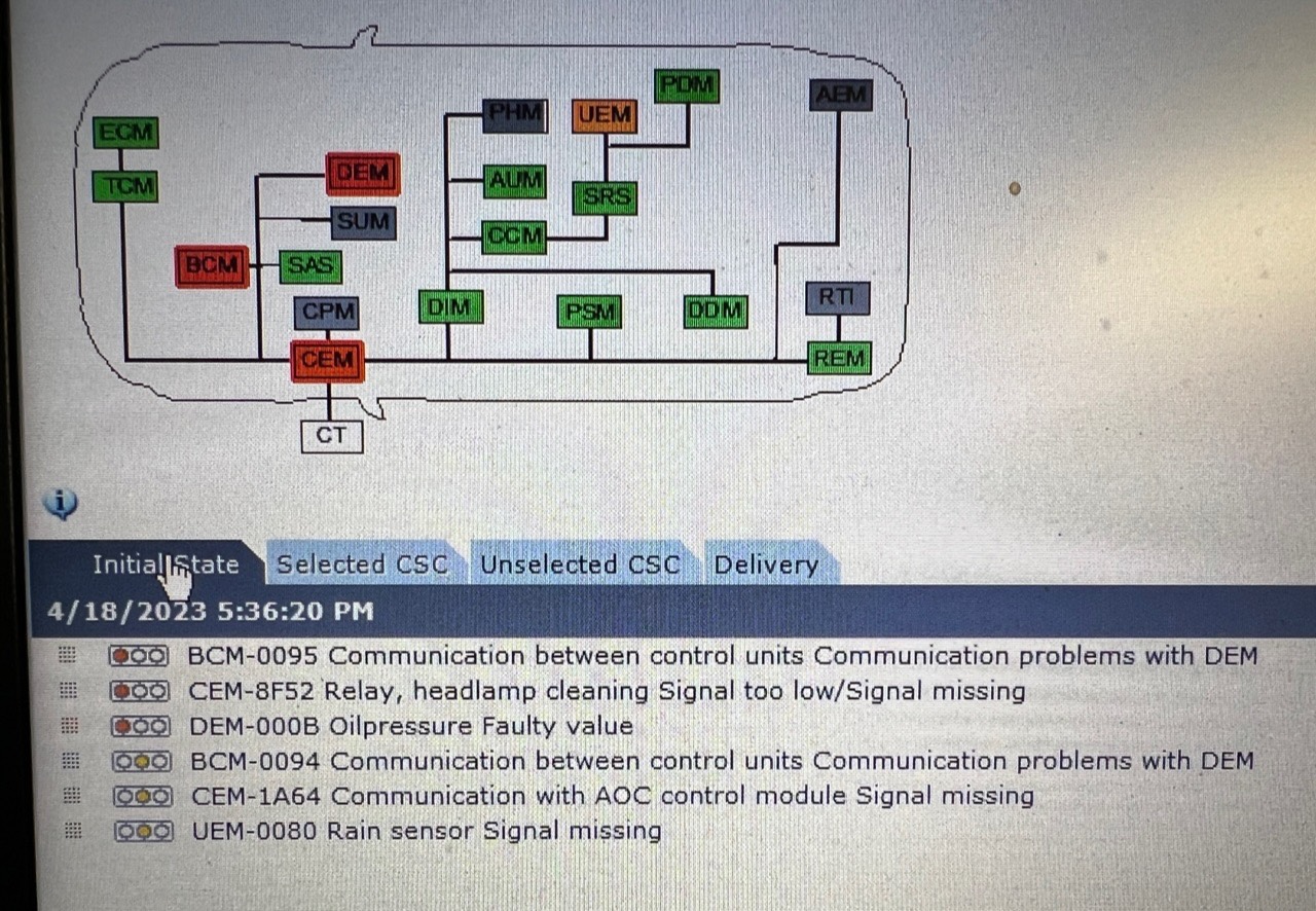

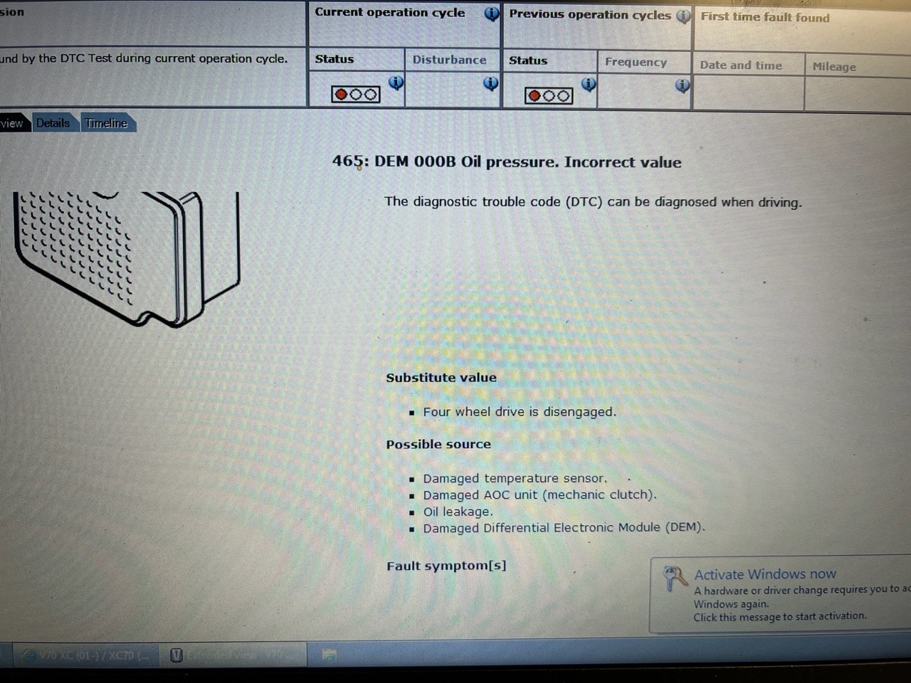

BCM-0095 & DEM-000B are the codes the reappear after the anti skid error message. The fault codes have a faulty Dem in common. Anyone have experienced the same?
Attached 2 pictures of the Vida scan and information.
BCM-0095 & DEM-000B 2006 Volvo XC70 Topic is solved
