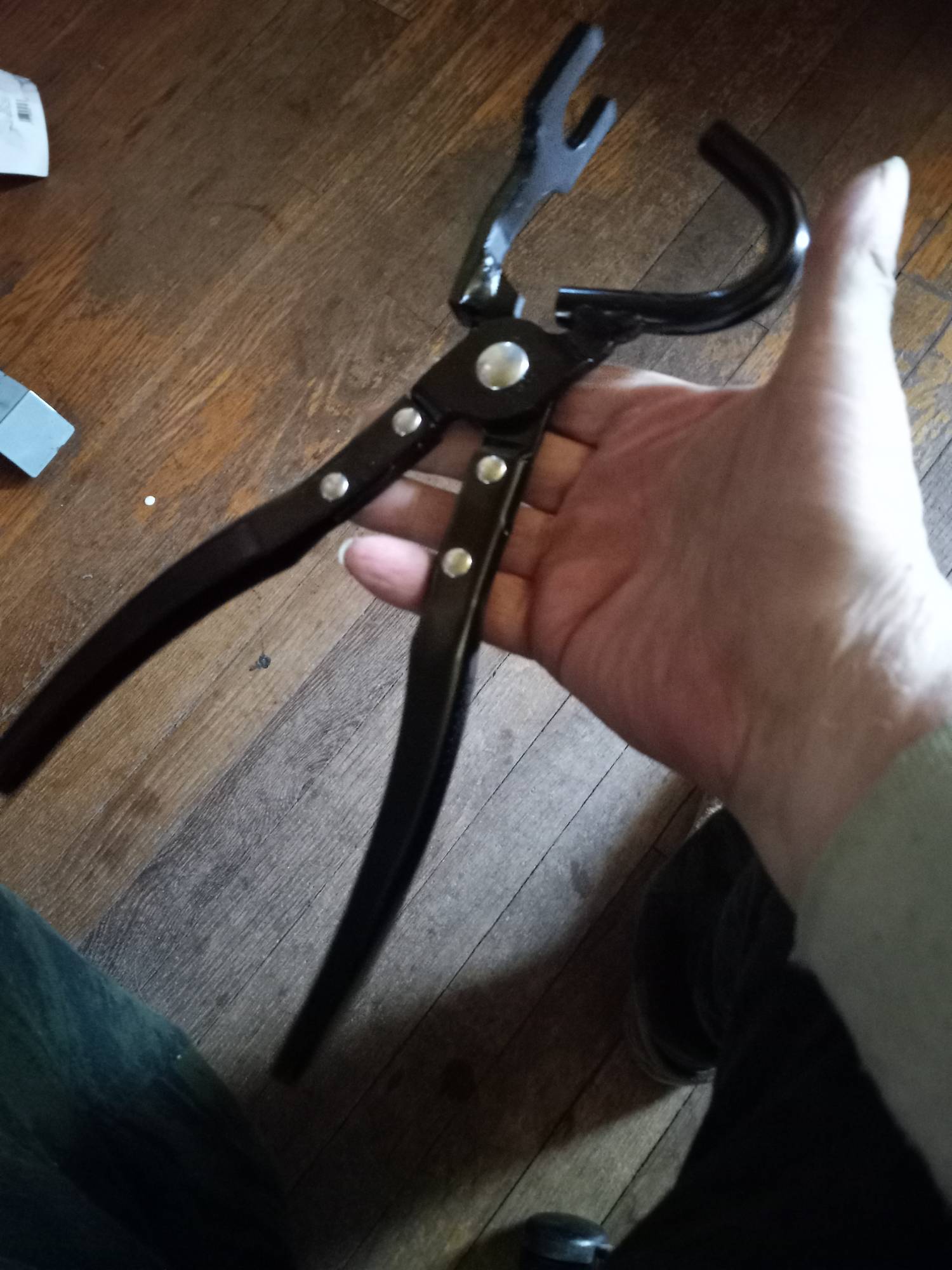

Lisle 38350 Exhaust Hanger Removal Pliers makes removal a breeze.

vtl wrote: 21 Apr 2023, 08:44 Lisle 38350 Exhaust Hanger Removal Pliers makes removal a breeze.
Just ordered them, $18.50 amazon, I have a bunch of exh work to do soon.
I've always been happy with Lisle quality.

being a tool junky I couldn't resist.

no, no, no. not those things. I am talking about basic grommets. I put in McMaster high (higher than amazon) durometer 3/4 x 7/8 inch grommets. The factory ones MIGHT have had one flange side a bit larger than the other, but they were not oil resistant and some were very soft cut. There are 4 grommetted holes on each the exhaust support at the front of cat and the center dive shaft support. I had them off so I wanted new.....

jonesg wrote: 29 Apr 2023, 08:00 being a tool junky I couldn't resist.
That’s an awesome tool and every time I use it, my hands thank me
