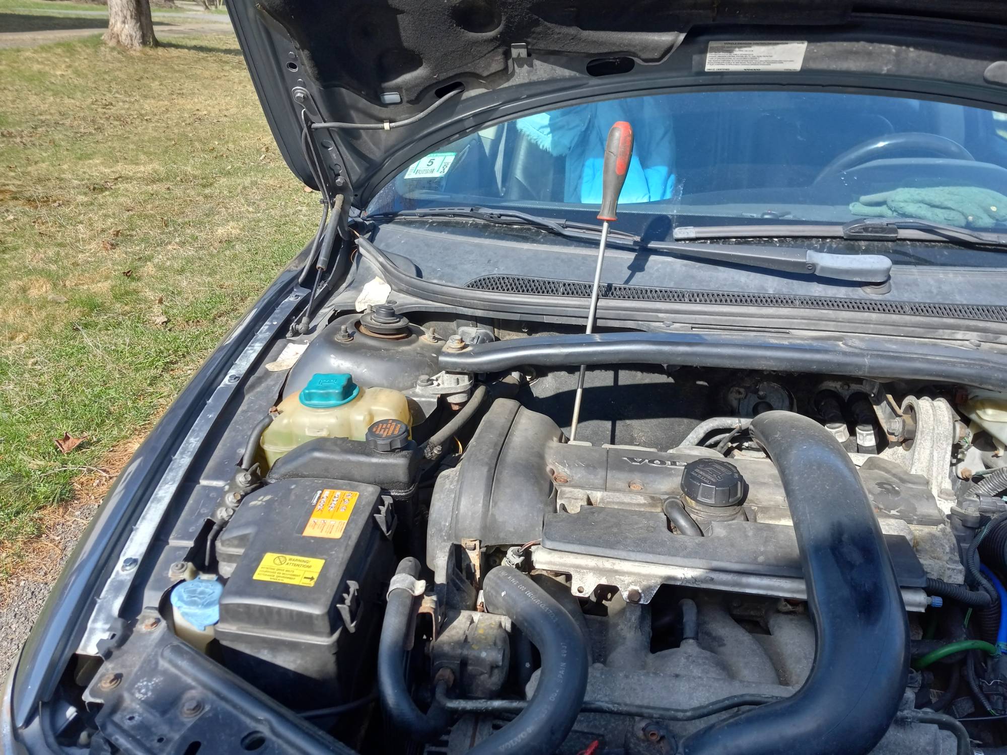

The engine number is stamped on the block on the RIGHT side of the engine, perspective from drivers seat, not standing in front of the car.
went through this 2 years ago, I could only see half the number, stuck my phone in there and took some pics, went back with a toothbrush and brake cleaner to clean it up and got better pics, the stamping is dot matrix style , like a 1980's computer printer.
Follow the long screwdriver for approx location, I couldn't photo it due to sun glare , a garage out of direct sun and a drop light would help.
