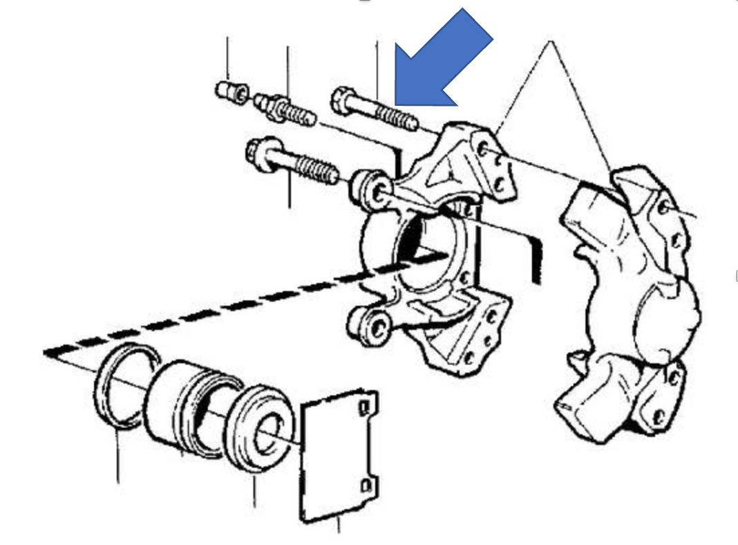

The bolts in question are these:
I have found some older parts diagrams that list a number for those bolts but the sites don't list them for order (and don't show a volvo part number).

Din 931 partial thread m7 45 8.8 bolt…snap, ping , Belmetrics….
https://belmetric.com/m7x1-0-coarse-din ... BR7X45PCLZ
These bolts have to both hold the caliper halves together to seal, and also withstand 2x brake pressure over the pistons, every time you brake you are trying to stretch these with about 500 psi pressure.
Grade 8..8 is 8 MPa tensile strength or about 1200 psi, so 4 of them are safe up to 1000 psi working pressure , factor of 4x below tensile strength.
That’s a pre coffee calculation
Torque? I would use 20 Nm or 15 foot lbs

I watched a video rebuilding similar vintage Porche calipers (also made by ATE I think . very similar design) and the person in the video quoted a final torque of 17 ft lbs. So your pre-coffee calculation was darn close
Thanks for the link. I can't tell you how many sites I visited and failed. (or were now dead sites).
