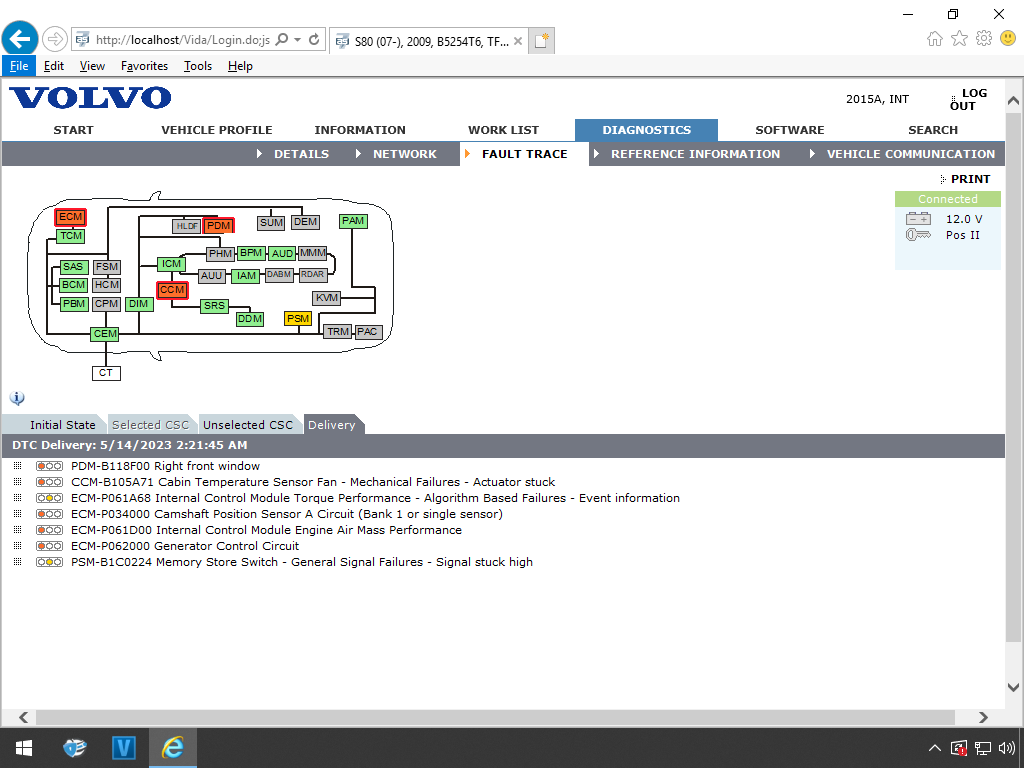

Attached a scan by Vida.

Post by Krons »
Codes come back if you clear them? Best guess I would have is camshaft sensor but just a guess.
