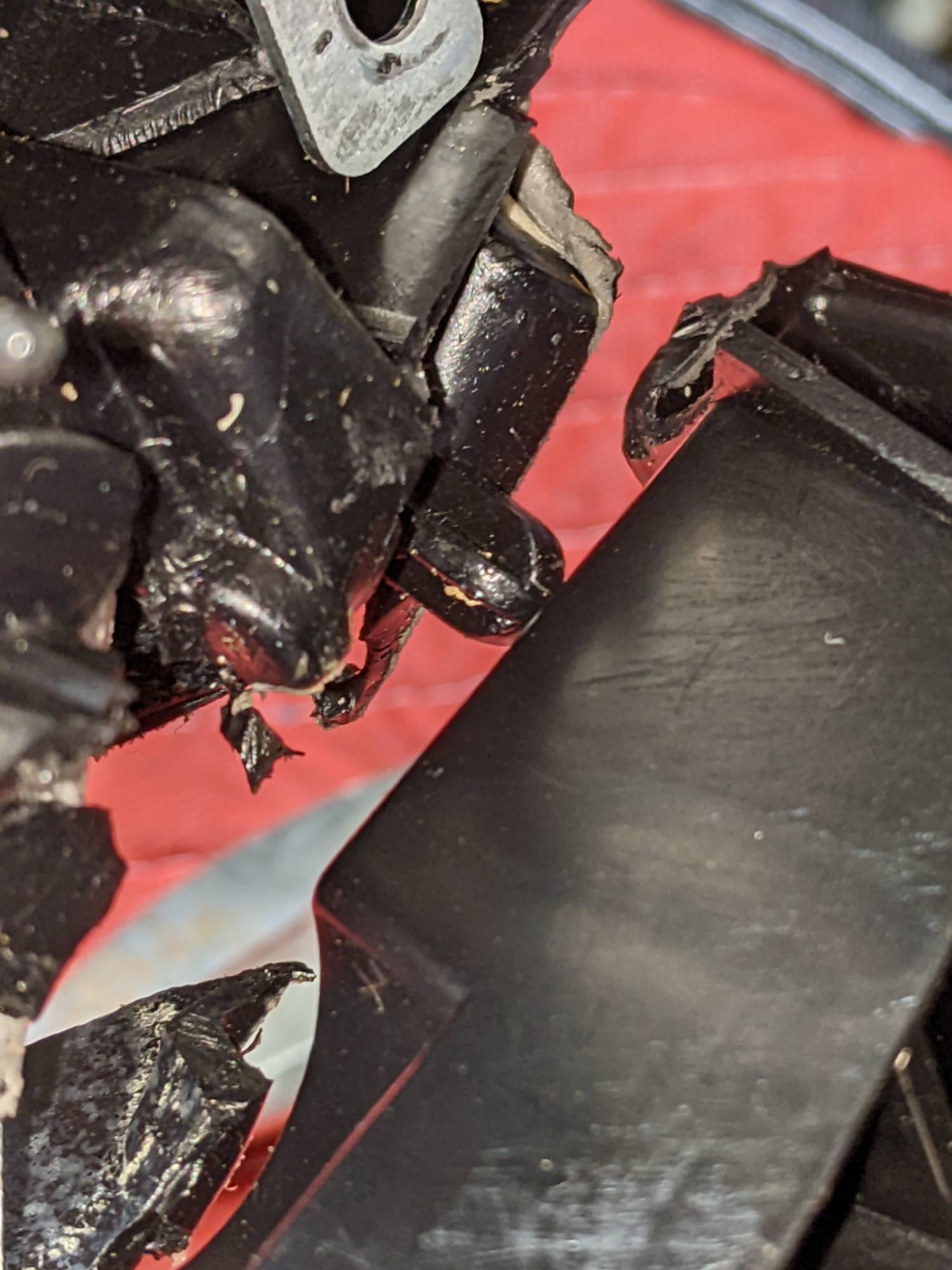

What I found was one broken mount, and one cracked mount (to be expected), but also a whole hose of other damage. The whole RH side panel is broken away from the main part of the dash, which is possibly the reason the corner of the glove box broke.
RH dash side broken (1)

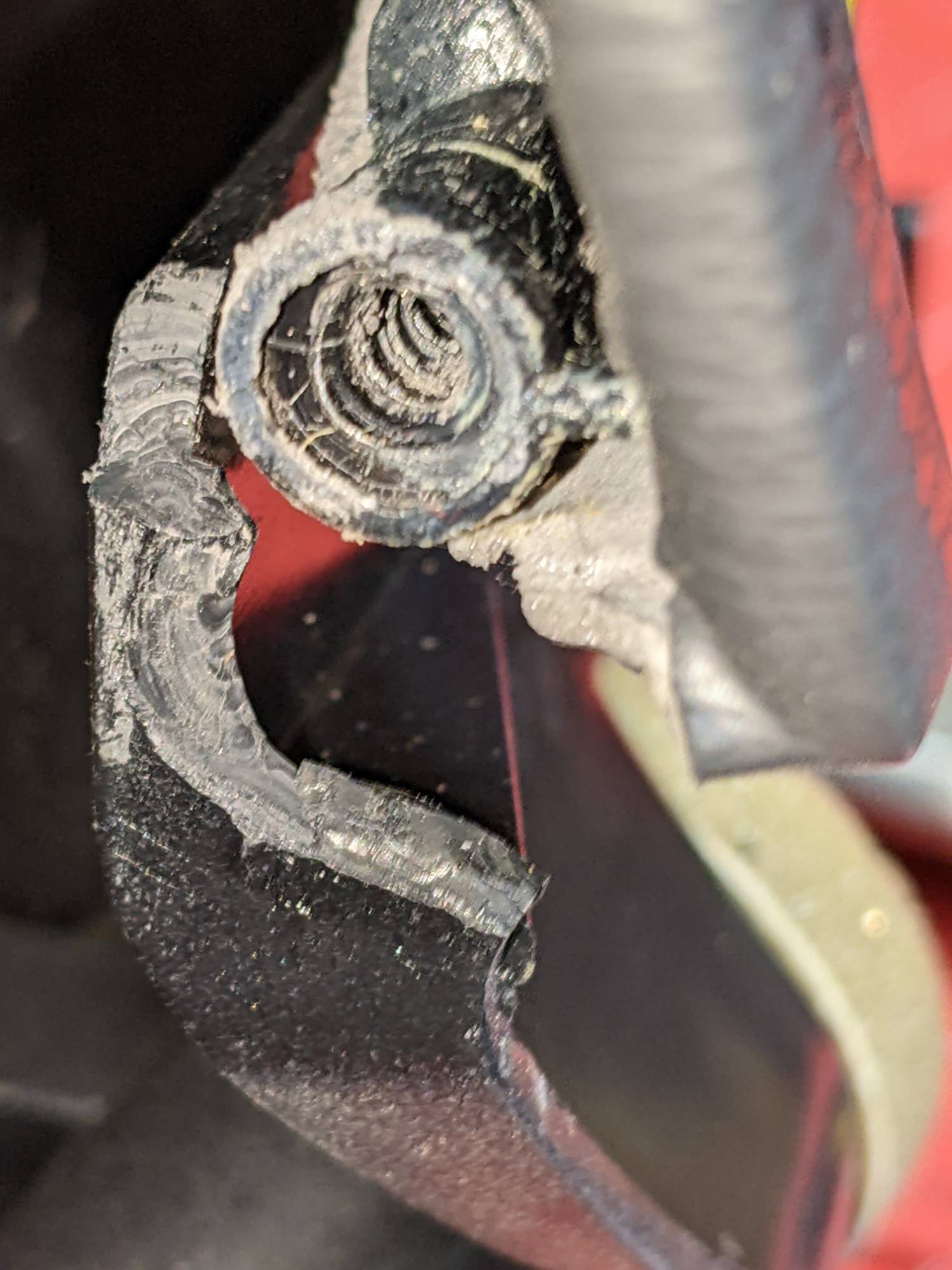

Picture above the the upper RH corner of the glove box slot looked at upside down. The metal piece is a bracket I fitted to hold the corner together until I had time to fix the dash

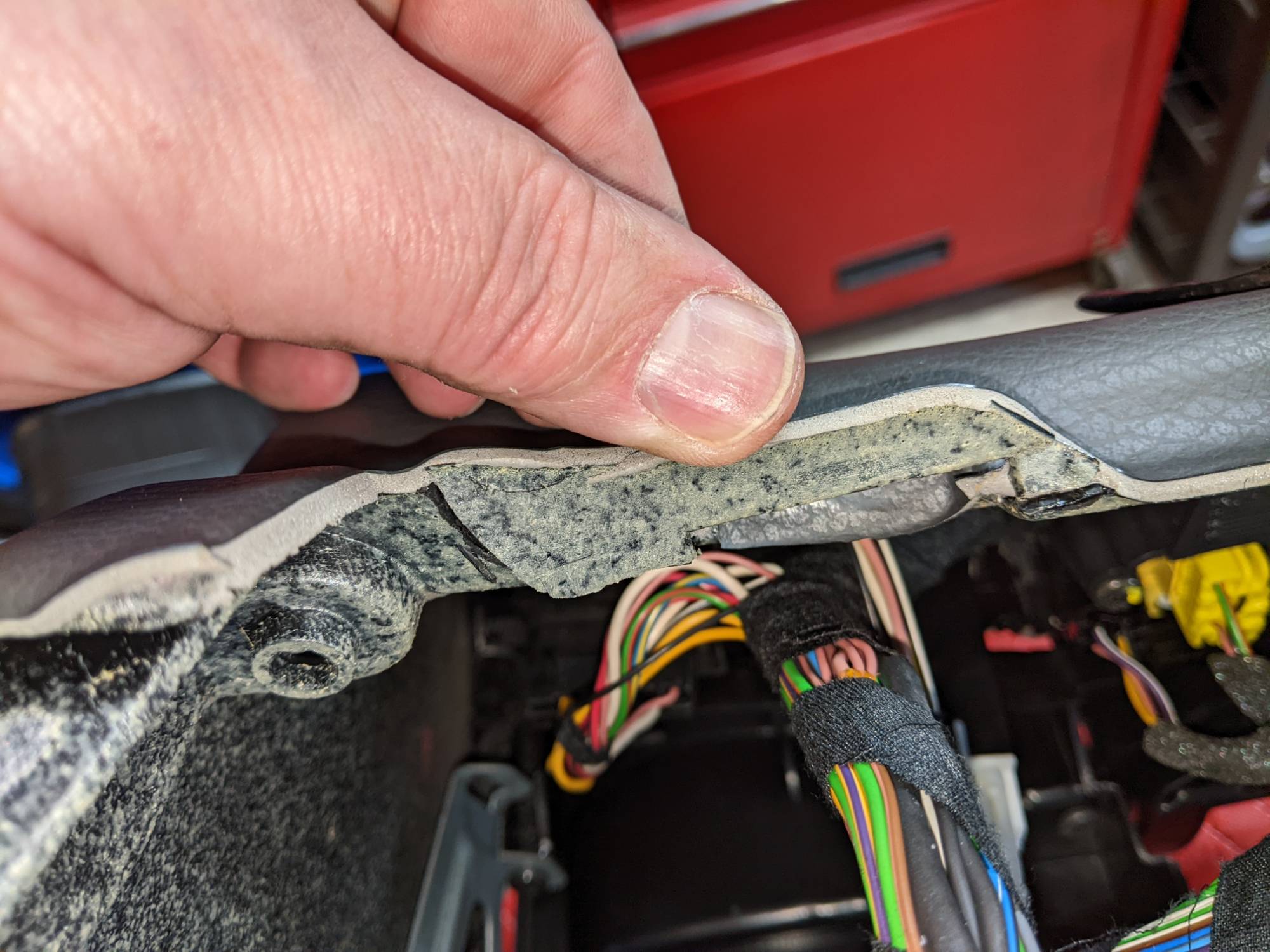

This is the RH side mount for the metal reinforcing plate broken off both at the top front and rear mount.

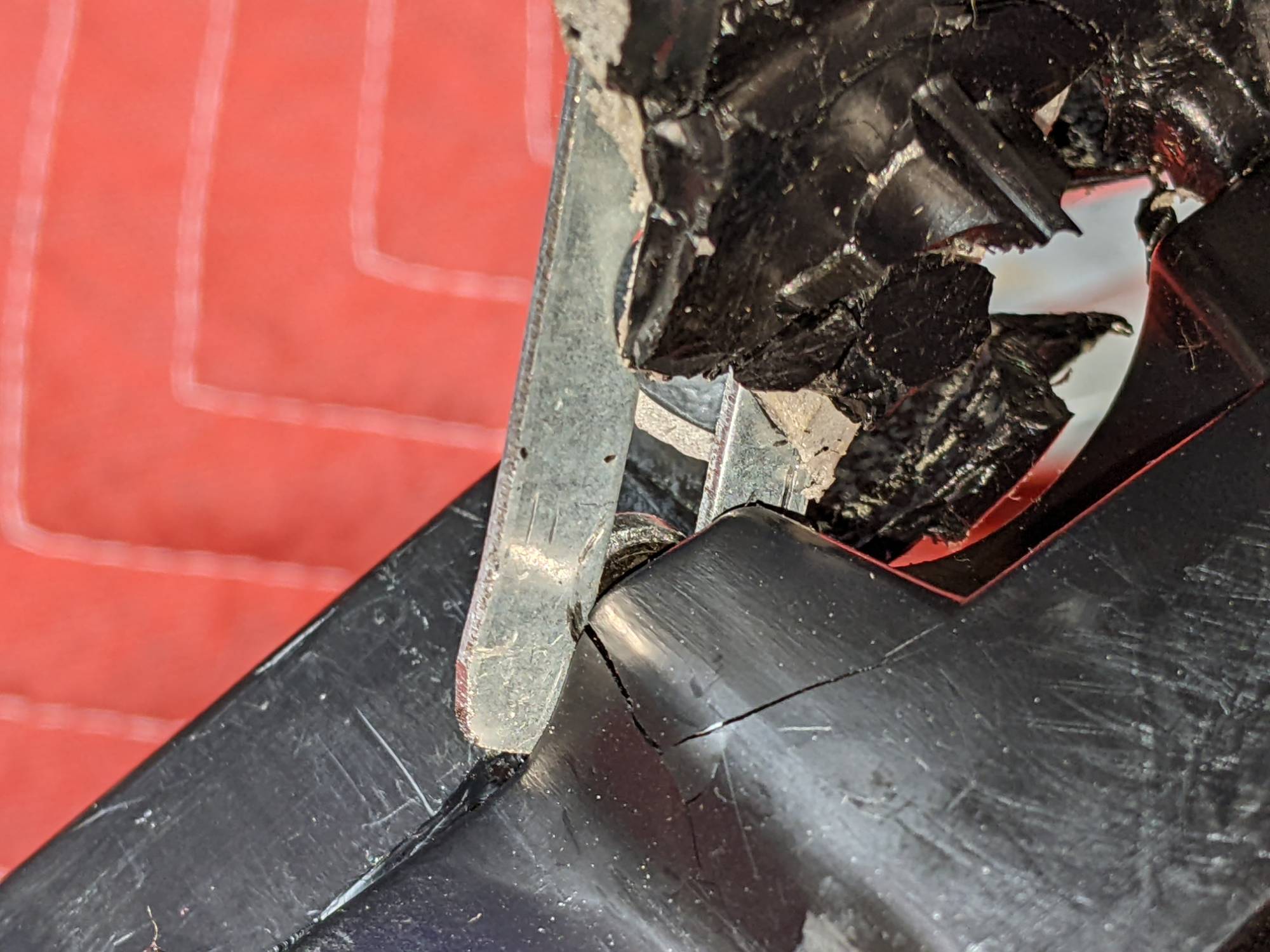

This is the top RH corner of the dash fully broken apart!!

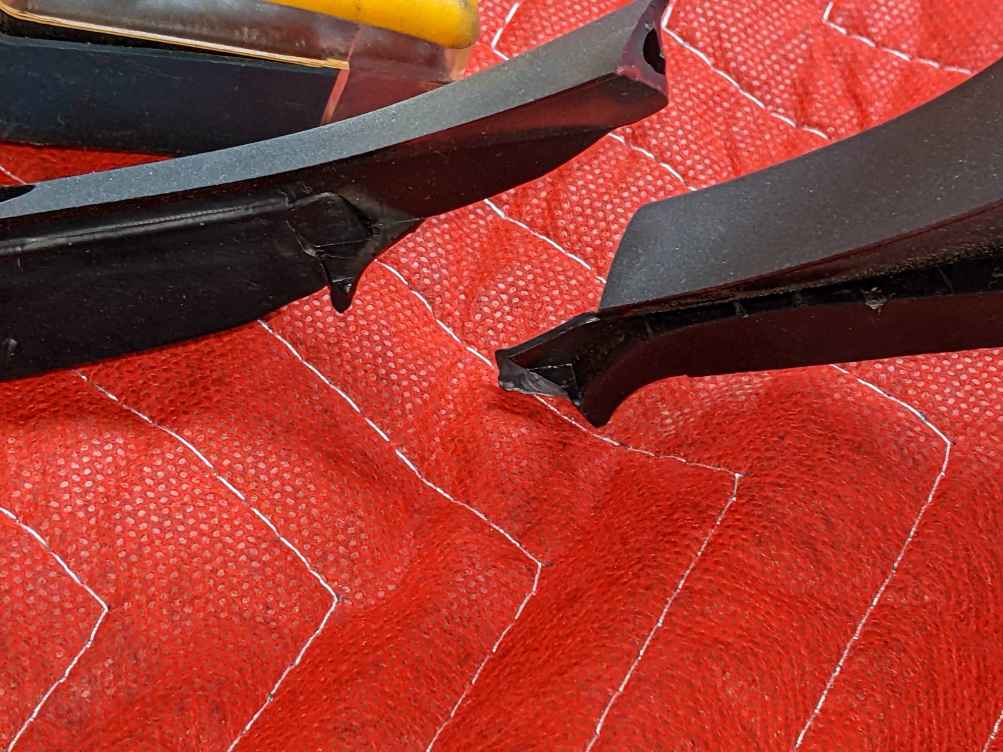

One the LH side of the dash the lower ring below the steering column is broken is several parts including the mounting slots for the under dash panel.

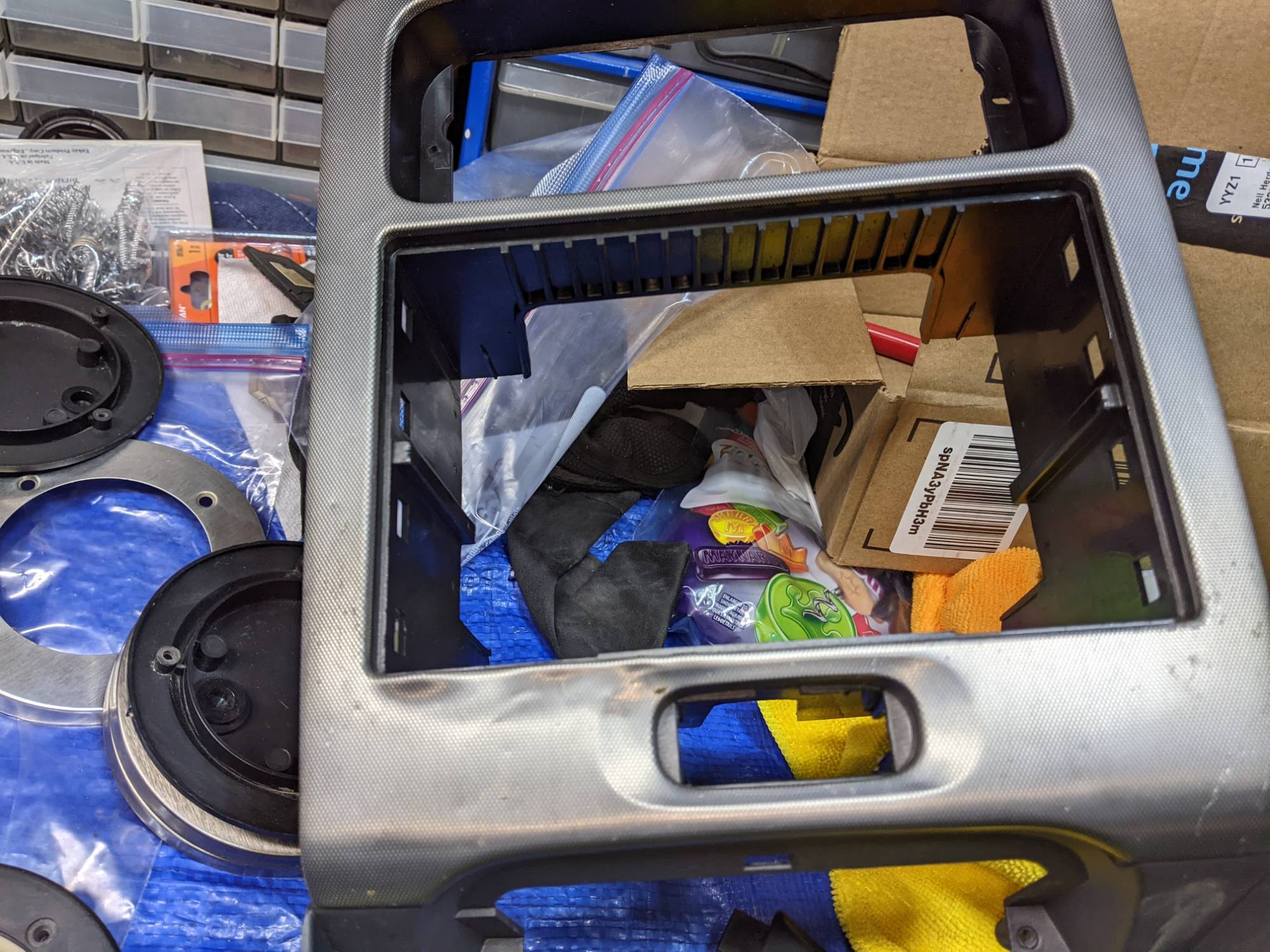

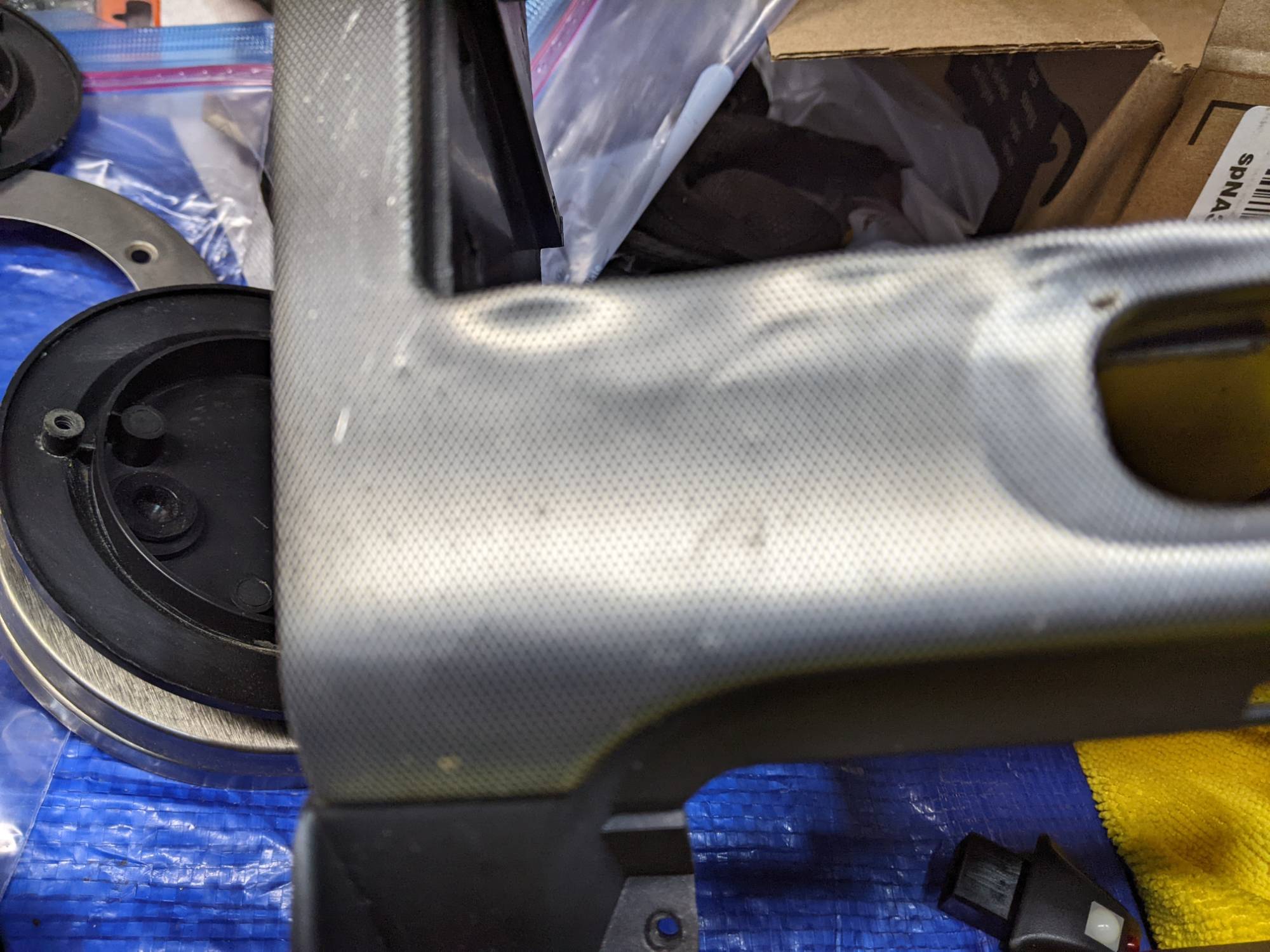

I fought the center dash section to remove it to swap it over tot the back up dash unit, but to be honest it looks like crap and always has done. It is covered with a thin piece of machine turned/carbon effect metal which is easily dented, especially when removing the radio head unit as is catches on the radio lower edge. It was dented when I bought the car 10 years ago, and now looks even worse. To be honest I never like the finish so I am thinking of not fitting it and leaving the standard black/gray center section which is in good condition.
R dash center column for radio and ECC
Dents in center dash covering
I like to keep my cars as close to standard when possible but this is one part I can seriously do without. I will keep the original and leave the standard part fitted to the replacement dash.
