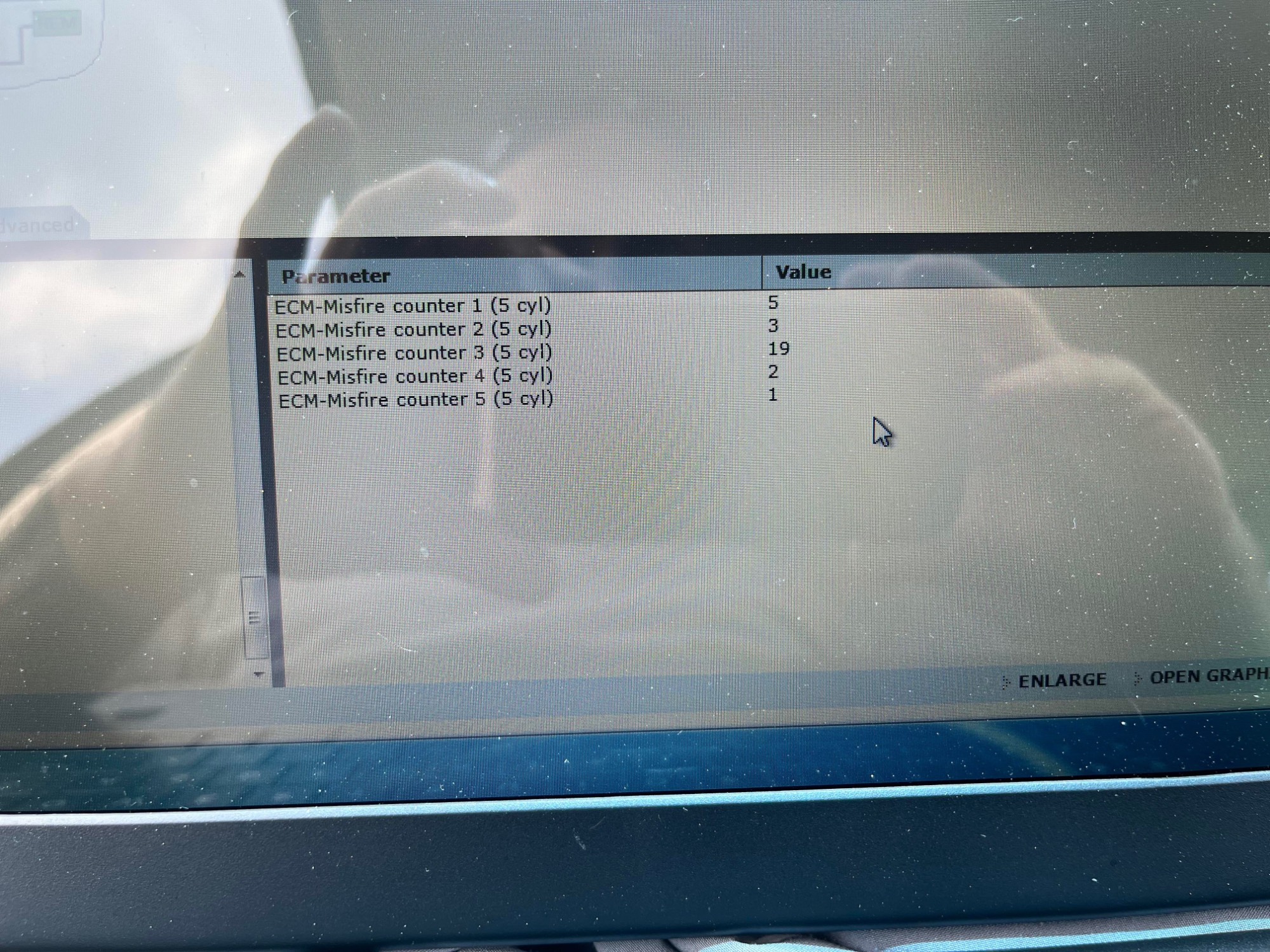

Now to the present moment. I’ve been driving the car for the last ~2000 miles. It still had a slight stutter when idling and driving around 45mph. After scratching my head and looking at different parameters in VIDA I found multiple misfires and mostly on cylinder three. Screen shot attached. Also the number of misfires in the screenshot is over a five minute period of time.
Note: Fuel pressure has been checked with a gauge on fuel rail. Live pressure and leak down pressure is reading within spec. Initial key turn is 60psi and after 30 seconds of running it comes down to 43-44psi.
Swapped coils around and nothing changed. I’m going to do a compression test. If it tests fine I’m leaning towards injectors or vacuum leak since it’s affecting all cylinders. So far I’ve discovered no vacuum leaks which is what I checked initially when servicing PCV.

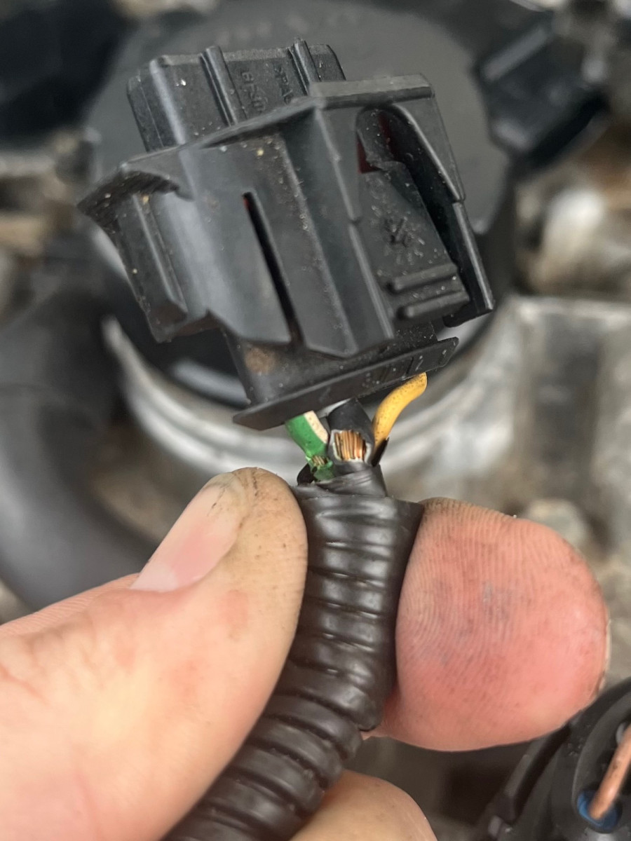

!!Update!! :: Now that it’s daylight… I proceeded to do the compression test and all cylinders were almost perfectly equal. Within 2psi of each other. However I found the issue with the misfire. I pulled back some of the insulated tubing on the wire harness for the COPs and VVT solenoids. There were cracks in the colored wire insulators and some of them were rubbing against each other. Had I not actually removed the tubing I wouldn’t have caught this issue. Now to get all the items to repair. I’ll update when repair is complete to see if that gets rid of the misfiring.
