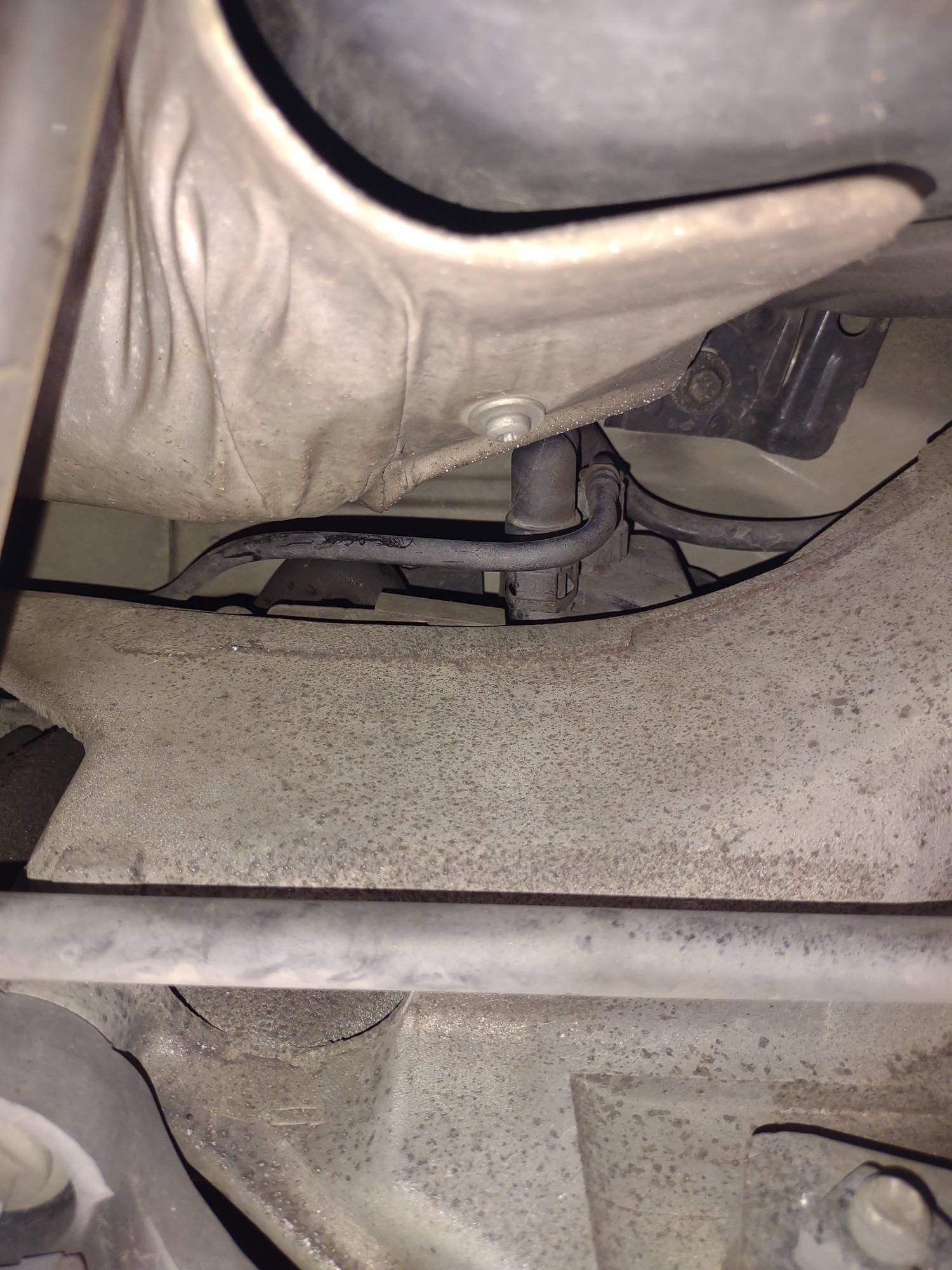

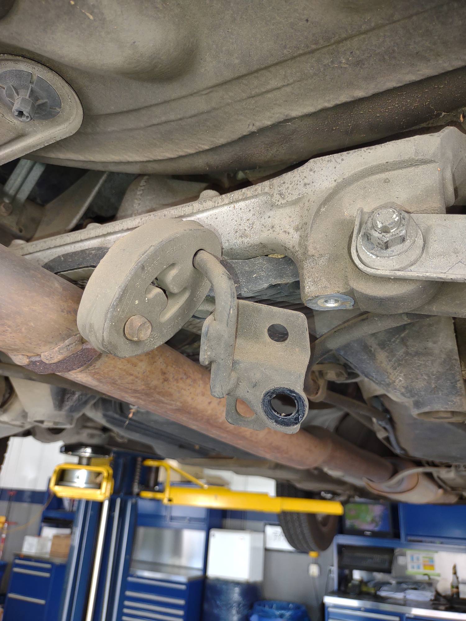

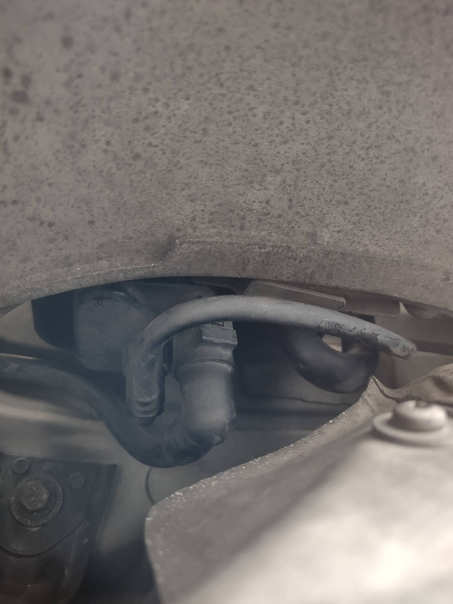

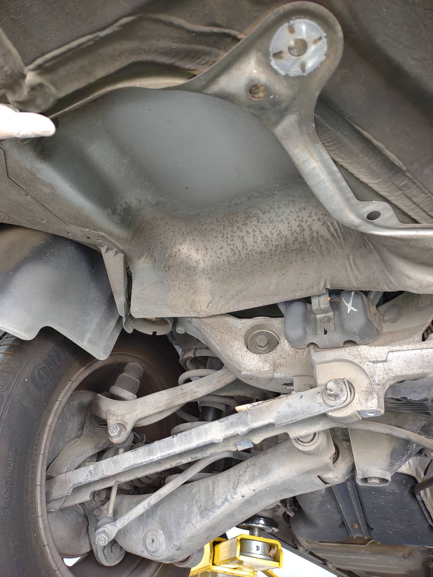

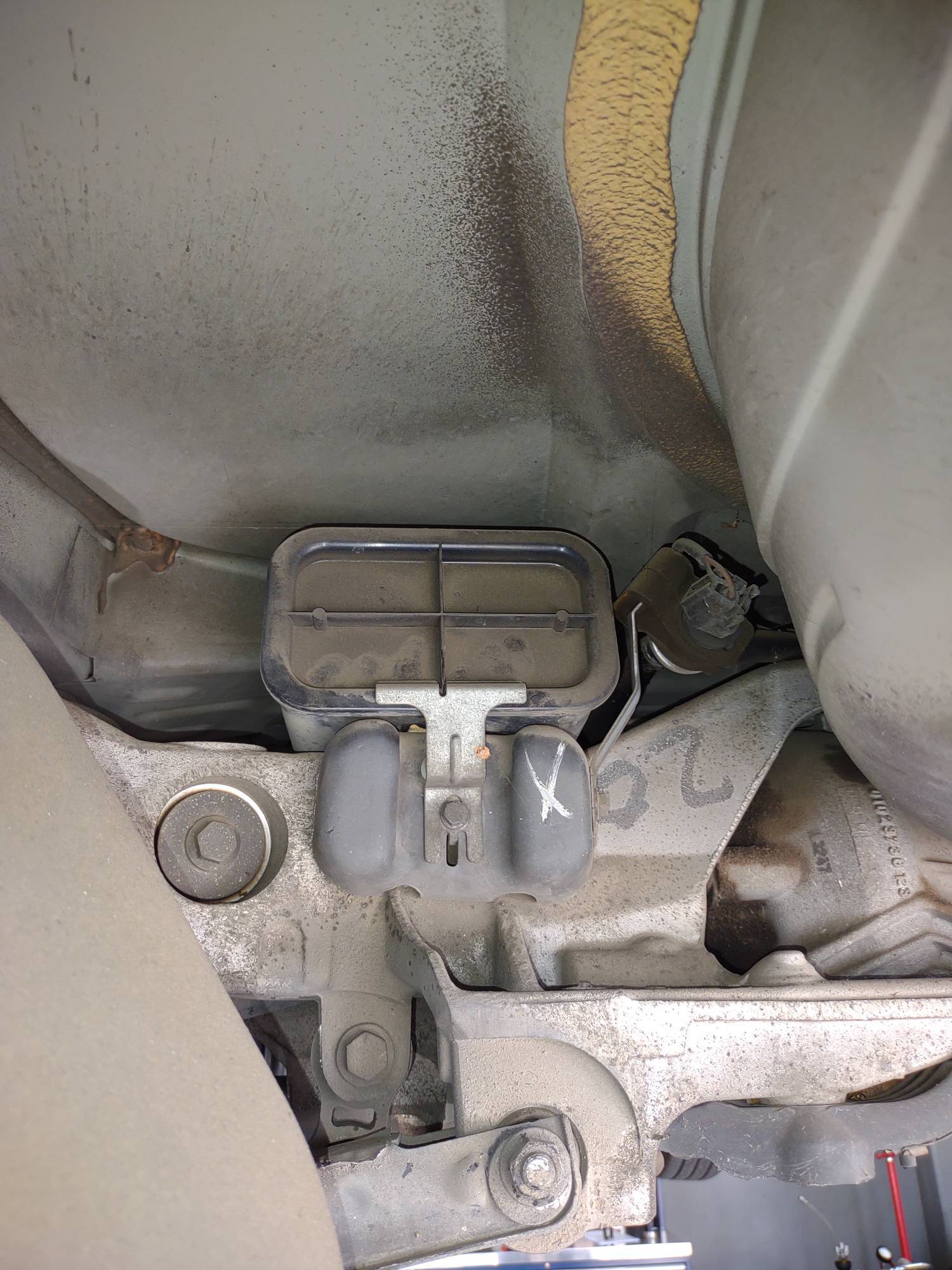

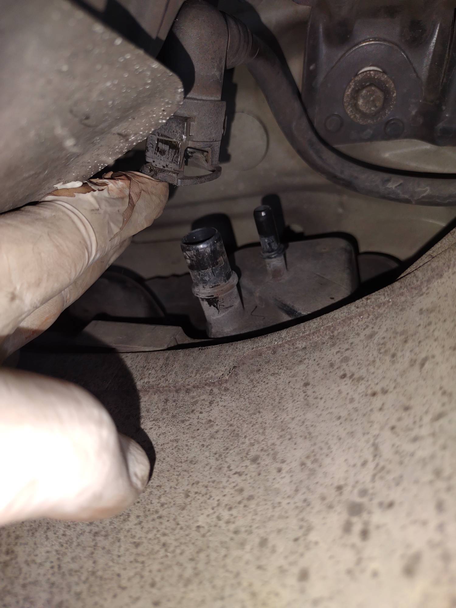

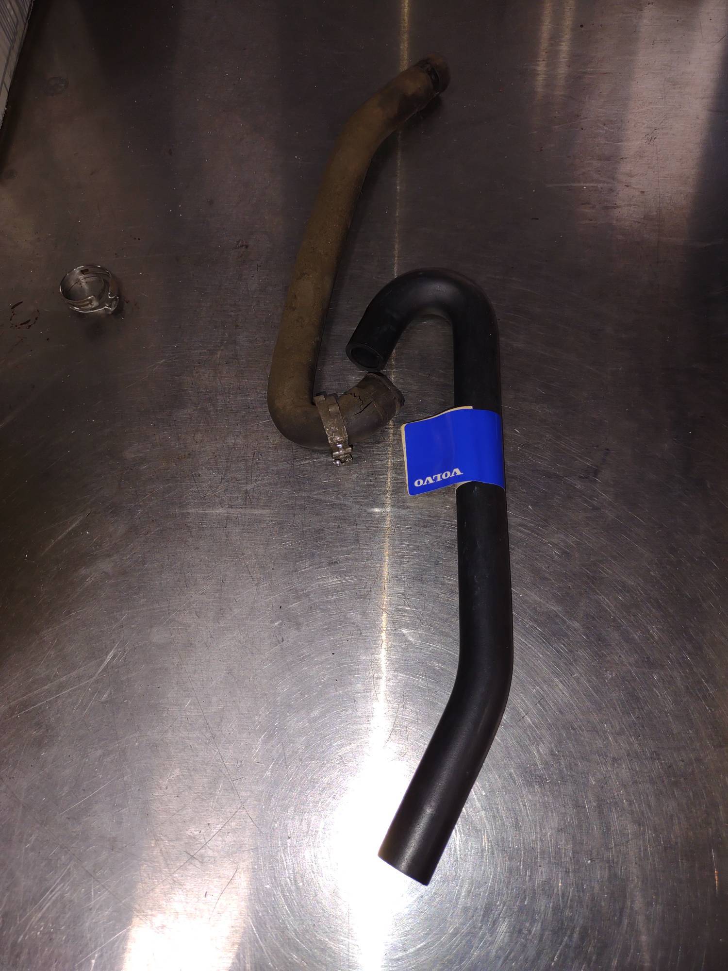

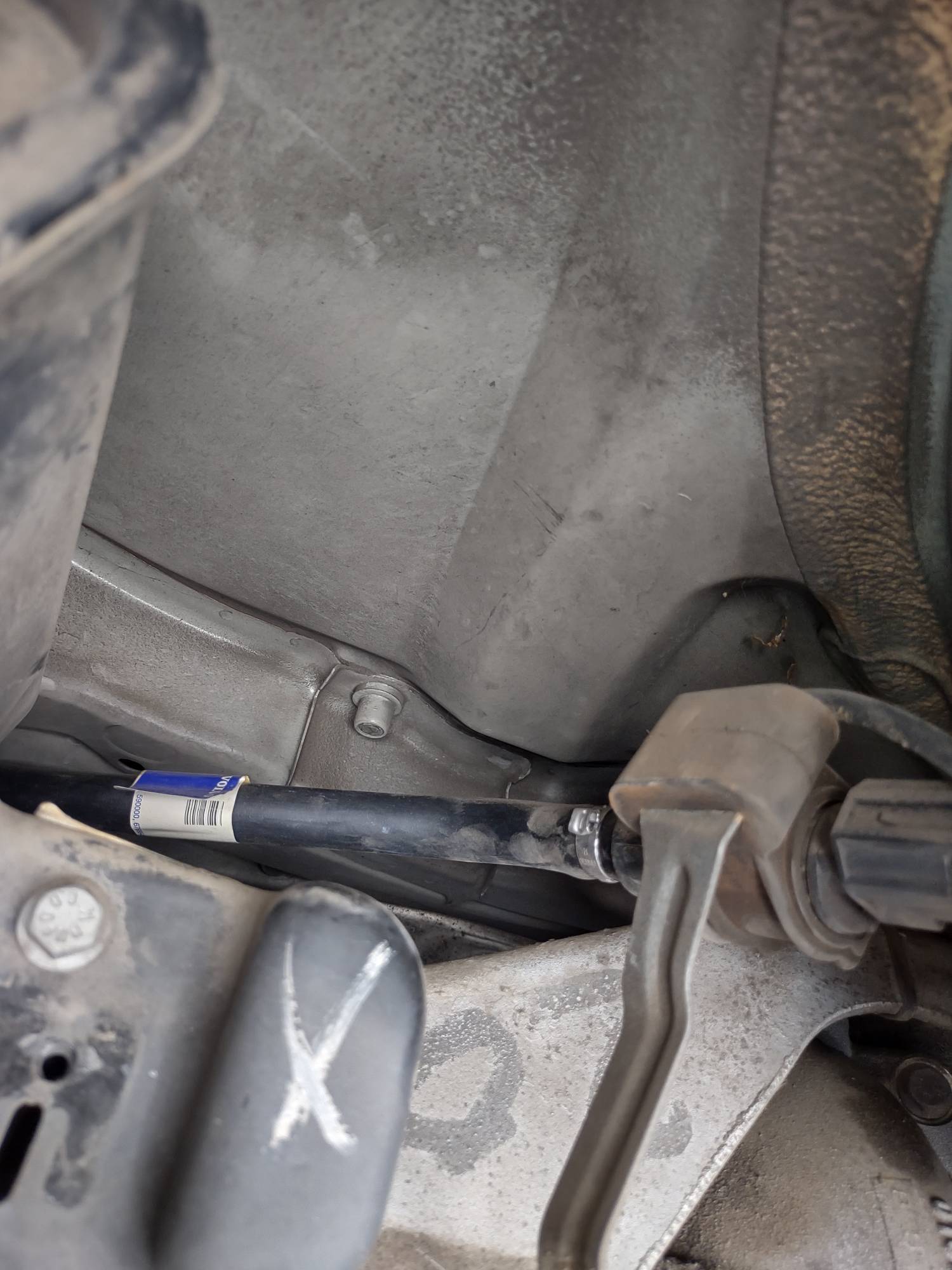

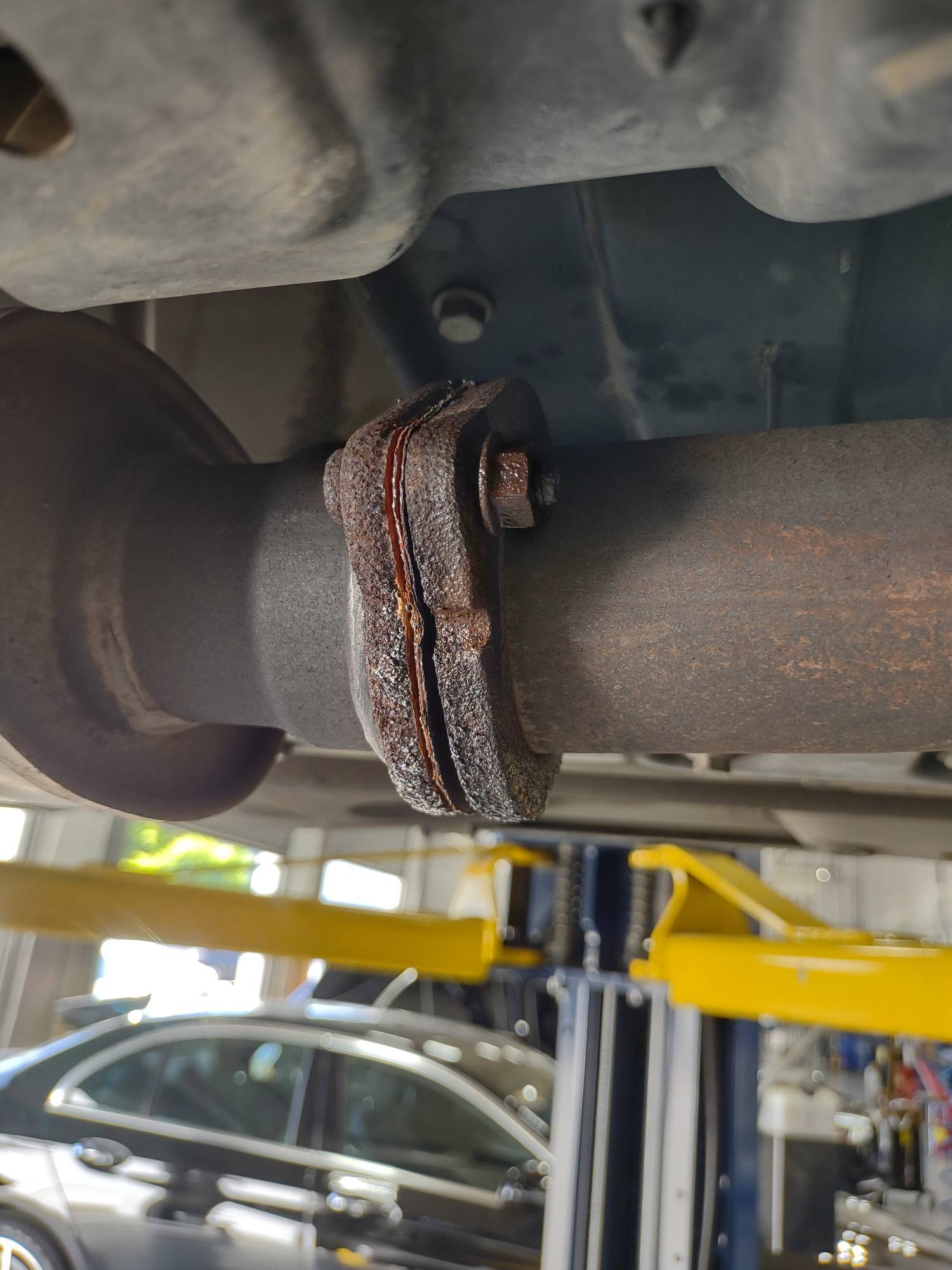

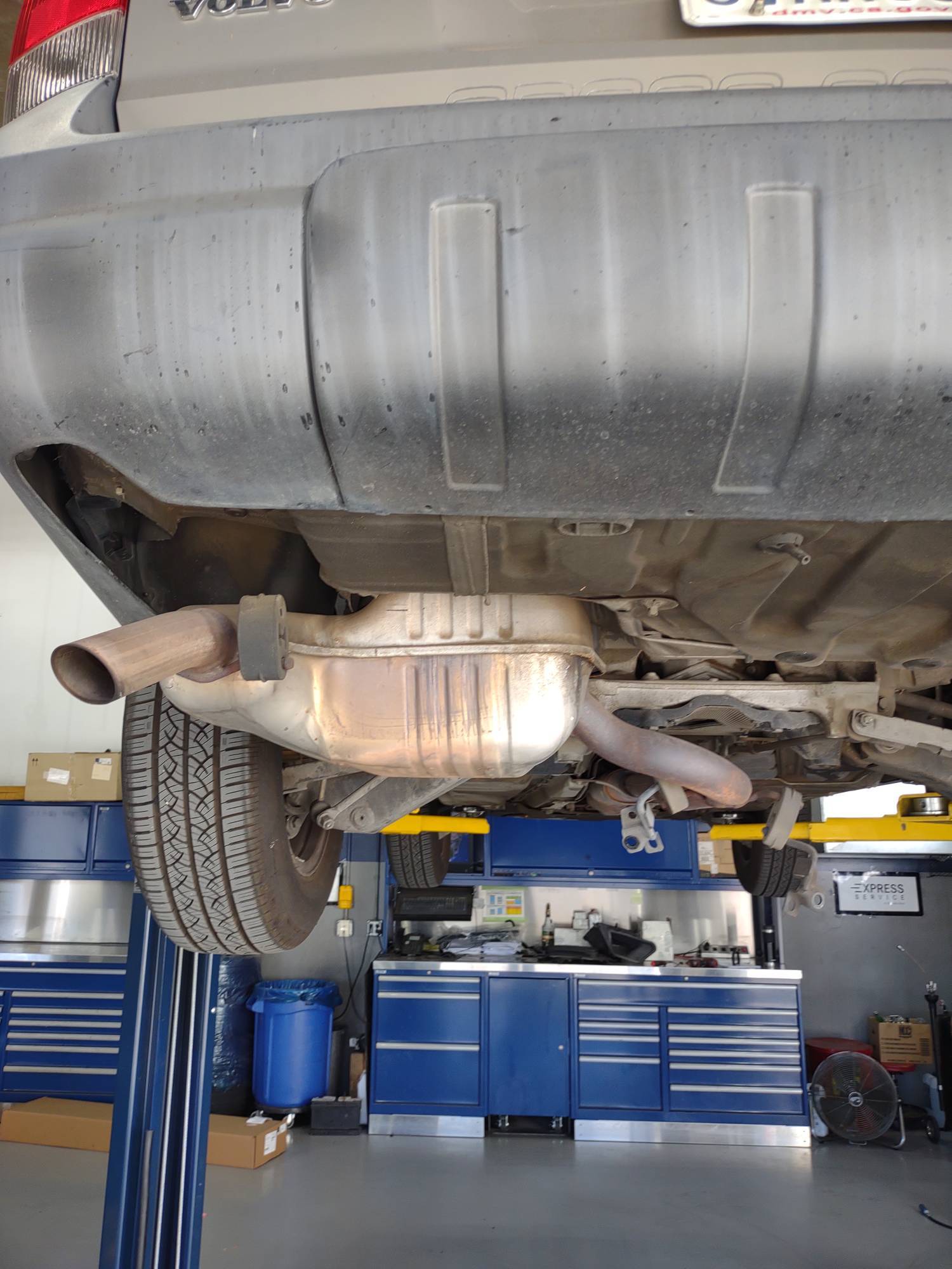

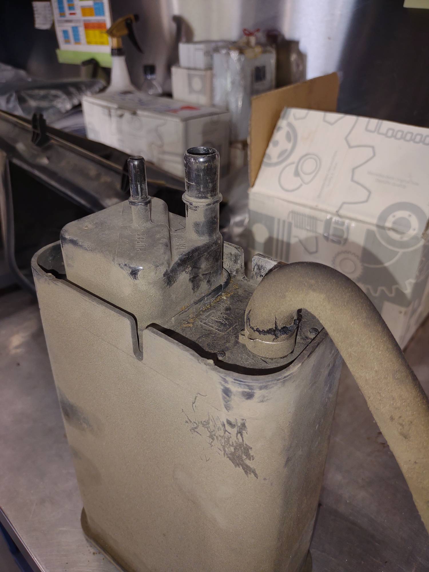

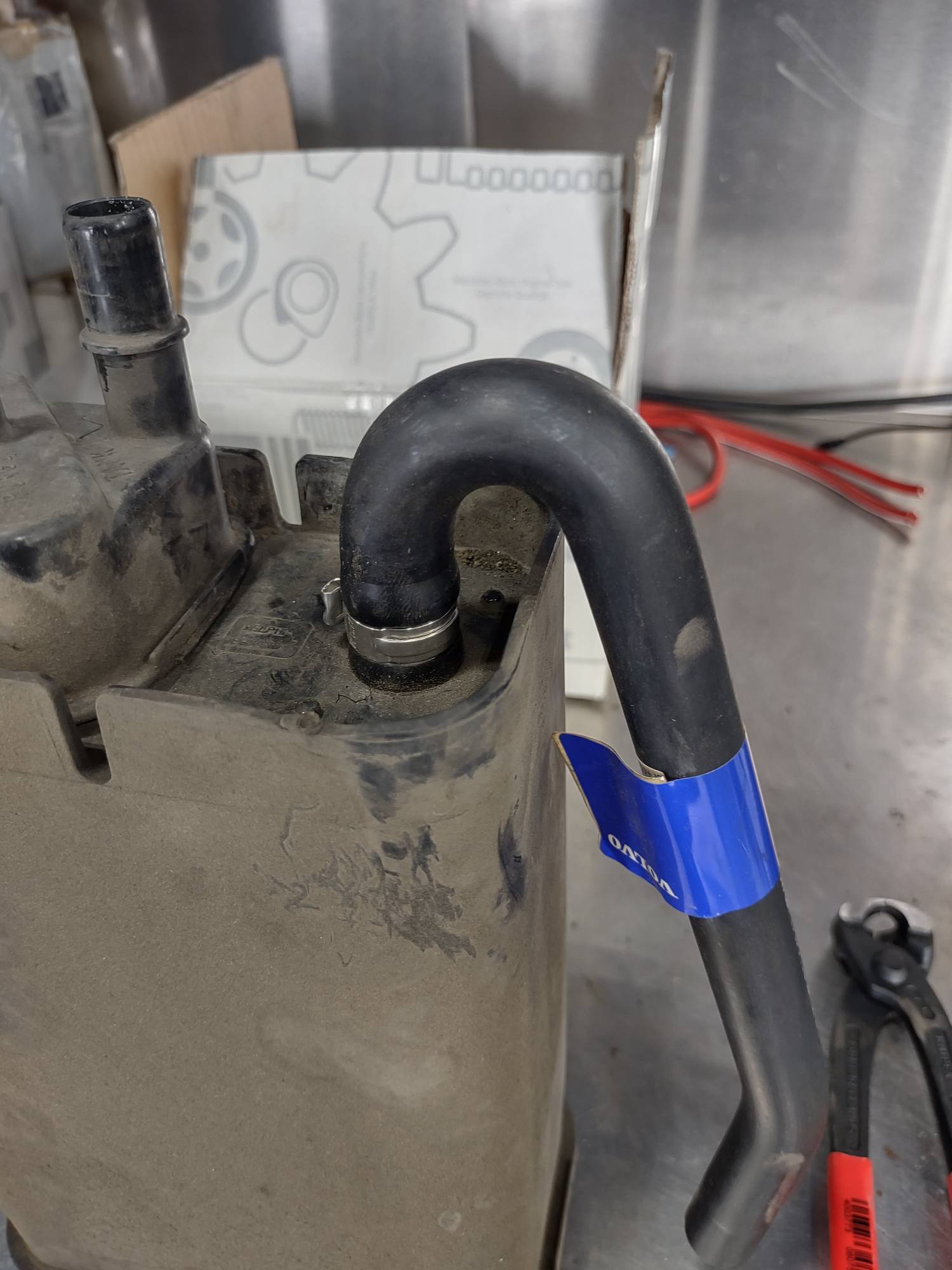

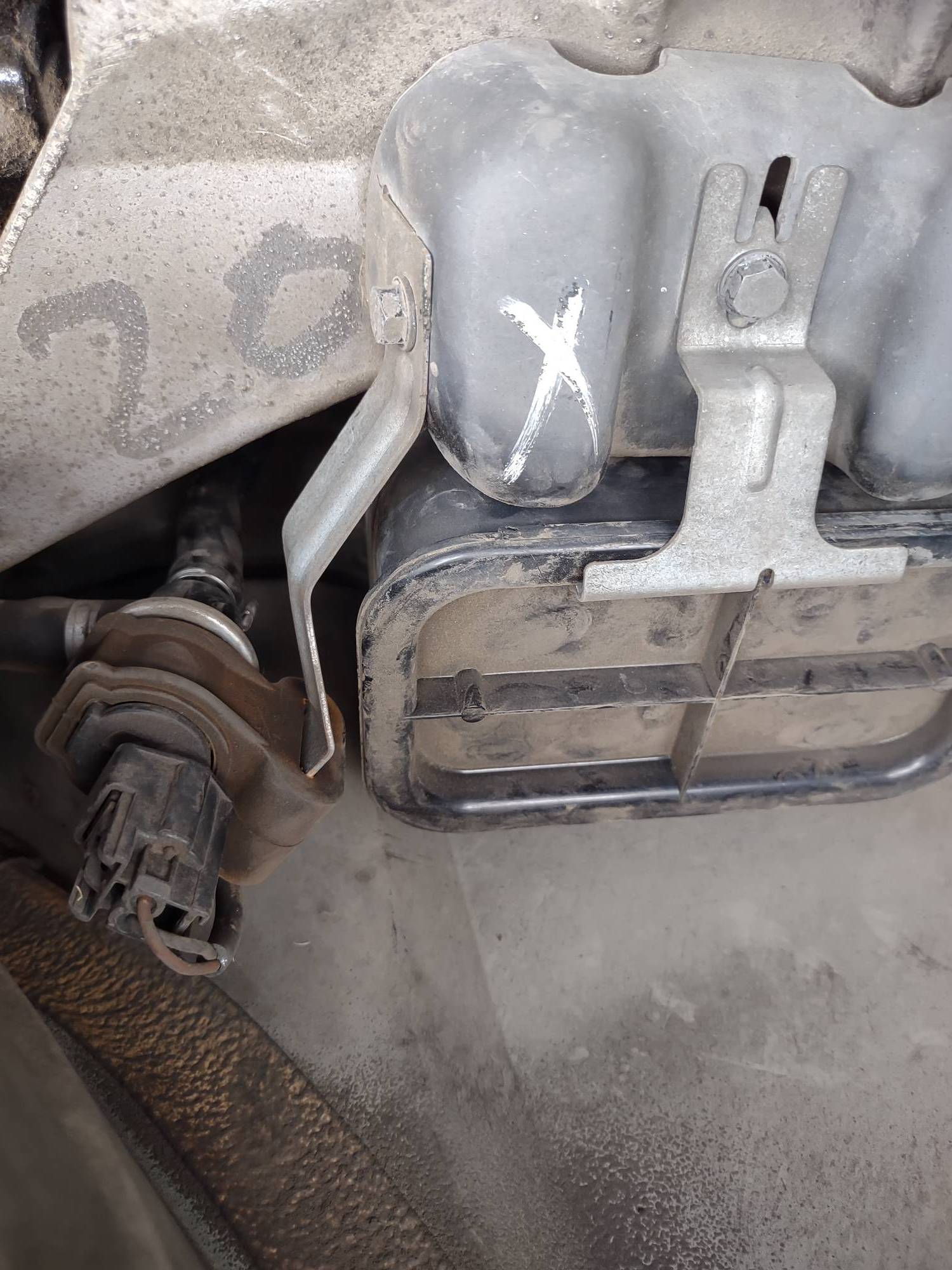

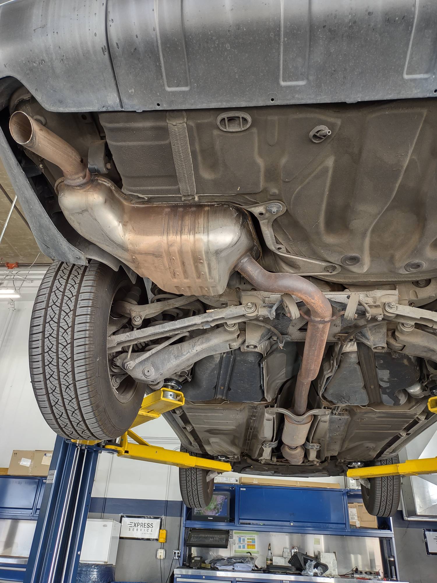

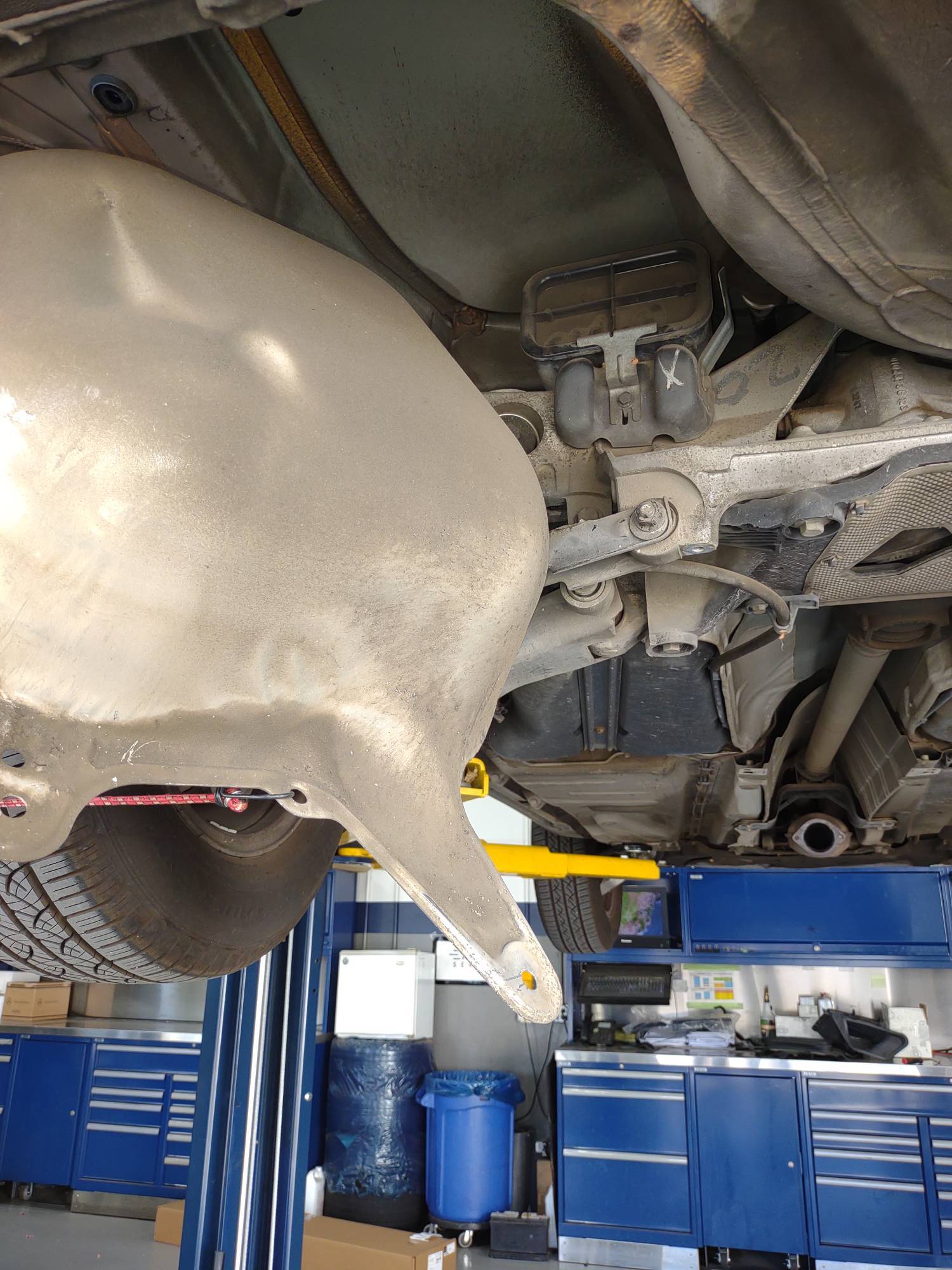

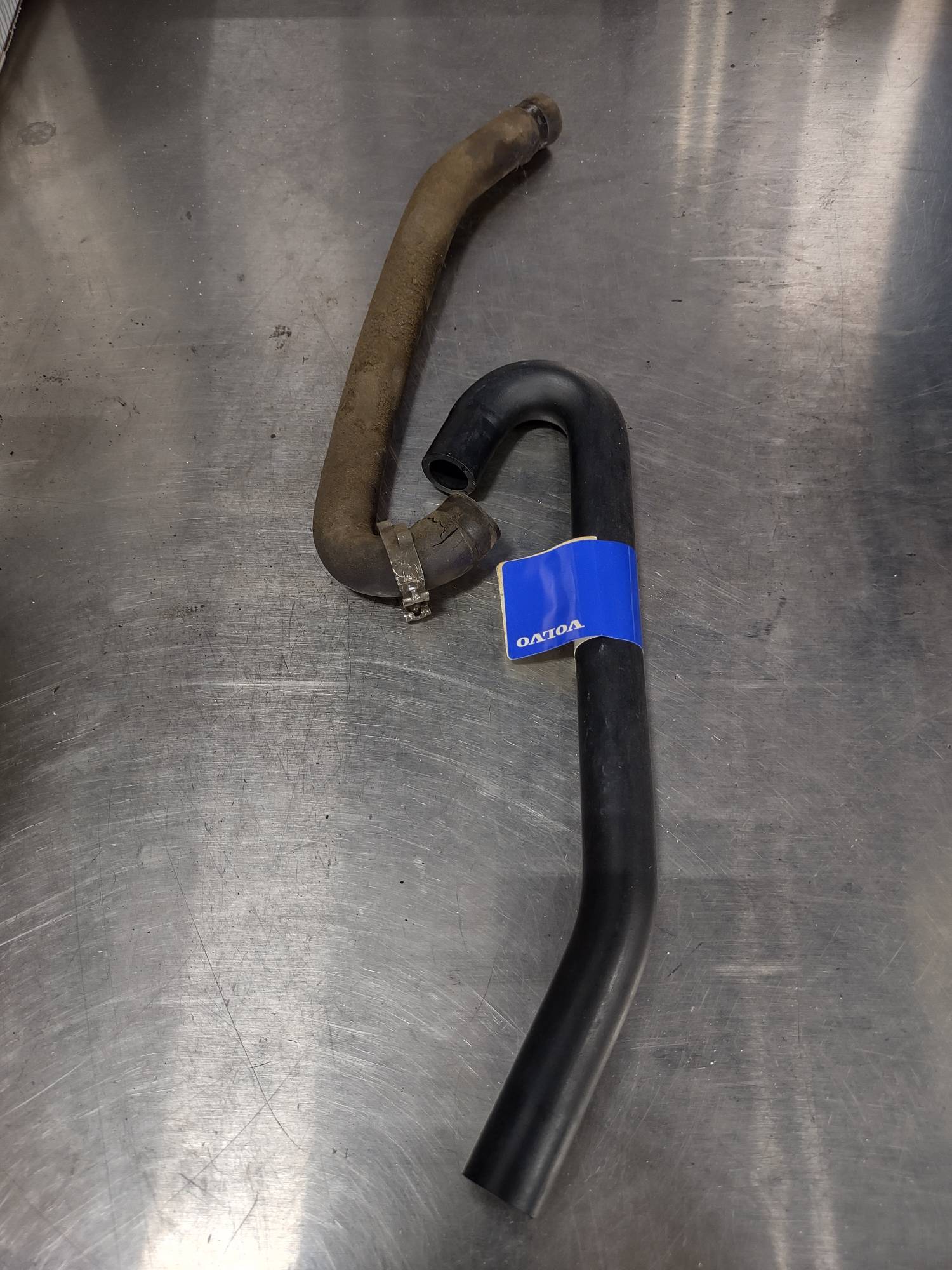

ON A PREVIOUS POST, I SAW HOW A USER BUTCHERED HIS CAR IN ORDER TO GET TO THE J HOSE THAT OFTEN CRACKS AND CAUSES EVAP LEAKS/ CHECK ENGINE LIGHT TO TURN ON.
HERE ARE THE STEPS THAT NEED TO BE TAKEN IN ORDER TO REPLACE THE HOSE WITHOUT CUTTING HOLES IN YOUR FLOOR PAN.
I STILL CAN'T BELIVE THAT HE ACTUALLY POSTED THOSE PICTURES... BUT HEY THERE IS A WRONG WAY, AND A RIGHT WAY TO DO ANYTHING...
HERE ARE THE PICTURES FOR REFERANCE IF YOU WANT TO ACTUALLY DO THE JOB RIGHT AND IN LESS THEN AN HOUR OR 2.
WITHOUT A DREMEL OR A TORCH!
YOU SIMPLY HAVE TO TAKE DOWN THE REAR SECTION OF THE EXUAST, REMOVE THE CHARCOAL CANISTER, REPLACE THE HOSE AND REINSTALL IT. LIKE A NORMAL HUMAN BEING...

On second scroll through photos: canister really just magically slides out towards you? I find it hard to believe the rear access of that assembly is that easy.
