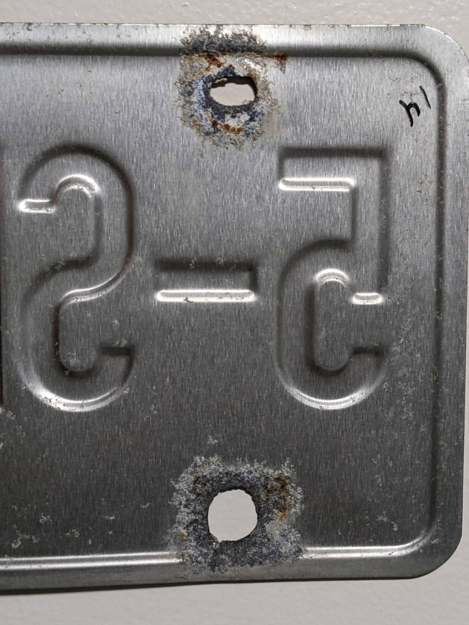

How do you prevent rust on the holes in your license plate? My plates appear to be aluminum (non-magnetic, white corrosion) while my OEM license plate bracket and nuts are likely steel. Could that be causing dissimilar metal corrosion? I will likely get new brackets, stainless nuts, and rubber washers for both sides of the plate holes. But is it safe to use stainless nuts on regular steel bracket studs?
I want to repair the aluminum on my plates. What's a good adhesive to bond a new piece of sheet metal to the back side?

Galvanic corrosion caused by the different chemistry of the aluminium and steel bolts, aluminium being the softer it will oxidise quickest. I use 3M sticky tape for my plates to prevent this happening

Nylon washer from Lowe Quality and the m6 SS cap nuts from Belmetrics . Nasty corrosion, probably salt induced

Cleaning vinegar should treat the damage. Maybe hit it with clear coat after, and a washer under the nut ?
The cap nuts that came with the blue-box bracket I put on one of mine years ago have held up pretty well, but another source for stainless is

Cap nuts from Volvo have always rusted for me. I use stainless m6 cap nuts and stainless m6 washers. Bought 100 of each many years ago from McMaster-Carr e.g. https://www.mcmaster.com/products/cap-n ... ess-steel/. Each car in the fleet has 8 of each, no corrosion.
