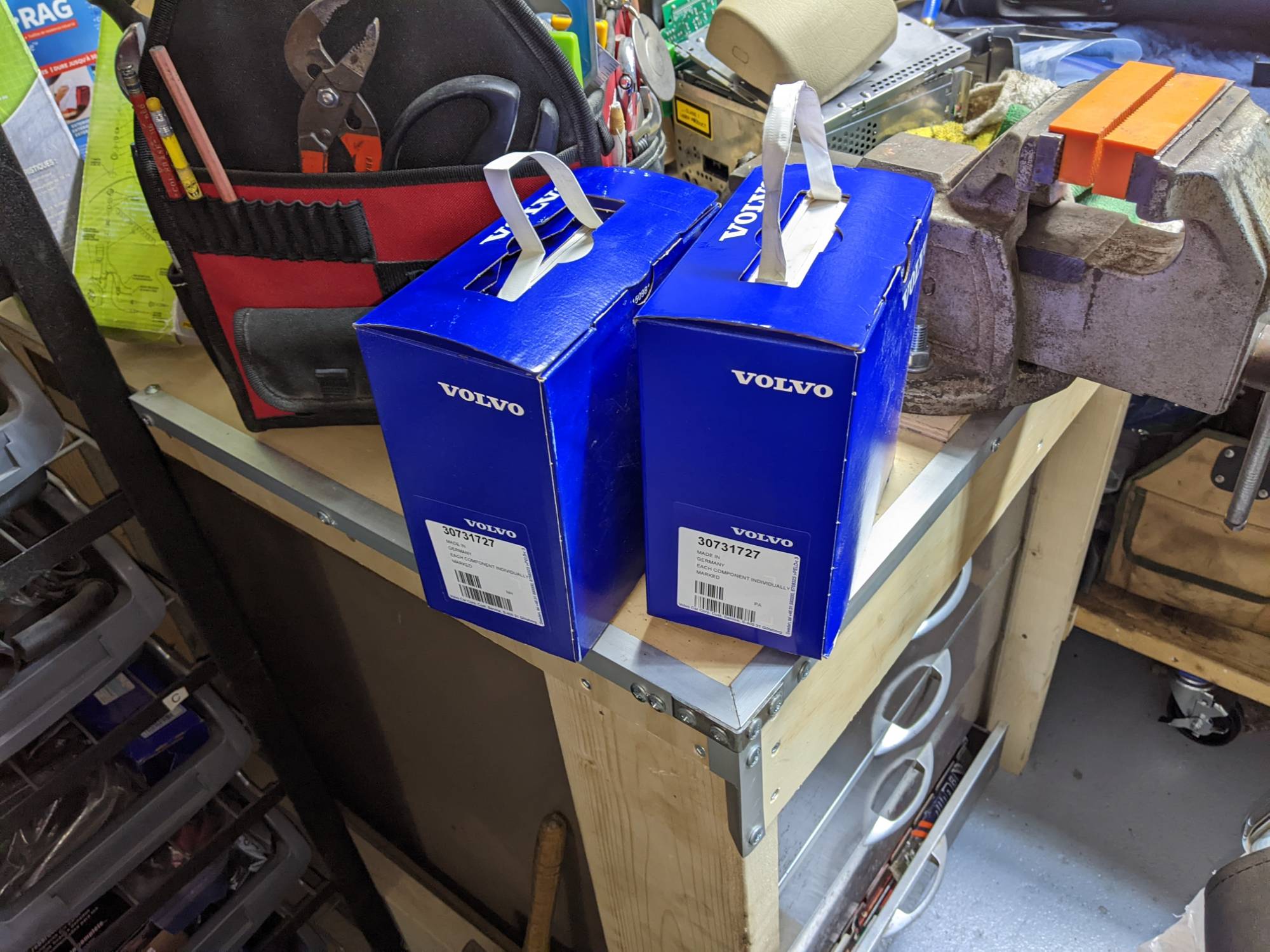

Well it is hard to get a better present than this if you own a 00 V70R. With so many parts NLA on this car with unique to R parts, but also AWD P80 parts that many are now NLA. So imagine if a buddy drops off 2 rear used but good rear brake calipers for a 2000 R! Unique to the R and only 2000 Model Year. They are like smaller front single piston caliper with a bracket, vented rear rotor, and unique rear dust shield to fit it.
Those 4 parts have been NLA since I replaced my cars' rear sub-frame when it corroded and cracked about 7 years or so ago. In fact they were NLA even before that. I found 2 reconditioned rear calipers in Canada, one in Montreal and the other in Vancouver! I have been looking for a good back up pair for 7 years!!
So when my buddy called from the junkyard locally to say that the 2nd 2000 V70 in the yard was also an R and it still had the rear brakes I asked if he could pull them for me. Awesome guy that he is (and a former Volvo dealer mechanic), he did just that and dropped them off yesterday, and he even put them in some nice blue boxes!

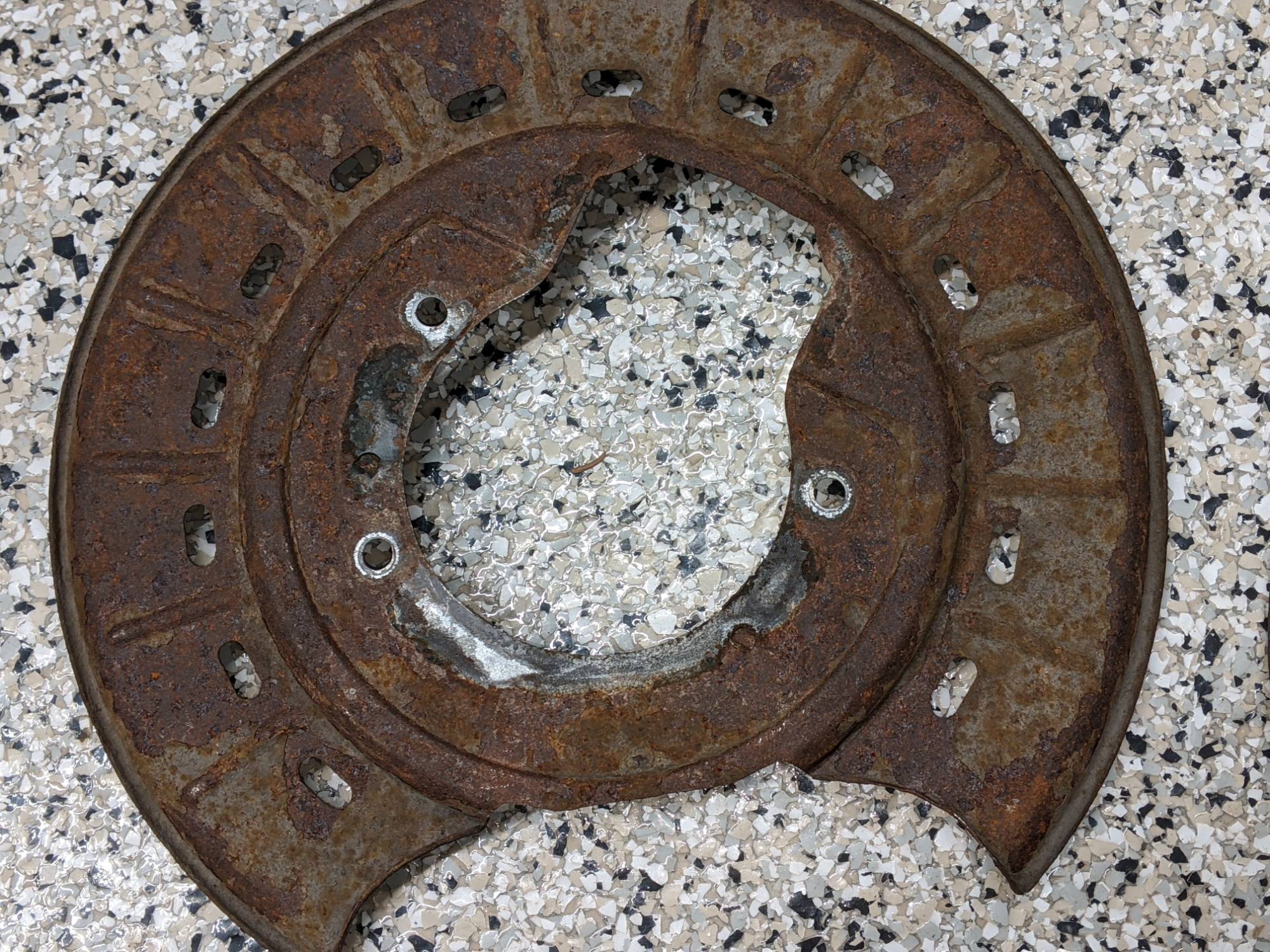

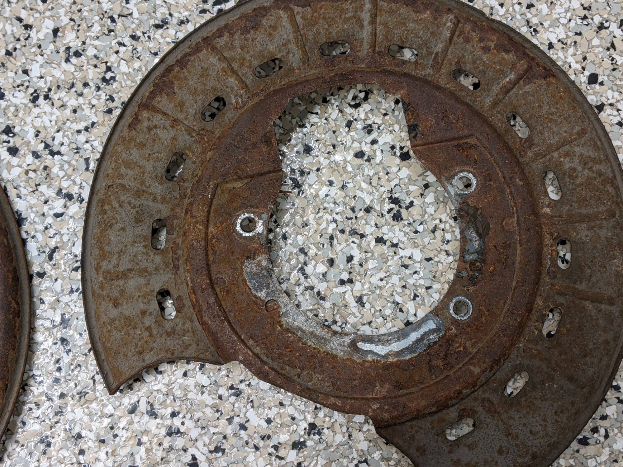

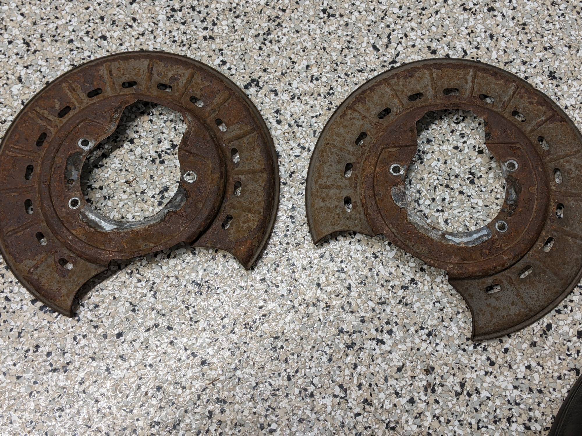

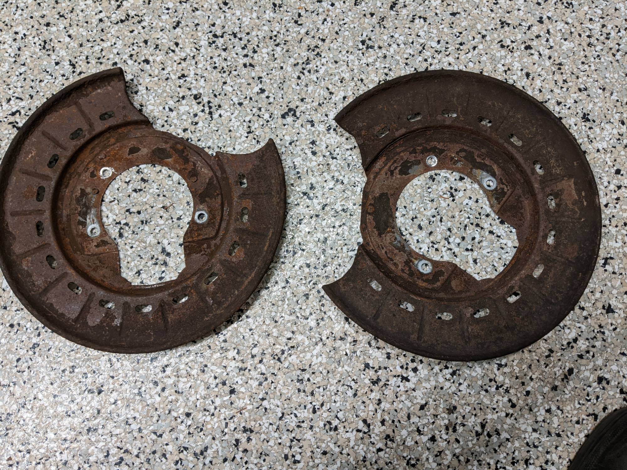

The last junk yard visit allowed the addition of yet another NLA part(s). This time included the rear AWD parking brake expanders in nearly new condition to add to my stash, and a set of 2000 V70R rear brake dust shields which have been NLA for at least 8 years!
They are not in the first flush of youth, but are still solid. I had to straighten them as they were bent to remove them from the rear axle. You cannot remove and fit these in standard form without pulling the rear hubs which require a large press. The way most junkyards remove them for you (well the ones that care about these things) cut a slot on the narrow part where the caliper fits so they can bend the section enough to get it behind the hub bearing and then tack weld the slot to hold it in together before bolting it in place.
Not sure what to do with these as I have a mint pair that have been powder coated should I need them.

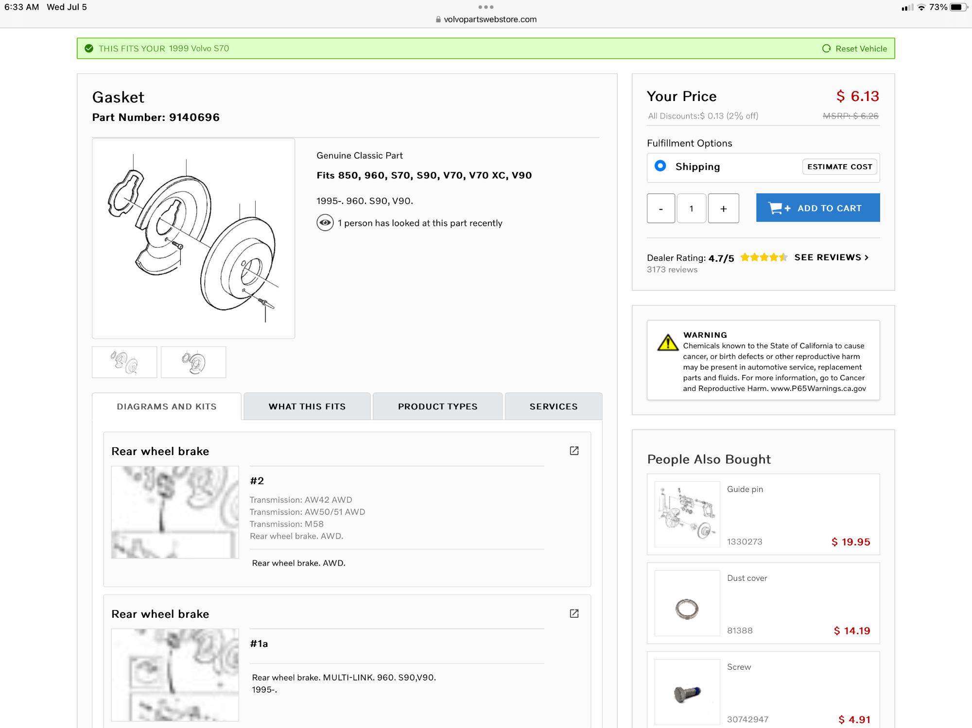

There is a thin foam seal that goes behind these between the dust shield and the rear hubs. I made these myself when I worked on my car as they were on back order. I do now have a new pair and if you want to make them I can supply a template to use.

I need them for my 1999 awd but I think they are different. I might be able to use them as templates to adapt others to fit.
Noodle…….
Gasket still available?
Noodle…….

1999 rear brakes are different for the rear which includes the backing plate. So these are not for your car. They may fit, but nothing else will.
From what I recall your rear brakes will be the same as the 98-00 V70XC brakes at the rear. I don't have my Vida computer here as a friend has borrowed it so I can't confirm. Do you still have your XC? If so compare the rear brakes. The backing plates for all P80 AWD cars are NLA, which includes the anti-rattle shield which bolts on with the rear caliper. Unfortunately I had a set of the calipers and plates but sold them recently. Calipers are harder to find but I believe still available. Abscate might know from his S70 AWD. I know he is looking for backing plates as well for that. I think it is a 1999 as well.

I just re-read your original thread. Are you sure your car is a 99? I think those are 2000 rear brakes on it as I think they are vented rotors which the others don't have. If the caliper is a single piston and a bracket like the front then these back plates will be the right ones.
If you can check my thread above and the link I added to your original thread on brakes check if you can see the part numbers on the rear brake calipers. My picture of one of the calipers above (ignore the part number on the boxes). If one matches then you have the later brakes and the vented rotors are also correct. If you can also post pictures of the back of the front rotors of the caliper brackets I can ID which brake caliper brackets you have.
