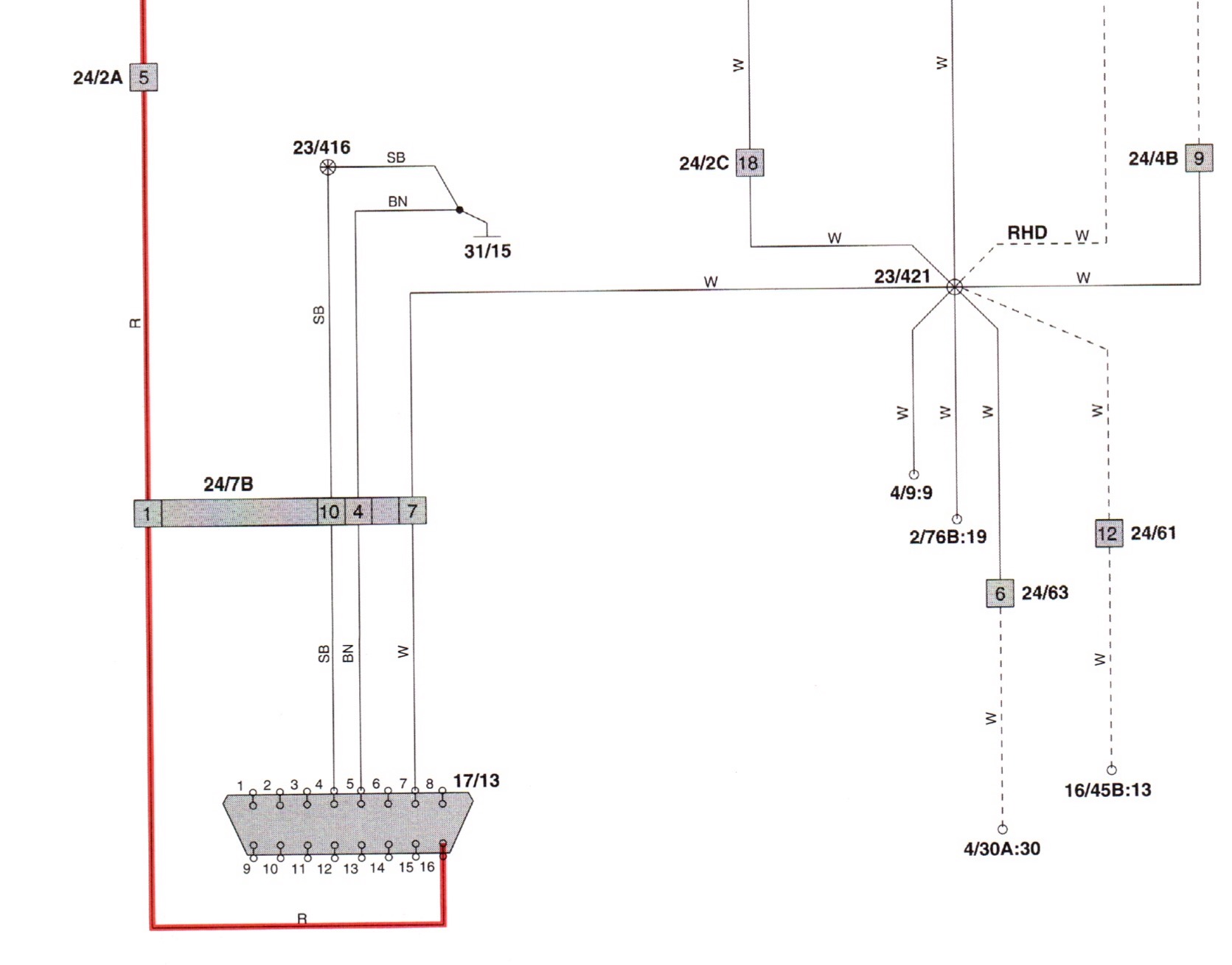

Hi,
It's hard to do that when you go right to the battery connectors because you then have to remove the connectors so you can replace the battery and if even ONE of those jumpers pops off of the connector, you lose all your OBD2 monitor settings. They all go from 'ready' to 'no ready' and you can't get through inspection.
That is why you might go through the OBD2 connector, so that he connection is more permanent as you are changing the battery.
Going through the OBD2 connector however means you will be pumping current through the OBD2 wiring, and the wiring can be very light gauge as low as #26 AWG. Using #25 as a reference, that size can handle about 0.5 amps comfortably. The resistance is about 32 Ohms per 1000 feet, which means 1 foot would have a resistance of 0.032 Ohms. Assuming the OBD2 connector has 5 feet for positive and 5 feet for the negative wires, that's a total of 10 feet which comes out to 0.32 Ohms total.
Now if we push about 1 amp through that wire it can probably handle it for a short time, maybe even a bit longer.
Ok, so now we want to connect a battery to the OBD2 connector while the car battery is let's say 11.5 volts and the OBD2 battery is 12.5 volts. That means we have a 1 volt difference. Now 1 volt across 0.32 Ohms is about 3 amps, which is pretty high for #25 wire. The question then becomes how much does the wire heat up and how much do the connectors on all ends heat up. If they heat up too much it could ruin the OBD2 wiring or the connectors.
The saving grace is that the old battery will probably have a somewhat higher internal resistance than a brand new battery, so the voltage of that battery may rise quickly to a higher value. Let's say it goes from 11.5 volts to 12.0 volts almost immediately. That means now we only have 0.5 volt difference, which means now we only have about 1.5 amps going through the OBD2 wiring. That may be ok, but that's only if the voltage does rise that much soon after the connection is established.
One of my reasons for bringing this up was because i happen to have a nice LiFePO4 battery that has terminal voltage of about 13.5 volts. It would be very convenient to use that because it's about the size of a 12v 7 ampere hour lead acid gel battery. It weighs about one-third as much as the lead acid counterpart too, so it's easy to carry up and down stairs.
Unfortunately, that would mean it could be a 2 volt difference, which would double the current estimates above.
Maybe the answer is to add a little more series resistance during the initial connection and see what happens to the battery voltage.
Since the resistance is so low being around 0.32 Ohms, if we add a 1 Ohm resistor that would lower the current to less than 2 amps, and a 2 Ohm resistor would lower it to less than 1 amp even with a slightly larger voltage difference. That could be the trick. We can then measure the car battery voltage and see that it has gone up a little, and once we disconnect the car battery the voltage should go up to nearly the full smaller battery voltage, in this case 13.5 volts, as the electronics probably only draws a small current like 10ma or something. 10ma through a 2 Ohm resistance only drops about 20mv which is almost nothing compared to a car battery voltage.
I guess this would have to be tried but it does seem like it should work well.

Couple of things:
I’d bet that the electronics on the car aren’t
anywhere near as picky about voltage as what
I’m seeing in this post. You can be fairly certain
that Volvo has “Owner-Proofed” things pretty well.
The first thing that any decent engineer does is
build solid voltage conditioning into the front end
of any processor that’s going to spend it’s life
in a vehicle.
The cig lighter is great for plugging in a back-up
12 volt supply in a lot of older cars, but the Volvos
( and MANY other vehicles )are connected to the
ignition switch, not a constant battery source.
As mentioned, OBDll appears to have B+ on pin 16.
Triple check that. You probably don’t want to point
12 volts up the wrong pin.
Ground appears to show on pins 4&5.
. And how many people am I gonna tick off
if I bring up the accessory connector again?
It’s tailor made for this assignment!
