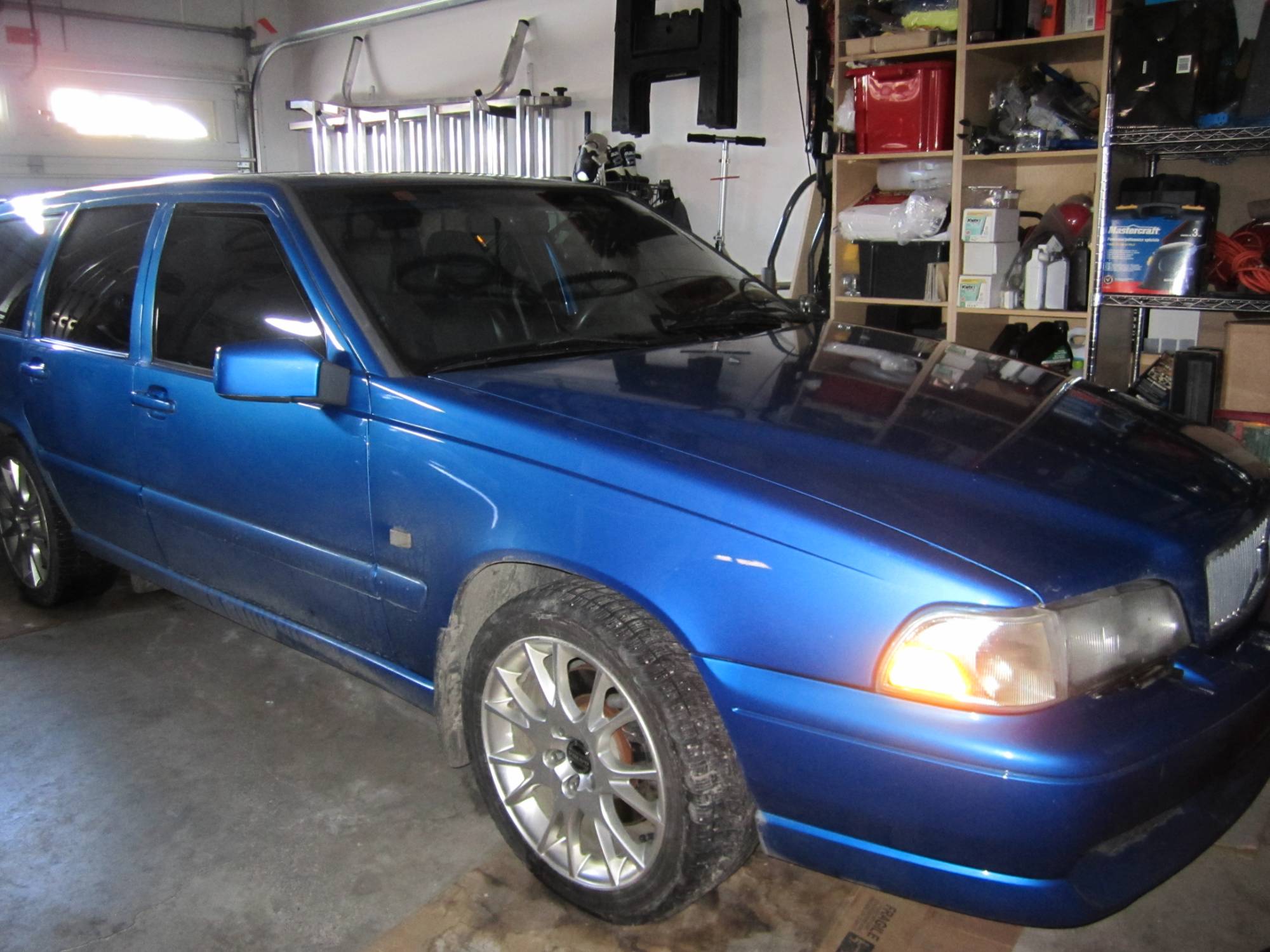

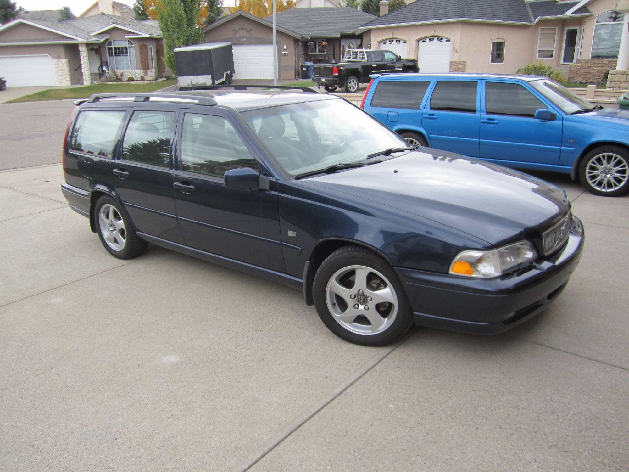

There have been debates that some aftermarket front struts (Bilstein being the main one) have the lower spring seat sitting higher than that of the OE front struts. My V70R is on Bilstien Tourings and does not sit that high. It could also be that aftermarket springs have been used and they are not the correct length.
Another issue is that perhaps the owner did not torque the lower control arms on the front with the weight of the car on the suspension. This might jack the front struts and control arm bushes raising the car. You car will likely have the 2 bolt front control arm inner pivots. You could try loosening them and letting the suspension settle sitting on wheel ramps, then re-torque the inner bolts. It may not make a difference but it is a free potential fix.
Volvo used several different spring rates for the front of these cars which is shown by a code on your Vin plate. That code relates to a part number for your car. If a generic spring has been used or one from say a V70XC they may be the wrong length and spring rate.
This is my car when bought 10 years ago and on Bilstien HD shocks (which were way too hard for our roads):
This was about 6 years later with full OE suspension except the Bilstien Tourning front shocks.
A year later:
This is my V70 base wagon with standard front springs and Lesjofors shortly after completing a major overhaul. My buddy now has the V70 base car and now had IPD HD springs on it and it still looks like that. The R has settled over a year after refreshing the suspension.
