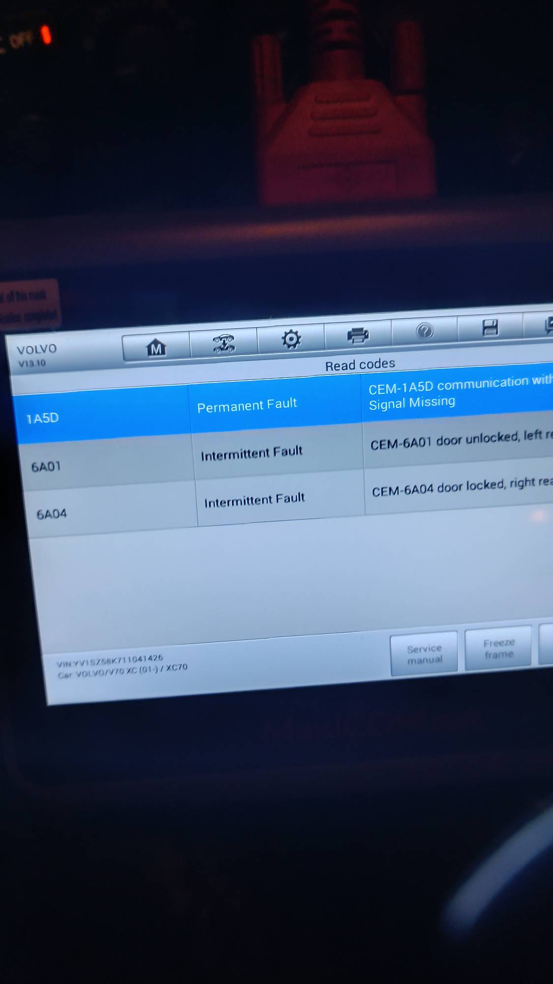

Luckily I have a fairly recent obd Autel mk808 case which told me that there was no signal coming from the box ... I check by looking into the case and indeed it does not move during a startup, I missed a step or a configuration?
So I put the old throttle back on and now I can see the signal, with movement on the throttle, but the sensor is acting up ...
I deleted the error code several times, removed the battery for 30 minutes with my foot on the brake and even did a Factory reset and a car reset. Nothing helped ... (it just fixed my sunroof that wouldn't open aha)
Error code
Error code
Do you have any solutions? ❤️❤️

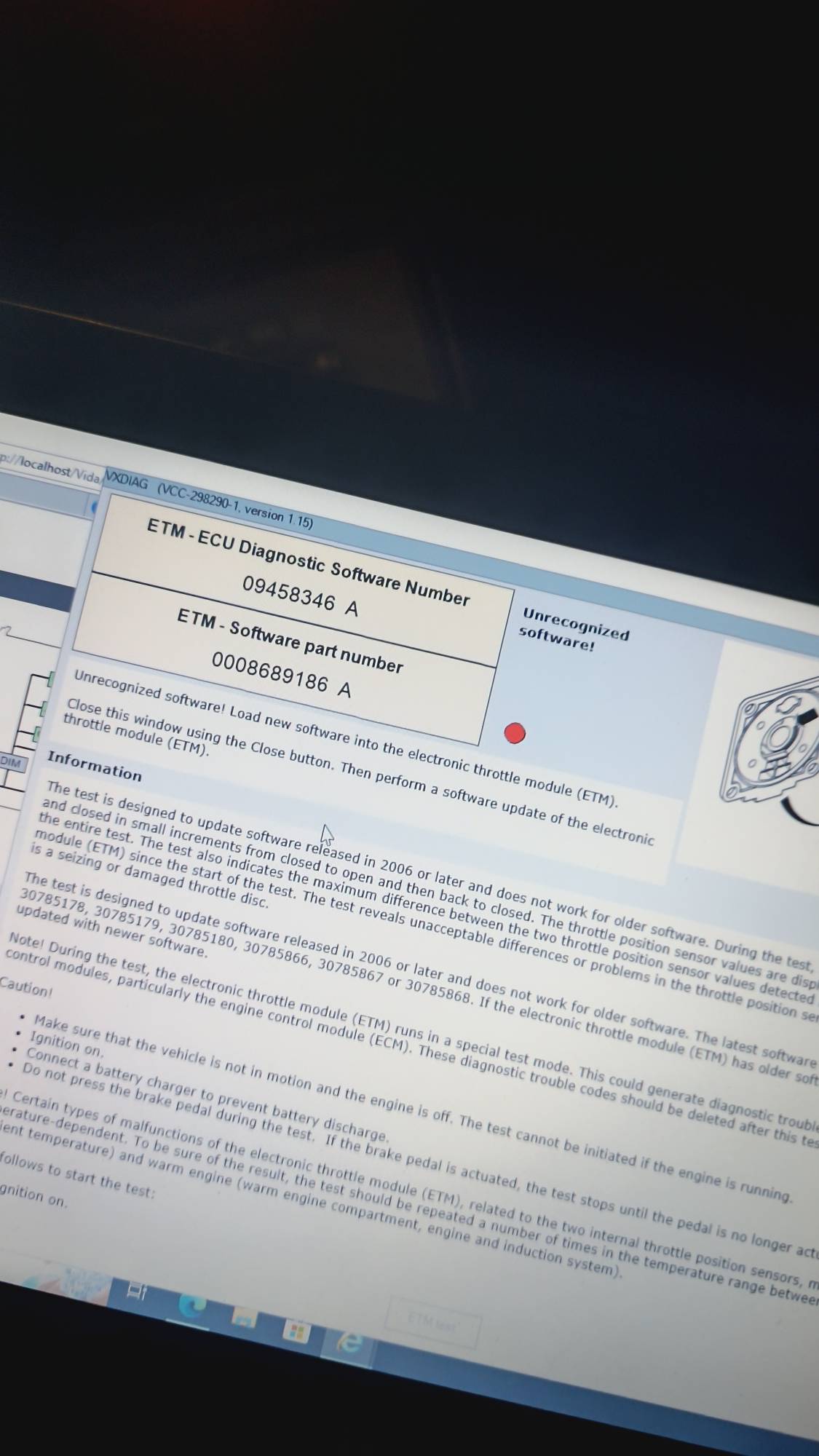

The Etm has to be reloaded using vida if its new. You have to check if its communicating, not sure about autel but in vida you can do the test. Vdash can be used to clone old etm but it cost 46eur, ask dealer how much is the software upgrade it may cost less than vdash

1a5d means no power in etm. If its only on new unit then It may be faulty. Did you get the Etm for turbo engine?

I ordered the necessary for the use of vida, I will keep you informed
adblock
Posts: 22
Joined: 11 Jul 2023, 00:11
Year and Model: 2001
Location: France
Has thanked: 5 times
Post by adblock »
here's what the software tells me once the new etm is installed, I've been able to contact different volvo garages who tell me they can do it for around 180 euros but that there's a 50/50 chance that it won't work... they don't know much about the first models either...
Can anyone give me a reliable procedure to help them with my problem?
when I reassemble the old one, it tells me: signal missing, it has been tampered with by several people, a sensor change has already been made
