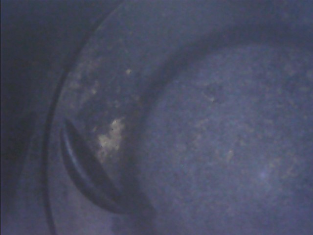

I pulled the plugs and hand cranked it. There was a little resistance as the pistons changed direction but other than that it was relatively smooth.
I did a compression test and got consistent numbers on all but #2. The other 4 held at about 135. #2 got to about 115 but slowly started dropping.
I then ran my scope down the cylinders. My scope is pretty old and I couldn’t get good pics but here’s what I found. The 4 consistent all looked the same. They looked dry and dark, almost like covered in black ash. #2 looks like it’s wet or covered in oil. Maybe I just can’t see it on the others because they’re so dark but are those bright silver spots on the sides of #2 normal?

- #1,3,4,5 all looked like this
- WIN_20230718_20_32_26_Pro.jpeg (43.82 KiB) Viewed 1352 times
- #2
- WIN_20230718_20_34_03_Pro.jpeg (76.03 KiB) Viewed 1352 times

After taking some time to actually think, it dawned on me the marks on the side of the #2 piston matches the head. So the piston must be making contact with the head. My initial thought is that the timing must have jumped but I'm starting to wonder if maybe failed bearing caused too much slop, causing the contact.
