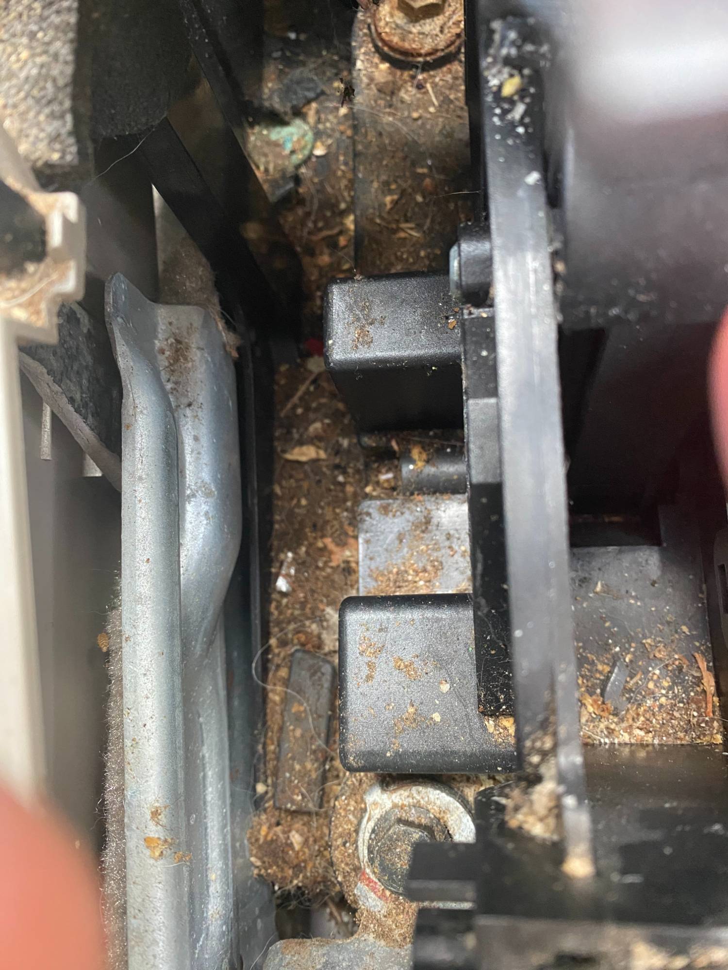

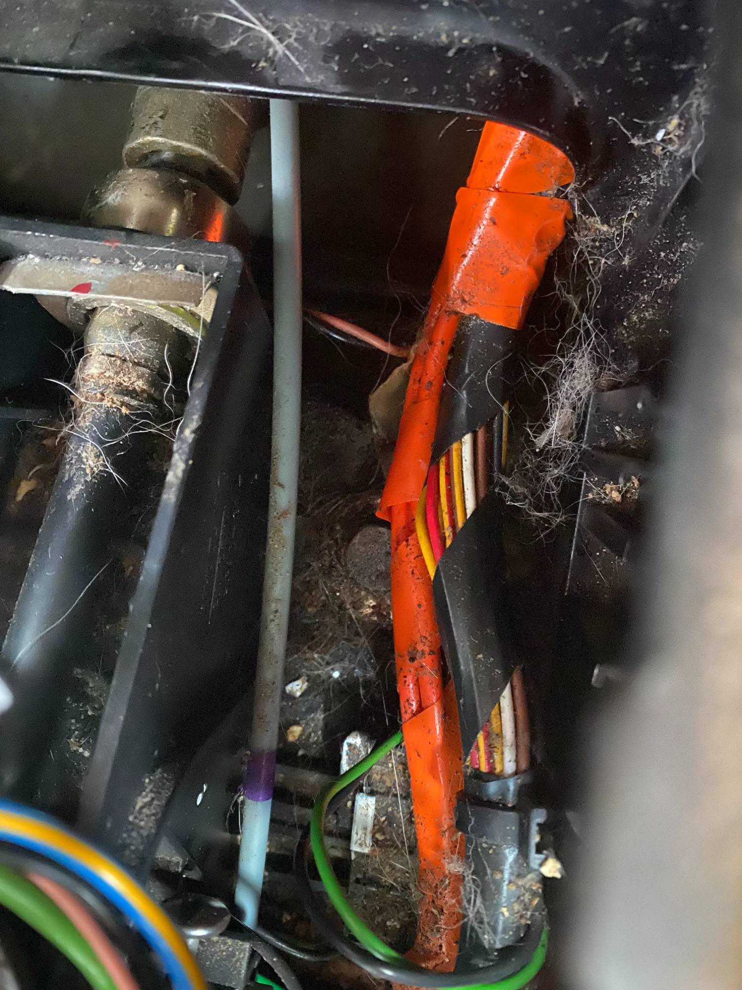

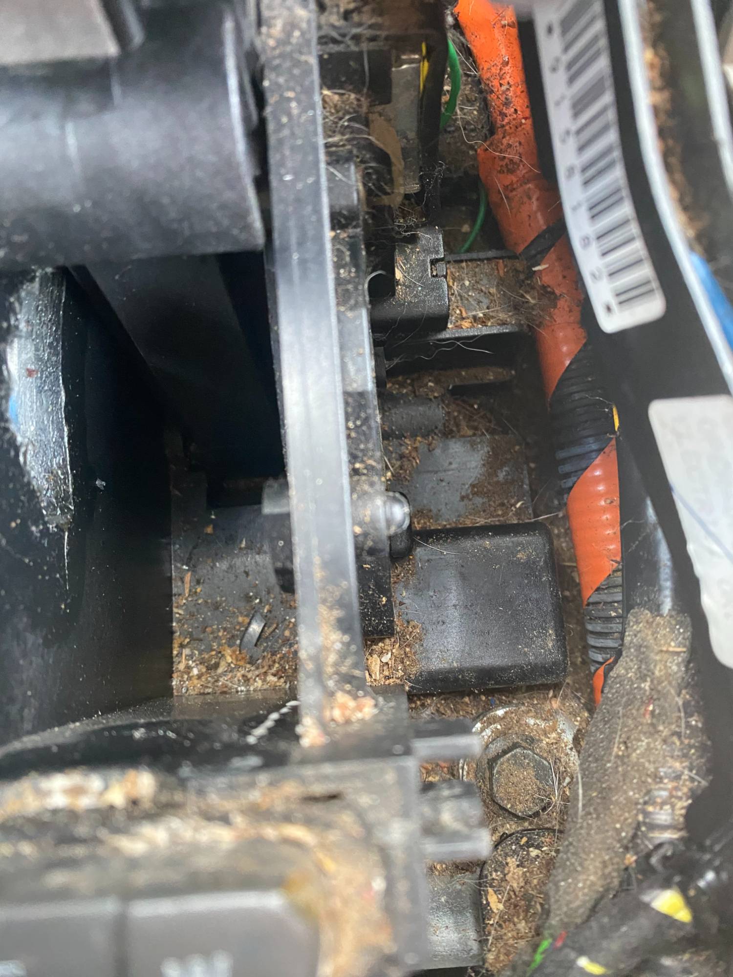

I took photos of the shifter cavity as I wasn't sure where the relay with pin was located.
It might be in the bottom of the photo entitled Right Front Shifter cavity. All the other relays
look like they just plug into a socket. There are four photos total.
I have been unable to shift out of park, the key turns fine, the shift button presses in, but
I cannot move the shifter back to the reverse position.

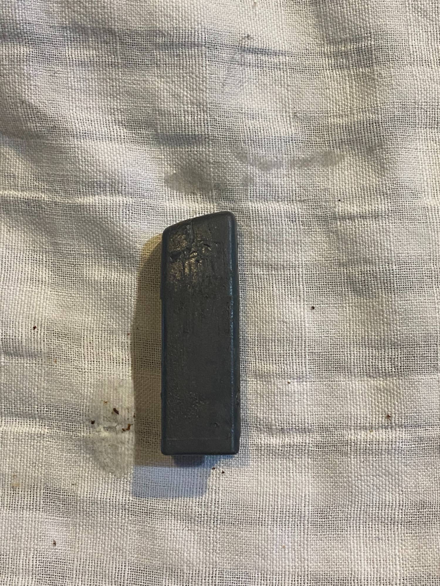

There should be a shift lock button if you have a 1998 V70 XC and it should be on the RHS of the gear shift when it is in Park. Small black button you have to push down, while foot is on the brake peddle and key in Pos II. If that button does not move, then it is seized, likely as someone has spilt a drink down the sides.
Looking at your pictures, in the #3 picture there is a black object lying just above the bolt at the LHS of the picture. That looks like your missing button.

Next step was to have my partner (who owns this wagon) watch for the one brake light that used to work, and it didn't light up. A poor U-haul tow harness was installed, cutting and abandoning brake light wires to the center and right side. I will have to fix that once I figure out why the left brake light which used to work has died. I have a replacement brake light switch, but a bench test passed, so maybe the relay should be checked or replaced (see below).

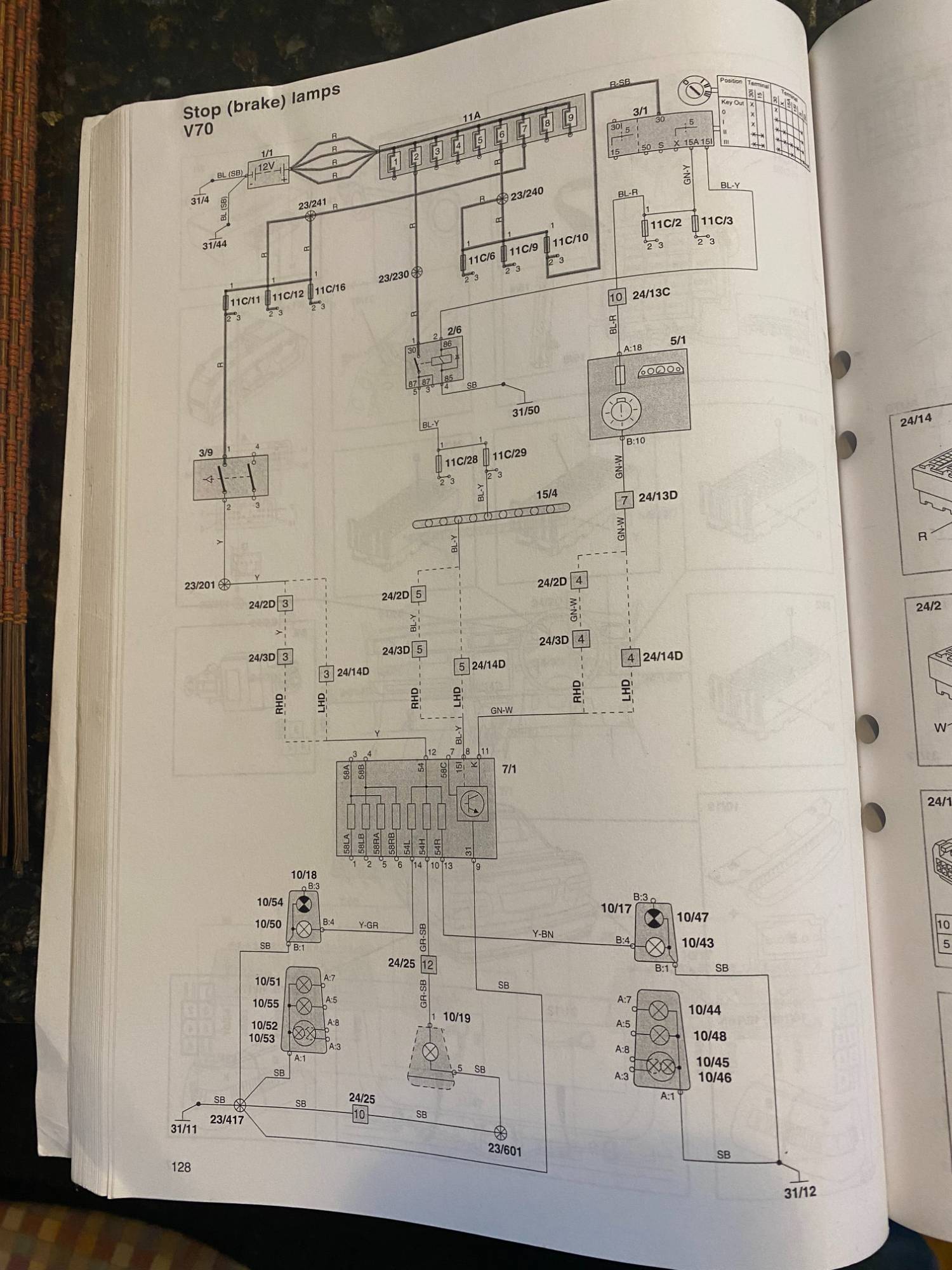

I checked fuse 11, it was fine. The schematic page 129 I attached shows relay 106 should be checked. Schematic page 128 is a guide for further troubleshooting and fixing the brake light wiring that was incorrectly cut in the rear of the car when U-Haul did a fast job on the installation of the harness and tow bar.

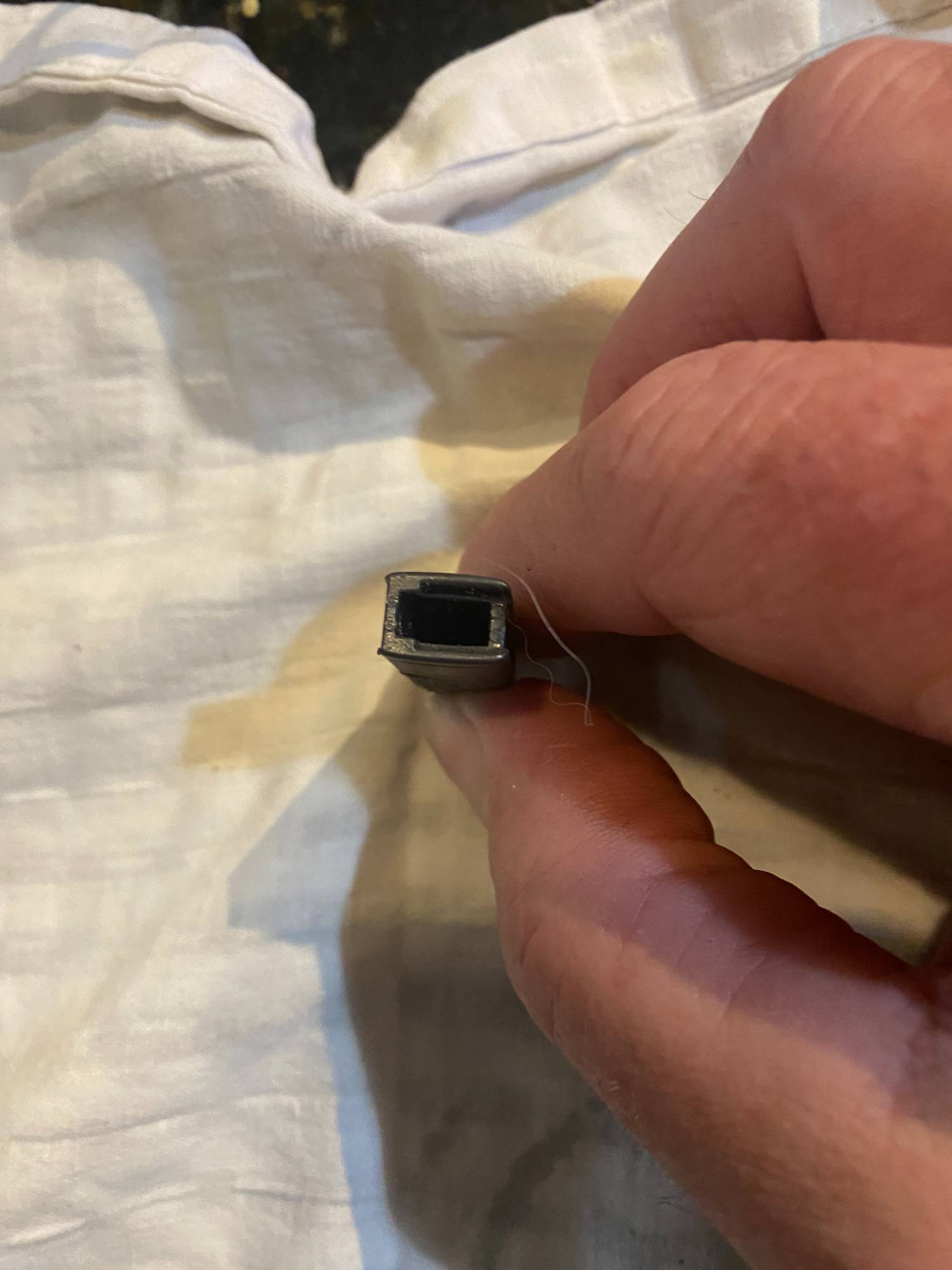

The observation of the missing shifter button was correct. I picked it up with hemostats
and took two photos. There is no linkage for the button, and no parts diagrams showing what is missing.

They are both right. The shift knob button will gum up, so verify that pushing the button actually moves the cross shaft (number 3 on your diagram). Then listen for the solenoid (number 20) to click with key on, brake pedal depressed. If no click then unplug its connector (black and green wires) and check for twelve volts under the same conditions. That eliminates electrical problems on the car side of the plug. I don't know of any relays down there, but I have a FWD car. You may find it easier to remove the whole shifter than try to fix it in place.

Also, check the kidney fuse box, make sure you didn't blow one of the main fuses. That's the kind of fuse I'd expect to be blown for that many relays to stop working. Other idea would be ignition switch but not likely as she's firing up from the sounds. Are there any other electrical gremlins other than the rear lights? Any other dash lights lit, radio not turning on, etc? When you turn the headlights on, do you get the burnt out bulb indicator illuminated/on?
