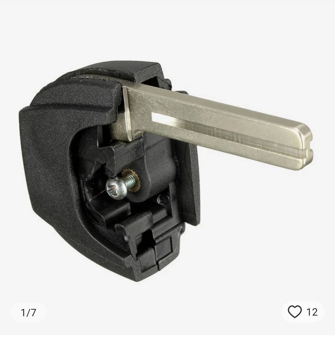

In my experience and after having many discussions with Henry (known as Doublebug here) you can swap out a UEM with any other of similar year as long as the matching key fob is used.
The issue is the key transponder (small glass tube) which is housed within the key fob will need to be swapped over to the new key fob so the vehicle will start and of course you need the original key blade too. Swapping the transponder and key blade is easy because it is housed in the separate key blade head which separates with just one screw.
There's quite a few posts here about doing this.
- IMG_20230806_083433.jpg (63.75 KiB) Viewed 2171 times
