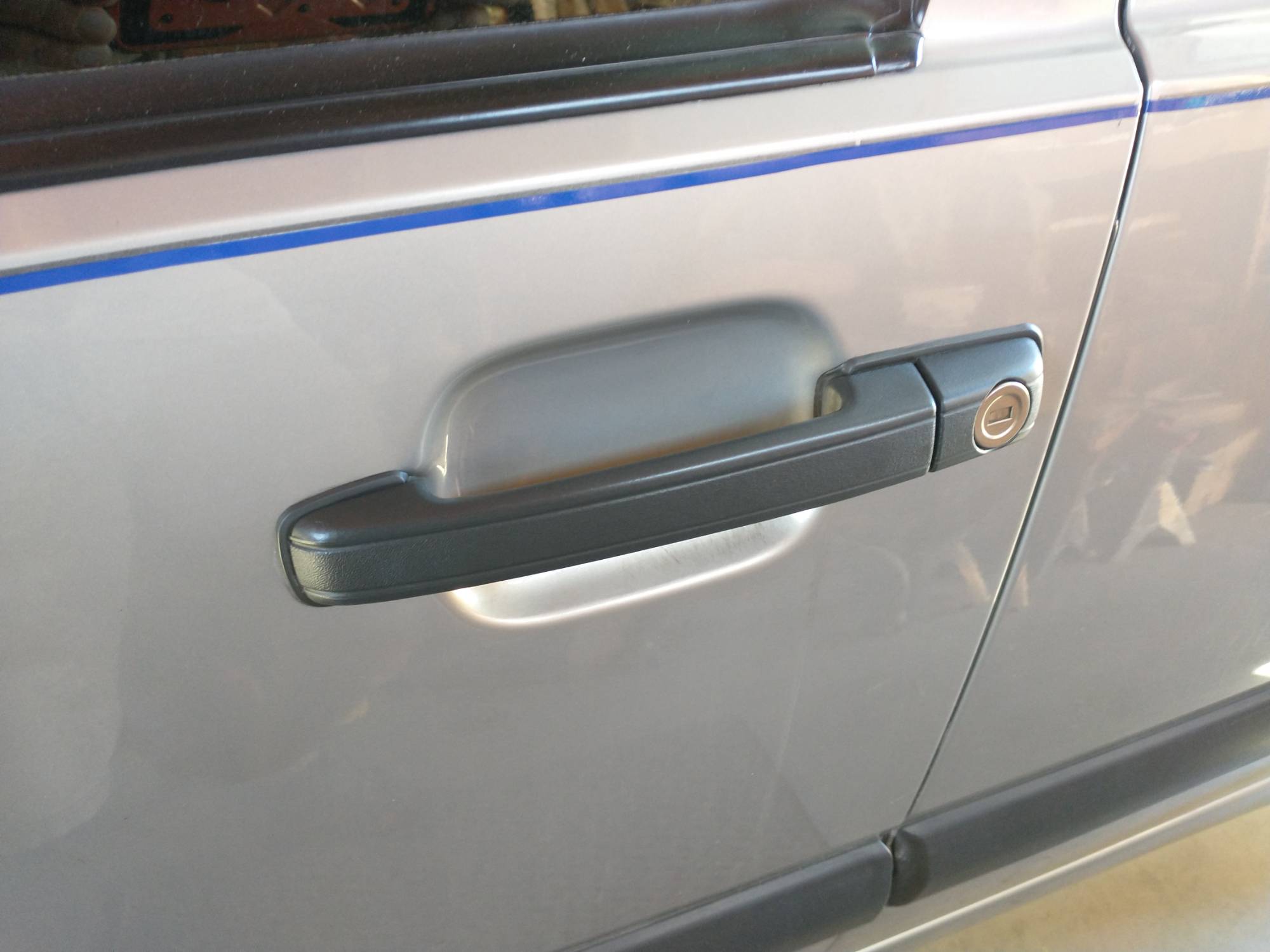

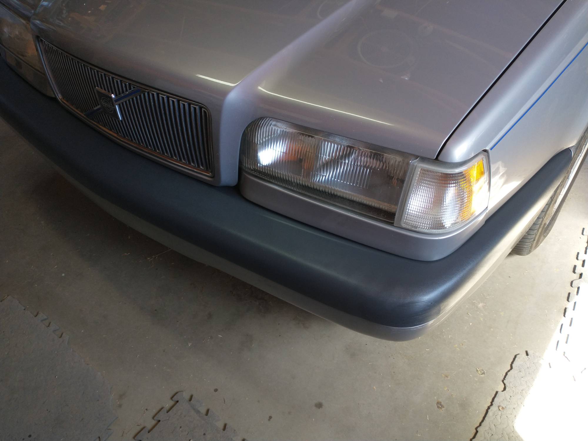

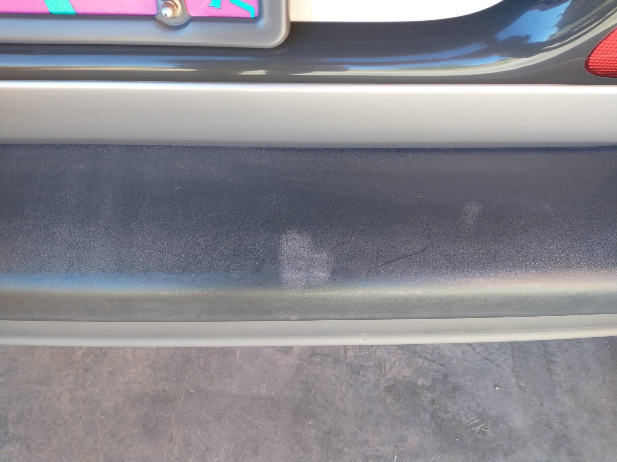

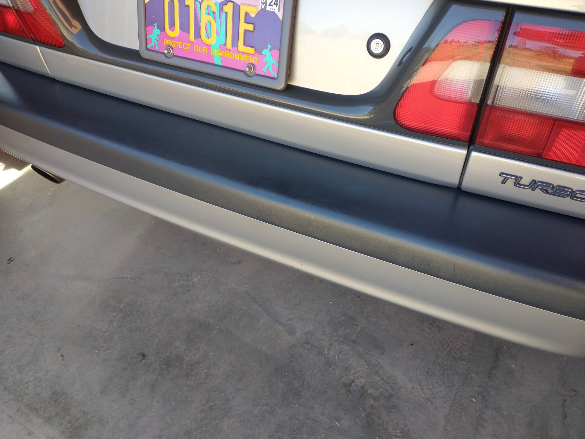

I've been wanting to restore the bumper covers and trim on Sveedy for some time, but have put it off due to not being able to find a good product in, and here's the key, the right color. The bumpers and trim on 850's are a sort of charcoal gray color, not true black, and like most plastic covers, mine were faded. Plus the rear had some sort of a stain that I could not remove no matter what I tried.

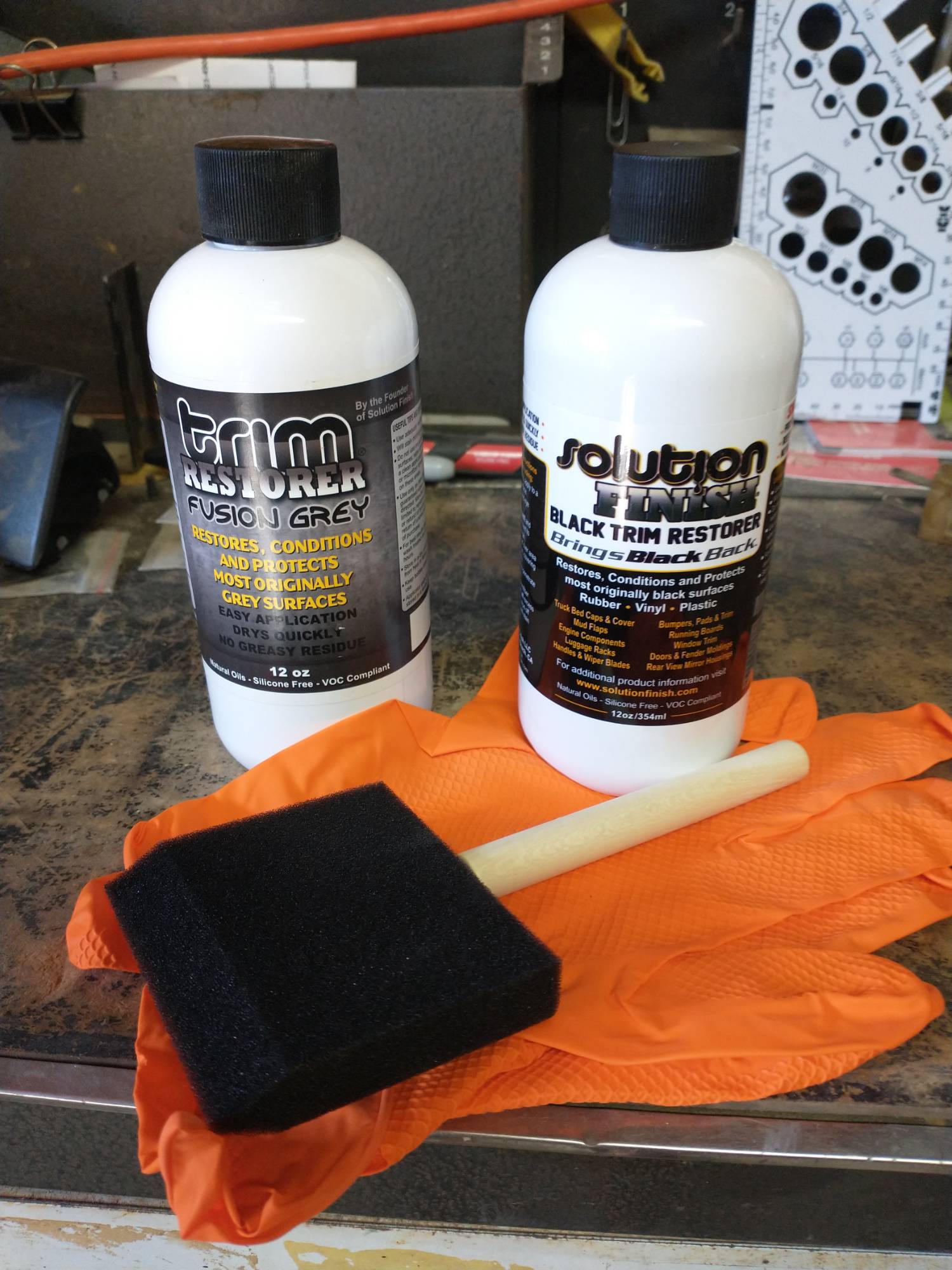

I was able to find a company online that sells a dye solution in black, and one in gray, so I bought a bottle of each. The ratio ended up being apx 5 parts black to one part gray. The downside is that I had to buy a bottle of each, which obviously doubled the cost compared to any other car or truck. But I am very happy with the results. The stuff is a dye, so it should last, particularly after I seal it with a ceramic coating.
Like all thing of this nature, prep is key. Clean, then clean the cleaner. Other than that, easy peezy.

That looks great! Please give us the 6-12 month AZ sun exposure update.

It's coal black, so nowhere near the original. Wouldn't match the other plastic trim. That said, I can see how the black would look great, depending on the car.Clemens wrote: 05 Aug 2023, 15:16 Wow, awesome results. I can't get the grey one over here, though. How off would just black look by your opinion, Sveedy?
Weird that you can get the black, but not the gray. I'd reach out to them and see what gives. It would also be nice if they sold the gray in a one once size. They do with the black, but not the gray. I was measuring in teaspoons, so a 12 oz bottle of each would probably do 15 cars.
