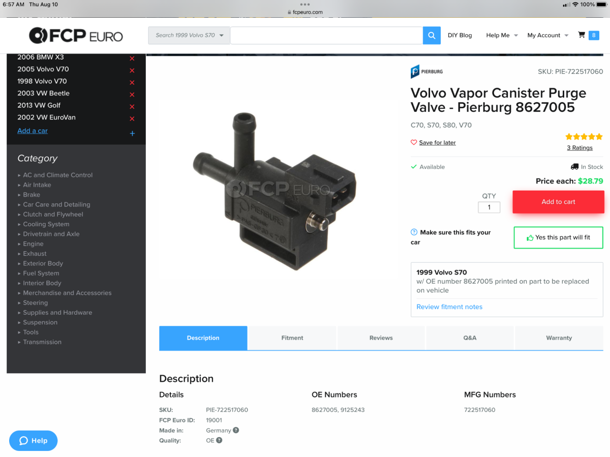

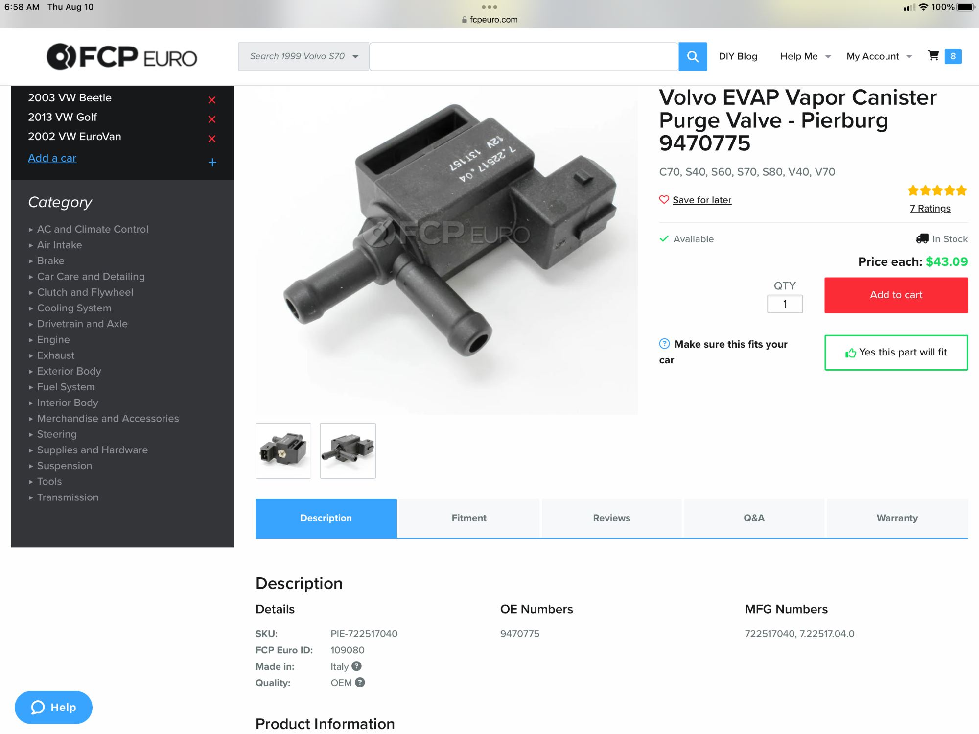

There are two fitment s listed for these cars based on number printed on valve.
No VIN or engine number is given
Both are Pierburg valves
Does anyone have info on which is which and what the differences are?
Could be difference between current sink of ME7 vs ME4.4/DENSO engine management

P80 late Return lacking fuel system RLFS 9470755 8627005 - fitment for 98 99 00 cars

Resistance measurements new out of box parts on the two variants
04
06
04
06
- Posts: 36137
- Been thanked: 4064 times
Readings from
Shagg 22 Ohms pier burg 02
Evita 33 Ohms pier burg 02
Kat. 31 Ohms 9125243 pier burg 06
9470755 pier burg 04 and also labeled Pierburg 02 , measures 22 Ohms

This is my speculation as of 2023-08
When the evap canister moves back to the rear passenger area in mid 1998 model year, fuel pressure regulation is no longer handled by a manifold vacuum line , but a tee off the purge valve. This means the purge vacuum now also manages the FPR so the purge valve has to reflect this. It might be turbo NA parts break

Finally figured out the emissions code. It’s the 8th digit in the VIN so
Kat is D
Evita
Shagg A
Elizabeth D
Of course, in the Volvo parts store there is ambiguous , confusing information as to which purge valve goes with which purge valve. The codes are shown in the title page of the part, then on;y a subset of codes are listed in fitment.
No idea where emissions codes 7, 8 are coming from , these are probably 850 emission codes
Grrrrrr..
It also shows another Pierburg part number suffix
02 04 06 03 00
