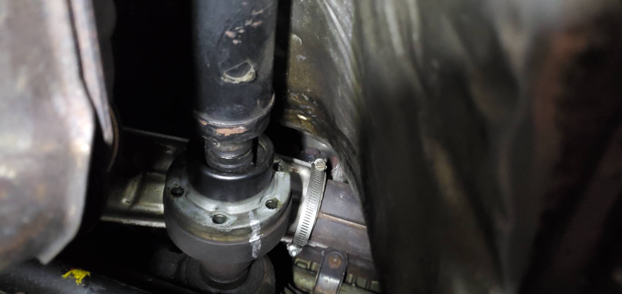

I finally have some time to work on my own car and try to fix a clicking noise when initially hitting the gas, brake, or on turns. Almost sounds like a bad CV axle, except only 1-3 clicks instead of constant clicking.
I'm thinking it's the front CV joint on the driveshaft, as I see a tear in the boot, and some sludge in the area that looks like slung grease.
I've gotten all 6 bolts out, but now can't seem to get the joint separated from the angle gear flange. It appears there's a lip on the flange that's retaining the driveshaft.
Is there any trick to doing this, or do I need to take the center support down? Every guide I could find either had broken images, or just said "now the front joint should come down easy".

Strange as the 98 I had had an almost flat flange. Yours looks more like the 99- version. The only way I have been able to separate that type (it has an internal 'cup') is to use a narrow chisel or flat screw driver and gently tap it between the angle gear flange and the 'silver' colored section.
The front joint looks toasted. I believe that is the only one that can be replaced without special tooling. Have a really close look at the center rubber support bearing rubber as well. The rear seldom fails. The front joint fails as Volvo stuck the cat right beside it. Not their best idea!
If you take the prop-shaft out fully, then also check the rubber bush on the viscous coupling casing and also the bearing on the 'nose' of the V/C casing. That can cause a clicking or rubbing sound especially when turning.

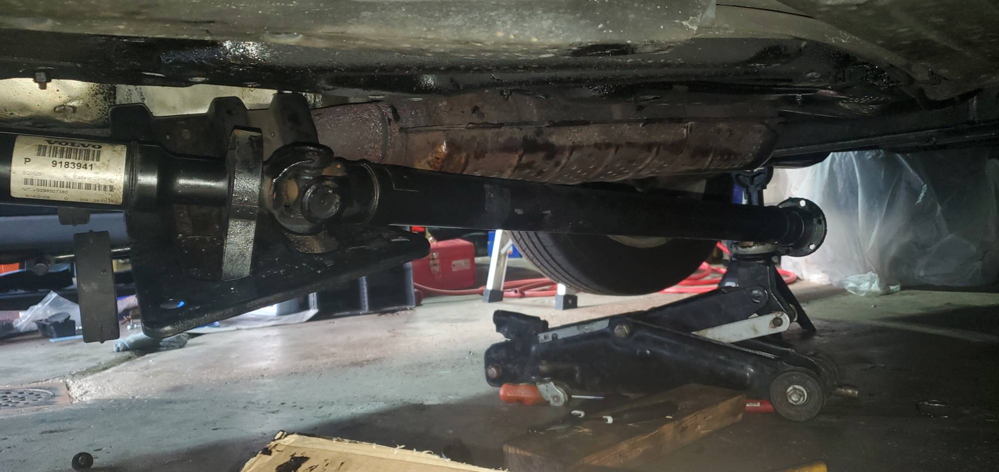

No amount of swear application was able to get the rear joint of the driveshaft out. I didn't want to be too rough and end up ruining that joint, because it's my understanding that the rear CV cannot be replaced for some reason.
So I'm working like this, I was able to pry the front joint out of the flange by bracing a screwdriver on the sway bar. A lot of frustration could have been avoided if there was no lip on the flange.
Grease looks cooked to me, there's a big tear in the boot, and lots of cracking.
The center bearing spins free, but no grinding noise. It seems there's supposed to be a little bit of lateral play that gets taken up by the rubber that's between the support bracket and the bearing itself.
