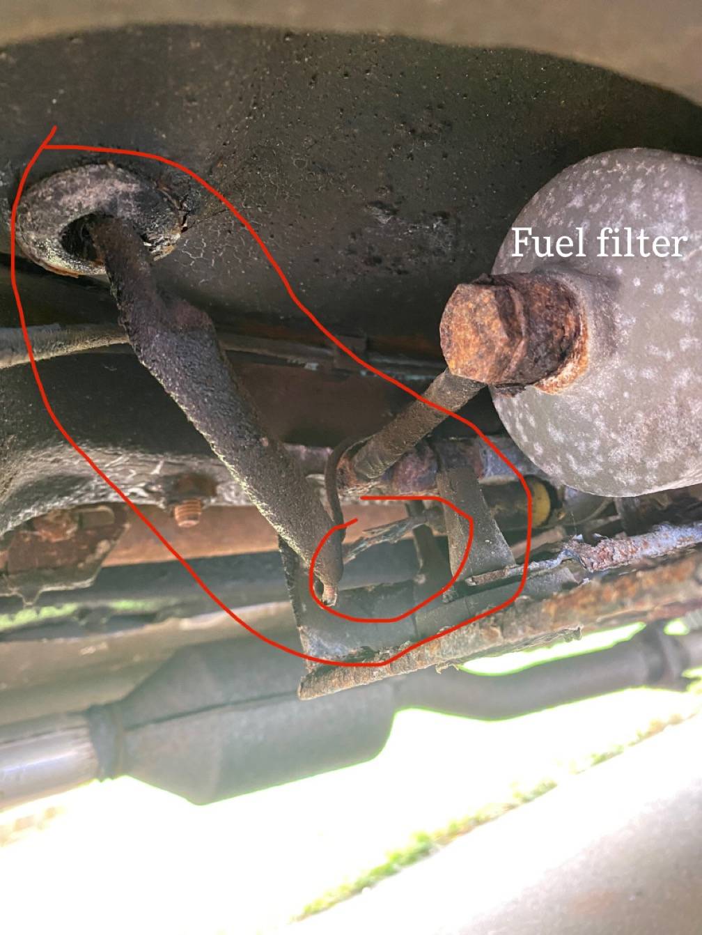

Hi,
Looking to replace the fuel pump connector and wiring because it's corroded and the wires are exposed. Where does the connector trace to? Is it possible to buy a new connector and splice the wires? Any help would be appreciated.

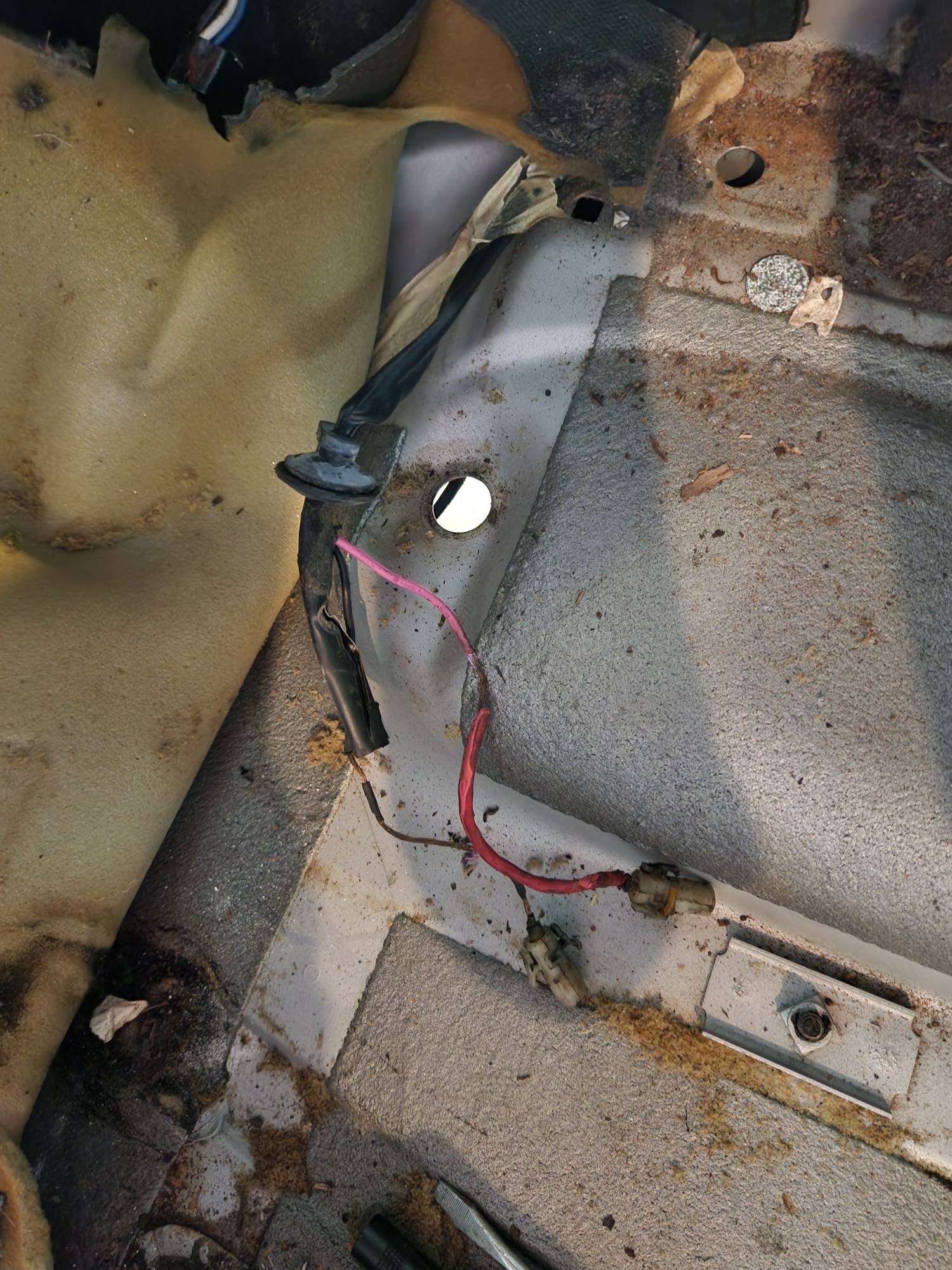

Post by davep84 »
