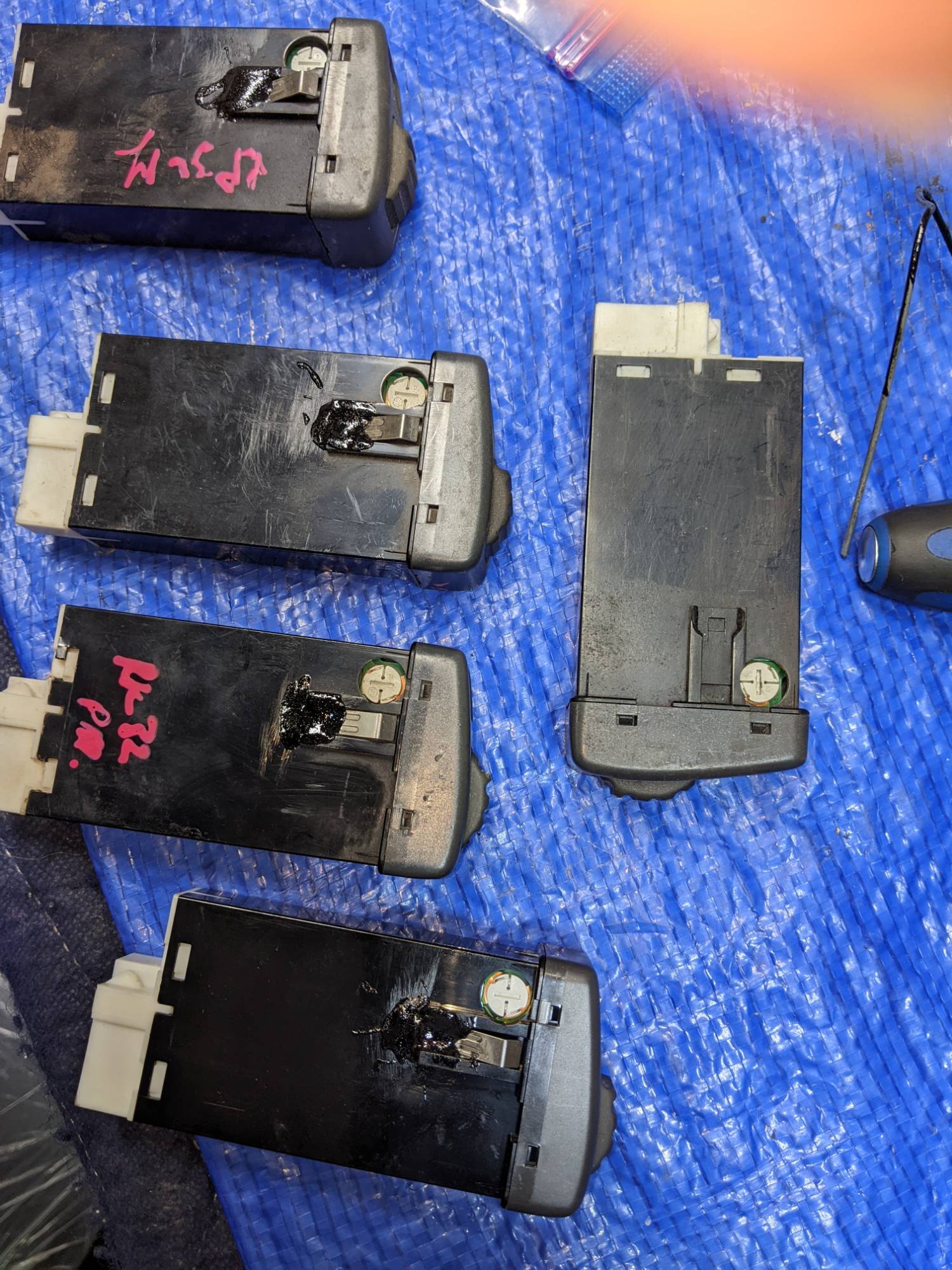

1999 S70 - does anyone have a fix or alternate way of securing dash switches (such as dimmer) when the plastic slides are broken and wont hold a clip?

dimmer switch looking for one with both clips intact.
not sure about the MBTF - every unit I see has broken clips

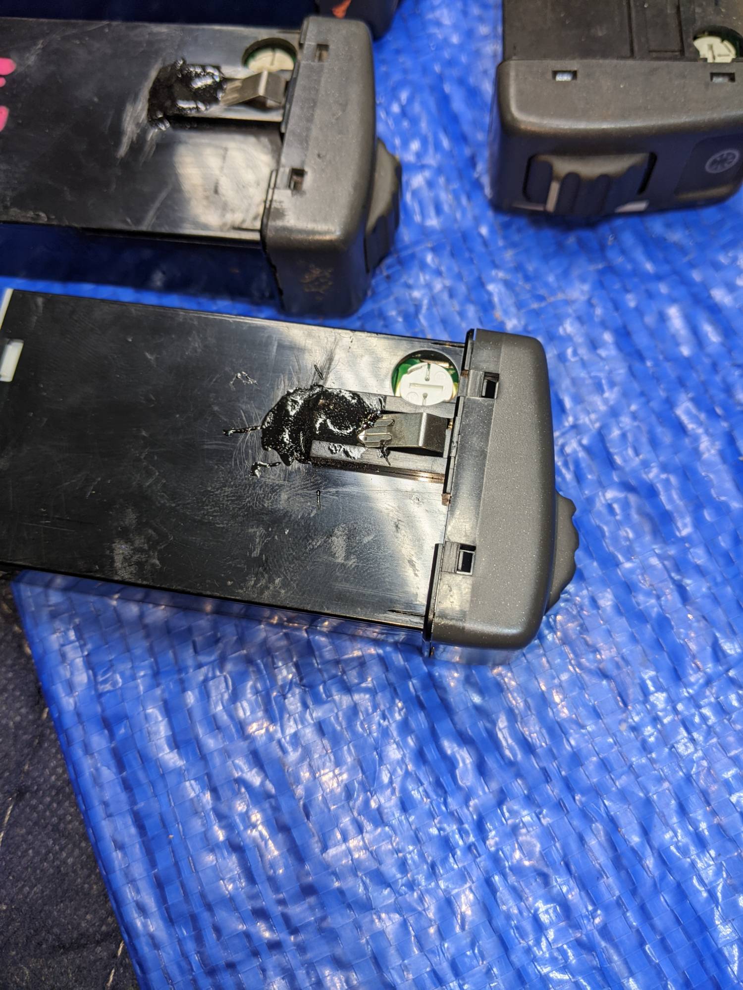

I have repaired them with JB Weld Plastic bond and they are stronger than original. The part runs hot and you are 99% likely to break at least one of the metal tabs off removing one. Really stupid poor design!
Like I said they are stronger than original but still flexible enough to fit. I even 'repaired' any clips that still looked good to prevent them breaking again. Maybe not pretty, but then you are not looking at the repair!
Hope this is of help.

thats awesome. I just did the same repair...worked like a charm!!
