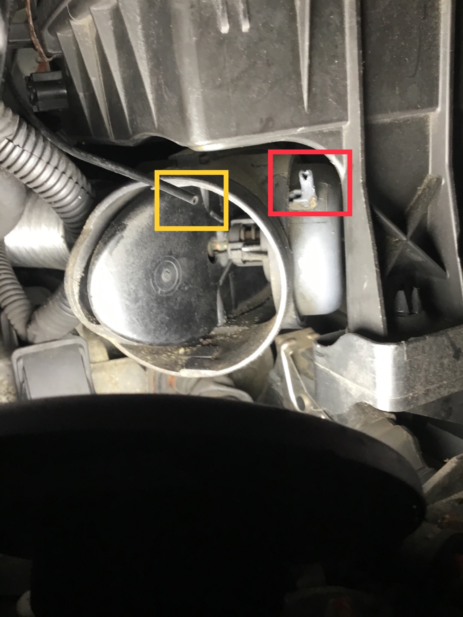

I believe I may have damaged something something here while removing the air intake preparing for rad replacement.

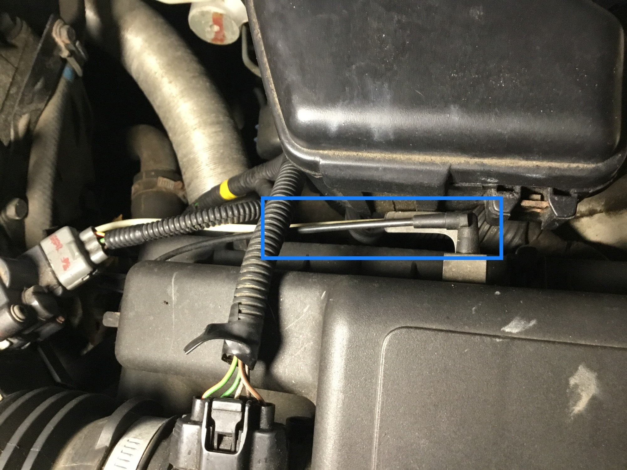

The red box looks to be a port to operate that vacuum motor if that’s what it is to move that air valve? I pulled up the Vida schematic of the air intake but though it shows the intake tube and the air filter box there is no image of this mechanism. And no vacuum lines shown. The yellow box is a hard vacuum line off the backside of the air cleaner cover. Blue box below.
I’ve searched around for vacuum a schematic as the one on my hood shows nothing of this and frankly looks nothing like what I have on the car. The proximity of the line to the nipple on that grey mechanism leads me to believe they mate up though it seems like a small line to operate it. Thank you nursing me through this radiator job. So close…

You are missing a rubber elbow that joins the hard line to the vacuum motor flap as you correctly noted.
Your local flaps will have a Dorman replacement
