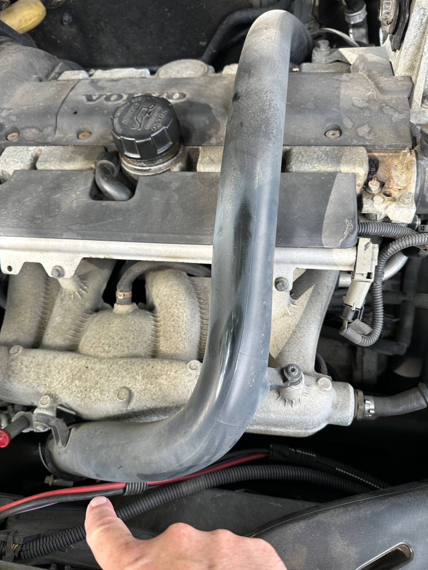

Looks like jonesg is on the right track (not that I had a doubt), here's what I found when I looked under hood in daylight just now. Going to order that rubber coupling right now, the one I've got has oil around the top ridge like it's bled out and oil all down the side. Didn't know where to look before, thank you very much for the guidance.
