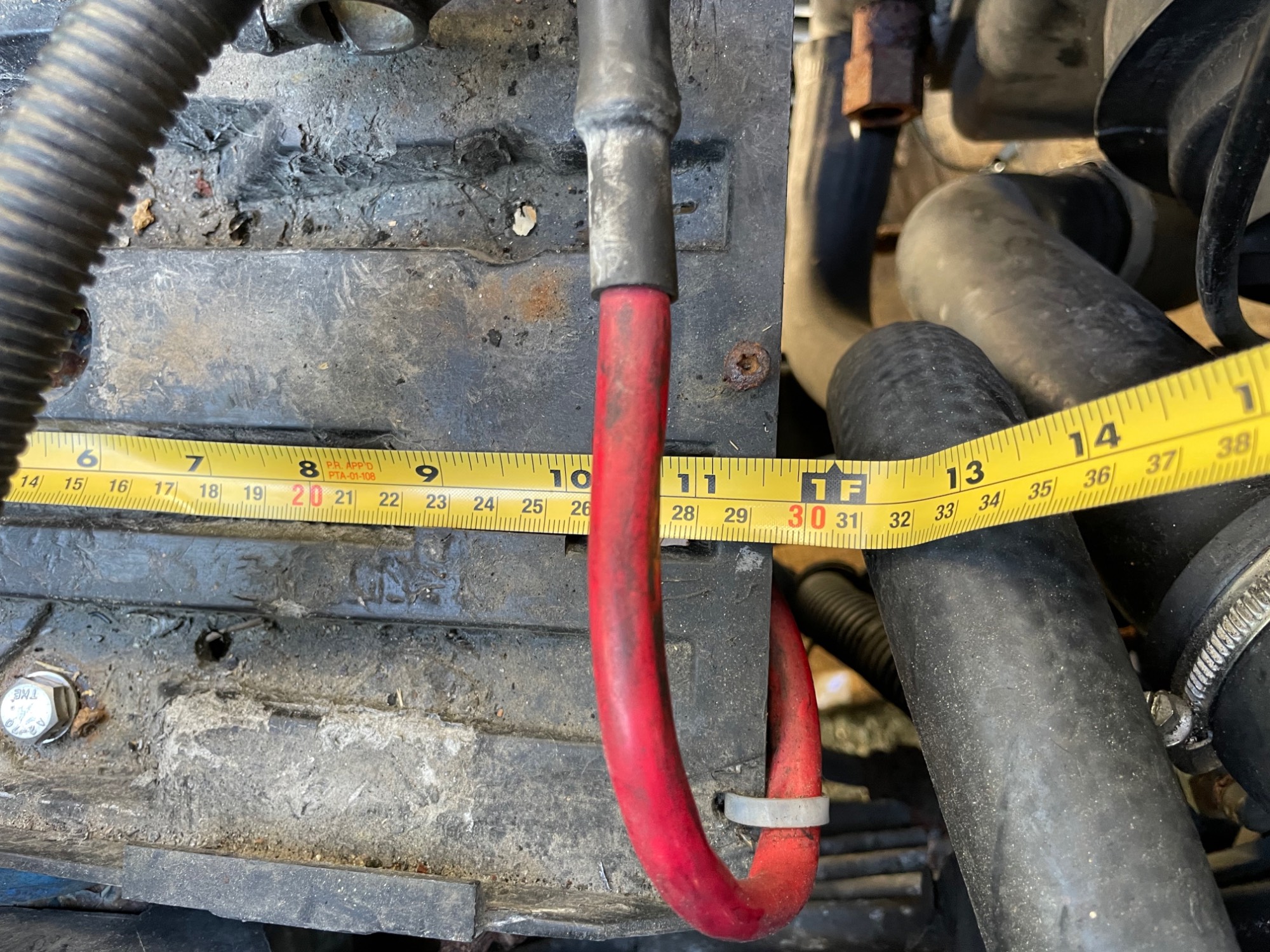

My H6 battery measures 13.75 inches in length. I compared to my 850 battery location. The only way I can see it would fit is by removing the fresh air snorkel.

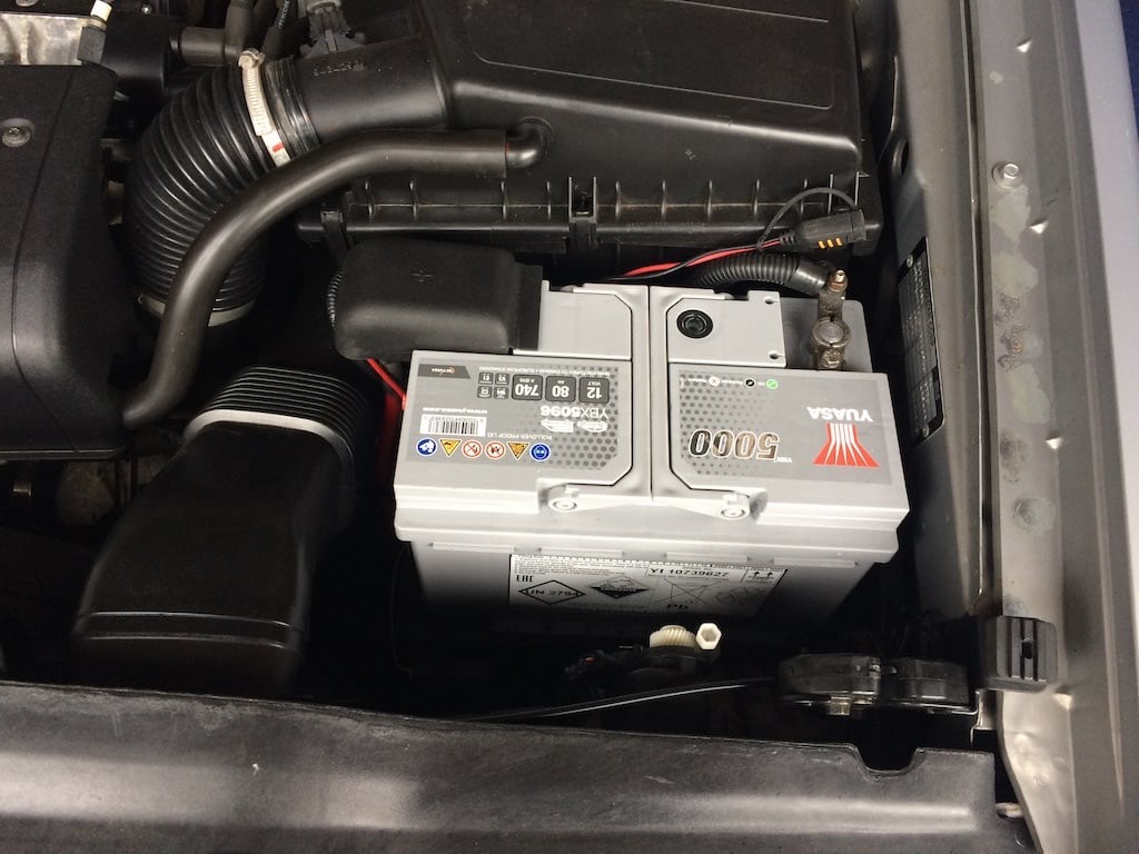

This is an 096 battery in my 850 which I believe is the same dimensions as the H6
Measures length 278mm x width 175mm x height 190mm (L 10.95" x W 6.89" x 7.48")
Battery clamp is at the last space so H6 is as big as the P80 tray will take and H7 will be too long to fit

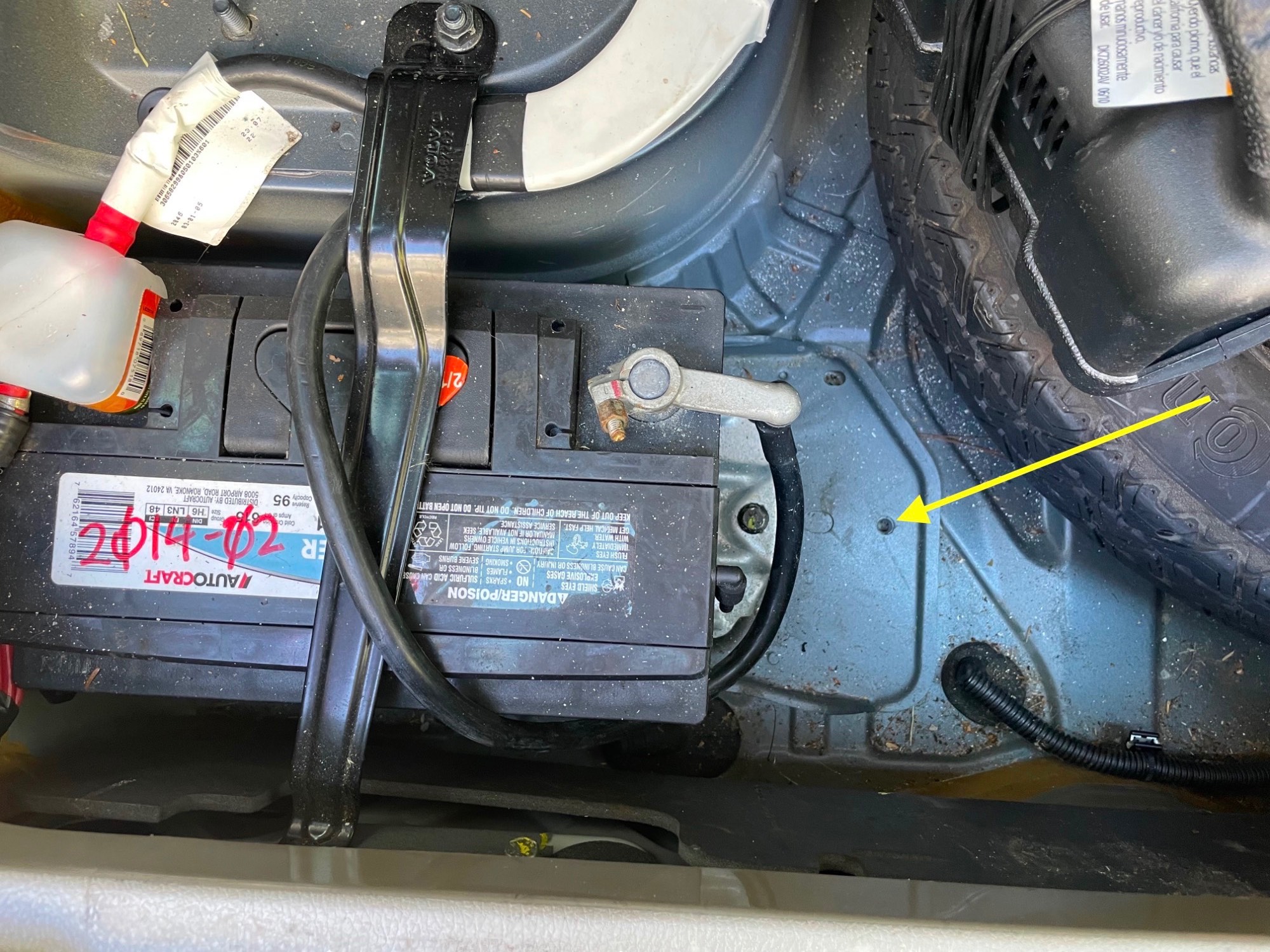

I could easily fab a battery hold down for the P80 but the P2 bracket is much harder.

The P2 will easily accommodate a much larger battery. 019 (which I believe is Group 49, H8) fits in at 353mm X 175mm X 190mm, just move the clamp along to the appropriate bolt hole
