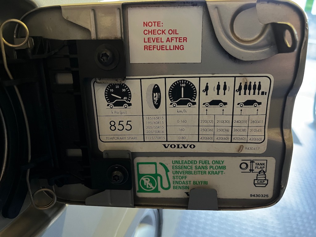

Greetings all,
I finally was able to locate some decent 16" rims and used tires with decent tread and even wear to replace the 15" snow tires I had on the '98 V70T5.
But winter is approaching and am now thinking about snow tires.
I don't have an owners manual, and the gas/fuel door flap only lists 205/55r16 as the recommended tire.
But what size snow tires are recommended? I've read some go to a 215/60/16, or to 15" tires.
Appreciate your thoughts/experience on this!

Get some studded Coopers for those 15 inch steelies, K. You want studs up in the North Countryside
- Posts: 15486
- Has thanked: 2199 times
The dealer here used to sell 185/65/15 tires. They work really well and cut through snow and grip better. If you are allowed studded tires and have packed snow/ice for long periods, then as per Abscate go for studded tires on the 15" rims. With the taller sidewalls they also resist pot holes better, especially if you have steel rims!

Thanks for your replies Abscate, scot850 and P80GLT!!
I do have some 15" steel rims and the odd snow tire...will see what I can do with them!
Studded snow tires would be awesome for our roads up here and especially since winter is lasting longer than in years past!
