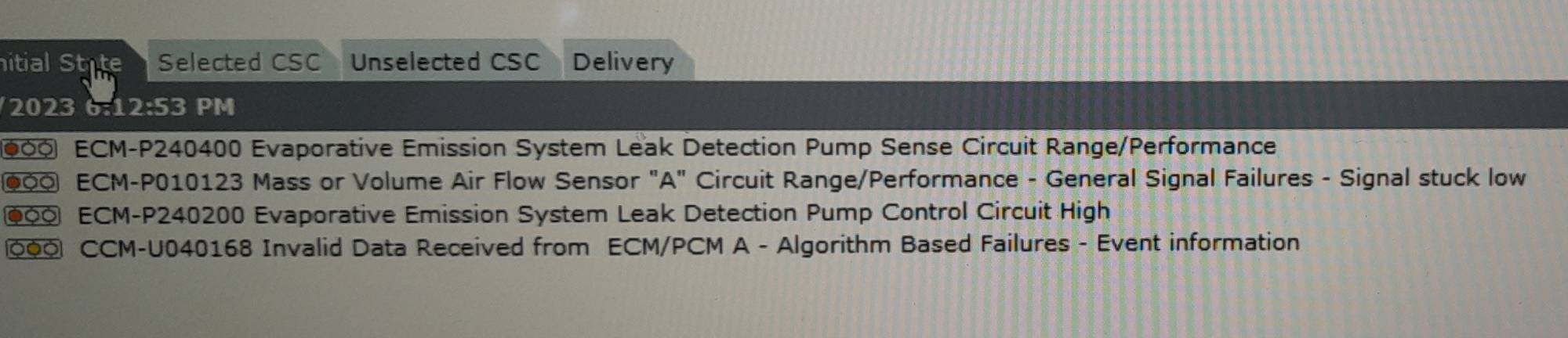

This 2012 S60 T R design, has a very low mileage. Strong smell of gas at the start which dissipates after a while.
I cleaned MAF, ETB, changed the EVAP canister ....still the same.

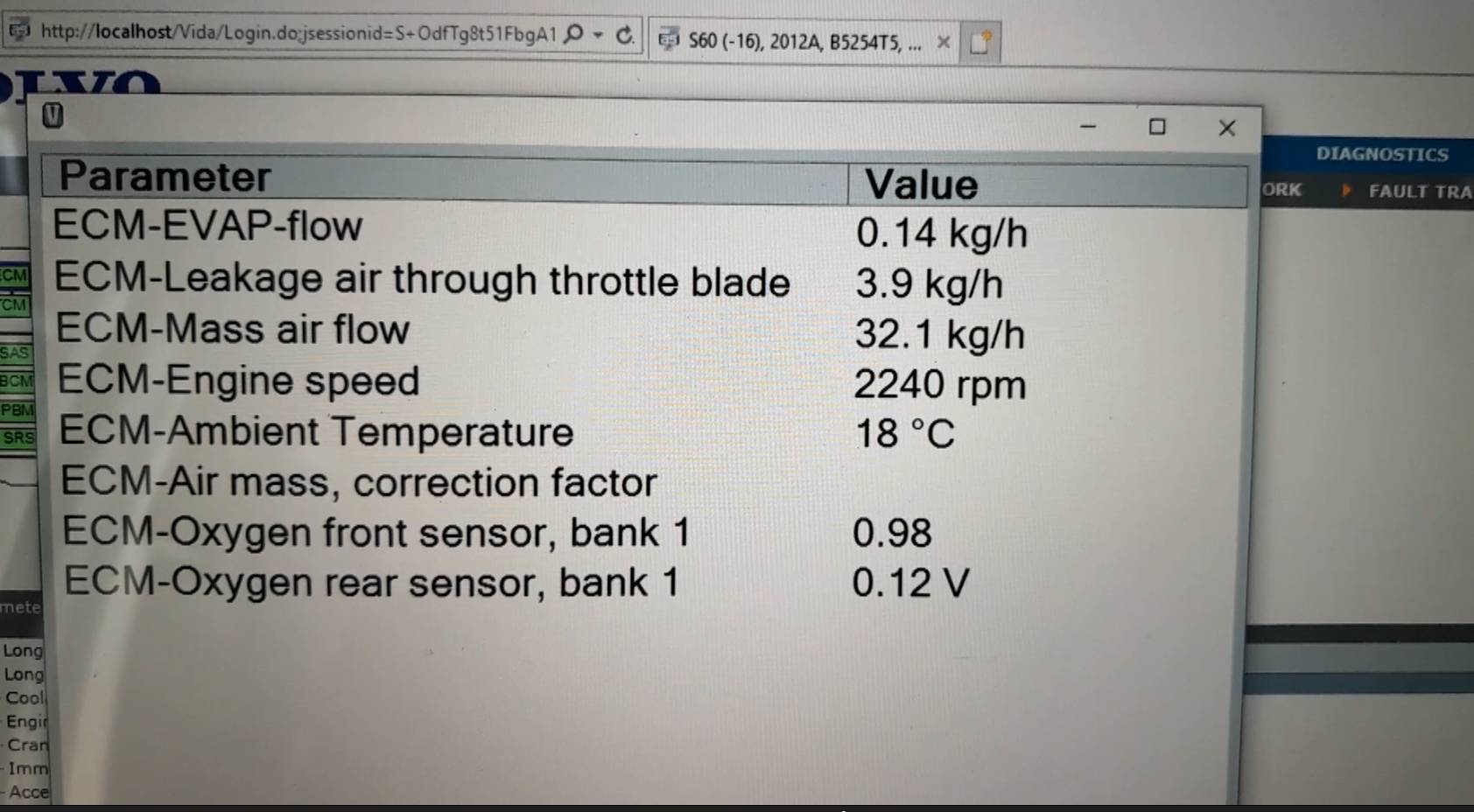

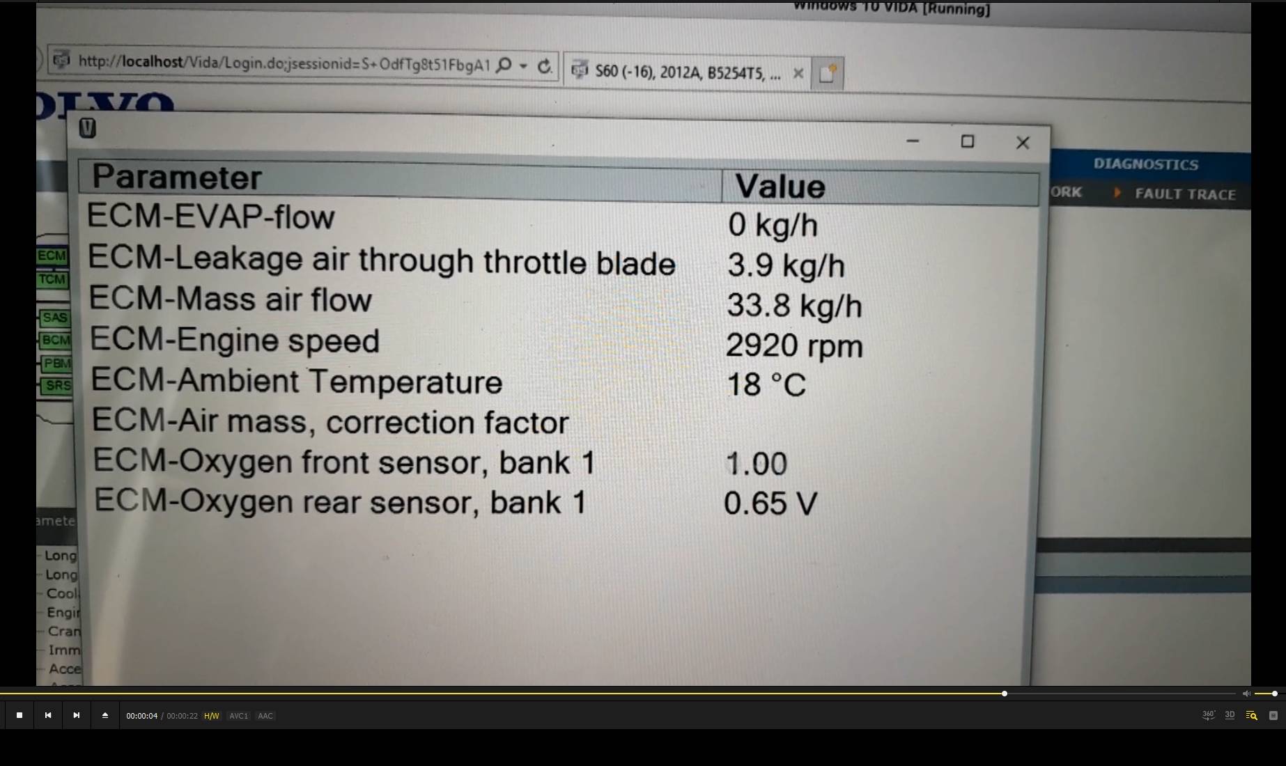

The following pictures with RPM @ idle, ~2K and ~3k
Can anybody tell what is wrong / not normal here.

Can you look at your fuel trims; if you've had air leaks and fixed those you may need to reset fuel trims otherwise the car may take a while to re-learn

You may want to see the trims' values first before blaming any expensive part. Long term fuel trims should normally be a single digit like 1 or 2 and steady. Short term trims will fluctuate with load and duty
