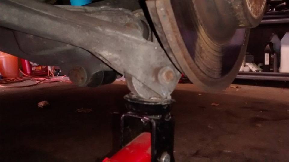

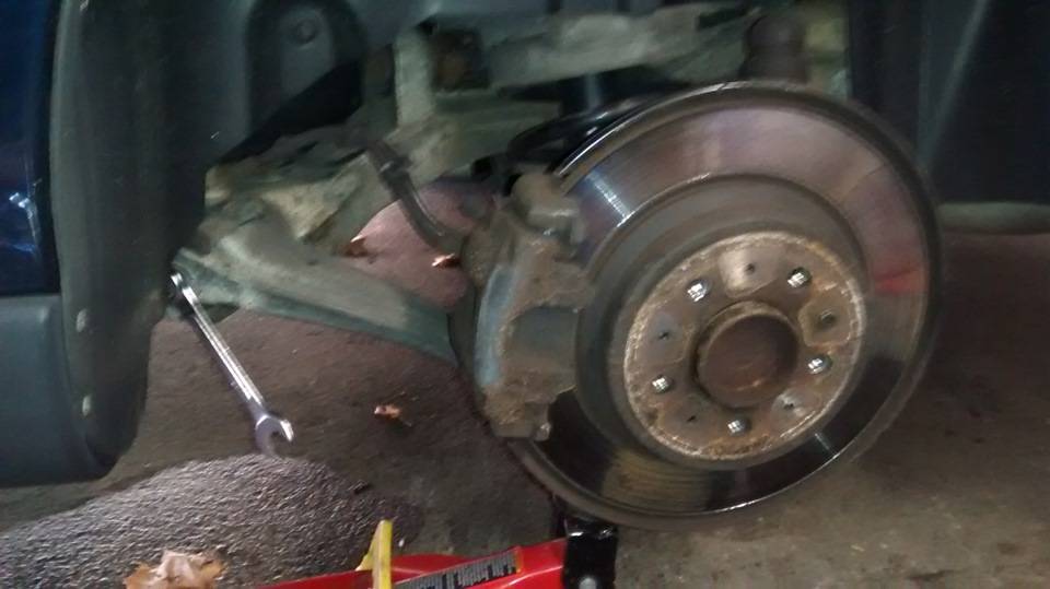

- Avoid using "Internal" spring compressors. They are dangerous to use. I mentioned that in the DIY link.
- It is a bit more work to drop the control arm, but
it is a safer approach. I used the floor jack as the "spring compressor"...
