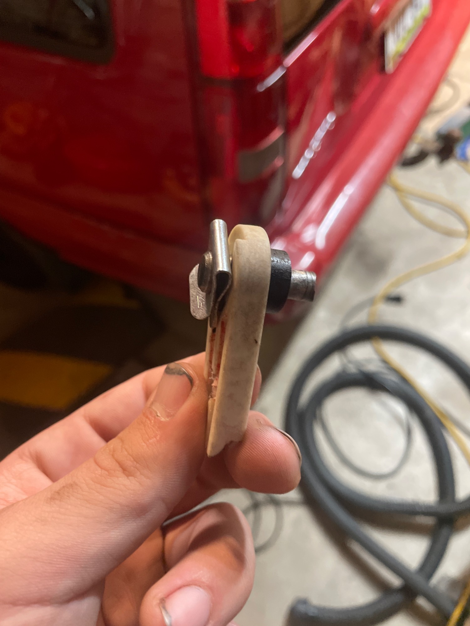

So I was driving. And as I goto shift I press in the clutch and hear lost of plastic snapping and the clutch pedal deceided to stay on the floor. Turns out the arm coming off the master cylinder that connects the master cylinder to the clutch pedal had snapped in half. So I ordered the new one and went to install it but when I opened the box it didn’t come with the hardware that connects the arm to the clutch pedal. I have been unsuccessful in finding what this pin or bolt is. Any help is appreciated

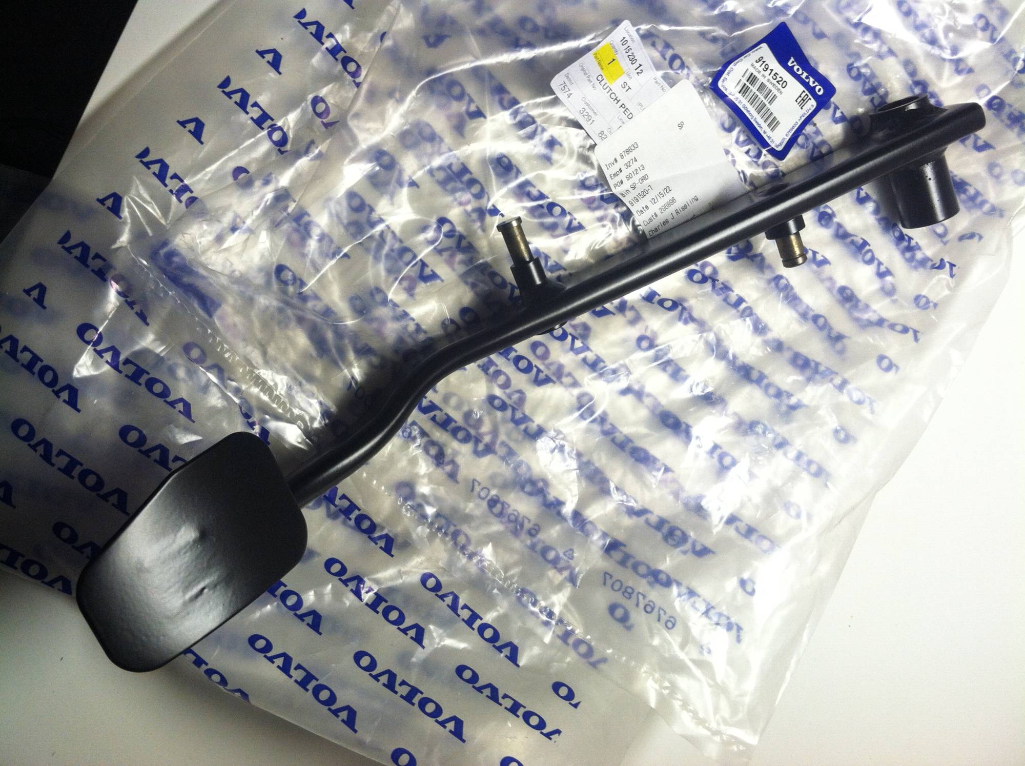

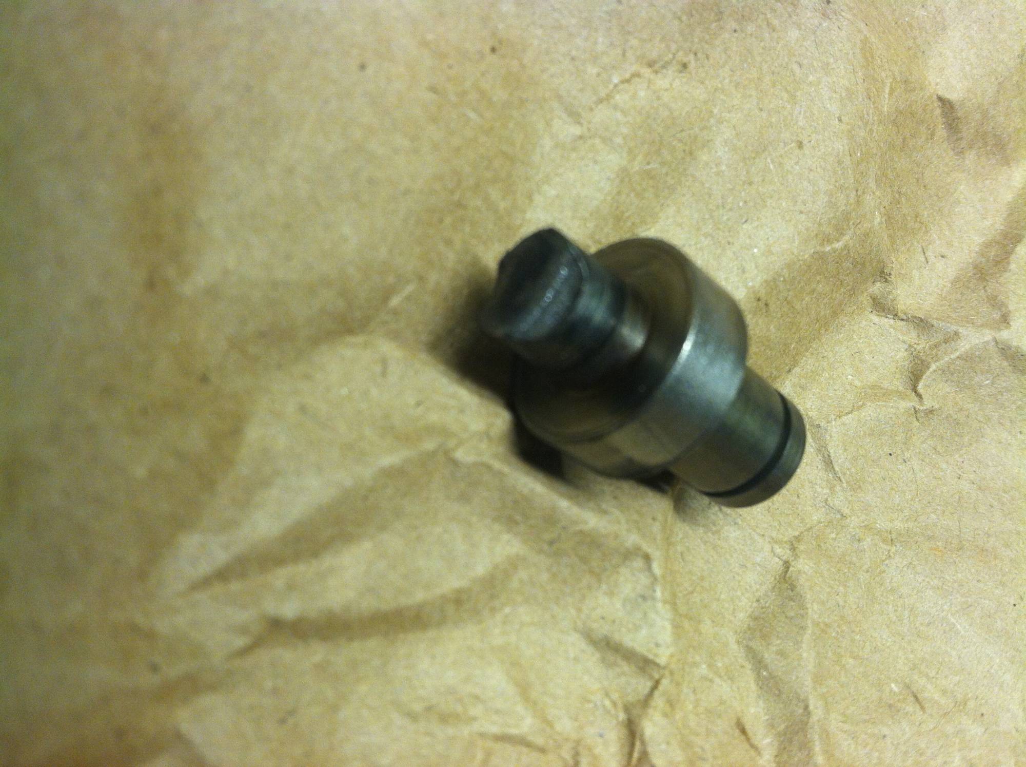

It looks like the pin has detached* itself from the pedal, you may need 9191520 The pedal shaft itself isn't solid, it's formed sheet stock seam welded, and the pins are both pressed into holes and end welded on the off side.ghansenv70 wrote: 17 Oct 2023, 17:54 So I was driving. And as I goto shift I press in the clutch and hear lost of plastic snapping and the clutch pedal deceided to stay on the floor. Turns out the arm coming off the master cylinder that connects the master cylinder to the clutch pedal had snapped in half. So I ordered the new one and went to install it but when I opened the box it didn’t come with the hardware that connects the arm to the clutch pedal. I have been unsuccessful in finding what this pin or bolt is. Any help is appreciatedimage.jpg
viewtopic.php?p=615973&hilit=9191520#p615973
Once you get the whole mess off the shaft, find somebody with tig welding skills, sometimes exhaust shops can be a resource.
.*Fatigue shear, what I should have said is it broke off. See the thread referenced, new pedal seems NLA .

That clip will slide off , then the pin drops out. Why can’t you reuse the old hardware?

That pin is likely a partial remnant of the clutch pedal assembly. I owned its twin for a time. Fabrication or a dip into the Volvo parts bin* are next.
[attachment=0]IMG_0247.JPG[/attachment
The probable failure mode was pin break, plastic break, walk.
*(Edit:
Oops. Even Skandix says NLA.)
*(Edit:

I think it was just wear by age or a weird coincidence. Some people run surprisingly stiff race clutches in these Volvos and don't break the stud off the pedal.
You should not be able to shear off that stud, this should hold way more pressure than humans can possibly create.

25 years and thousands of shift cycles can fatigue any metal bits. Since it is only welded on the 'far' end of the pin, any slop in the fit on the spring side of the pedal can cause it to flex inside the hollow shaft. My guess is the problem has happened plenty of times, it just hasn't gotten much airtime. Situation status is now critical since the part is NLA. Congratulations on finding a spare. Think about fixing the old one if you can.ghansenv70 wrote: 18 Oct 2023, 21:37 My only worry now is what could of cause the stud to sheer off the clutch pedal as it would require some force. I’m hoping that the master cylinder locked up but I am starting to worry about the slave cylinder or the clutch itself
