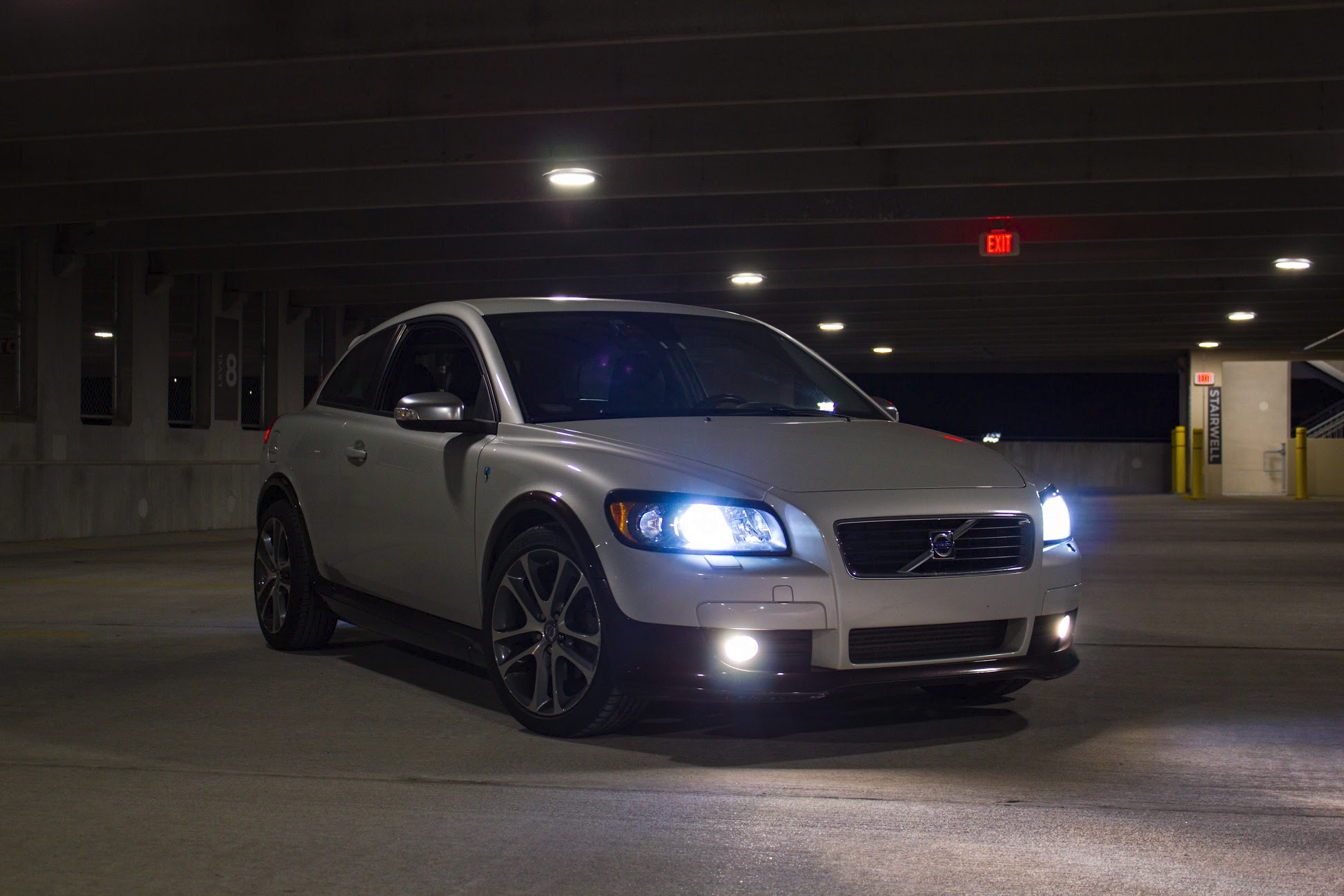

My suggestion is to go LED and just rattle can the reflectors. Some have used the reflective plumbers tape, actually, come to think of it we did this on the small reflectors in the 08 C30 when we took it apart and added the Halo LED.
Gaffer Power Aluminum Foil Reflective Duct Tape - Lowes & HD should have also. Don't rub just push tape down and keep finger oil to a minimum by spraying some alcohol to clean your hands so the surface is not smudged. Not critical but helpful.
(www.amazon.com/Gaffer-Power-Reflective- ... B08JPY2PPX)
Paint from Lowes
(www.amazon.com/Rust-Oleum-7718830-7718- ... 106&sr=1-1)
The rattle can refurbish and LED upgrade is in the middle of the link.
