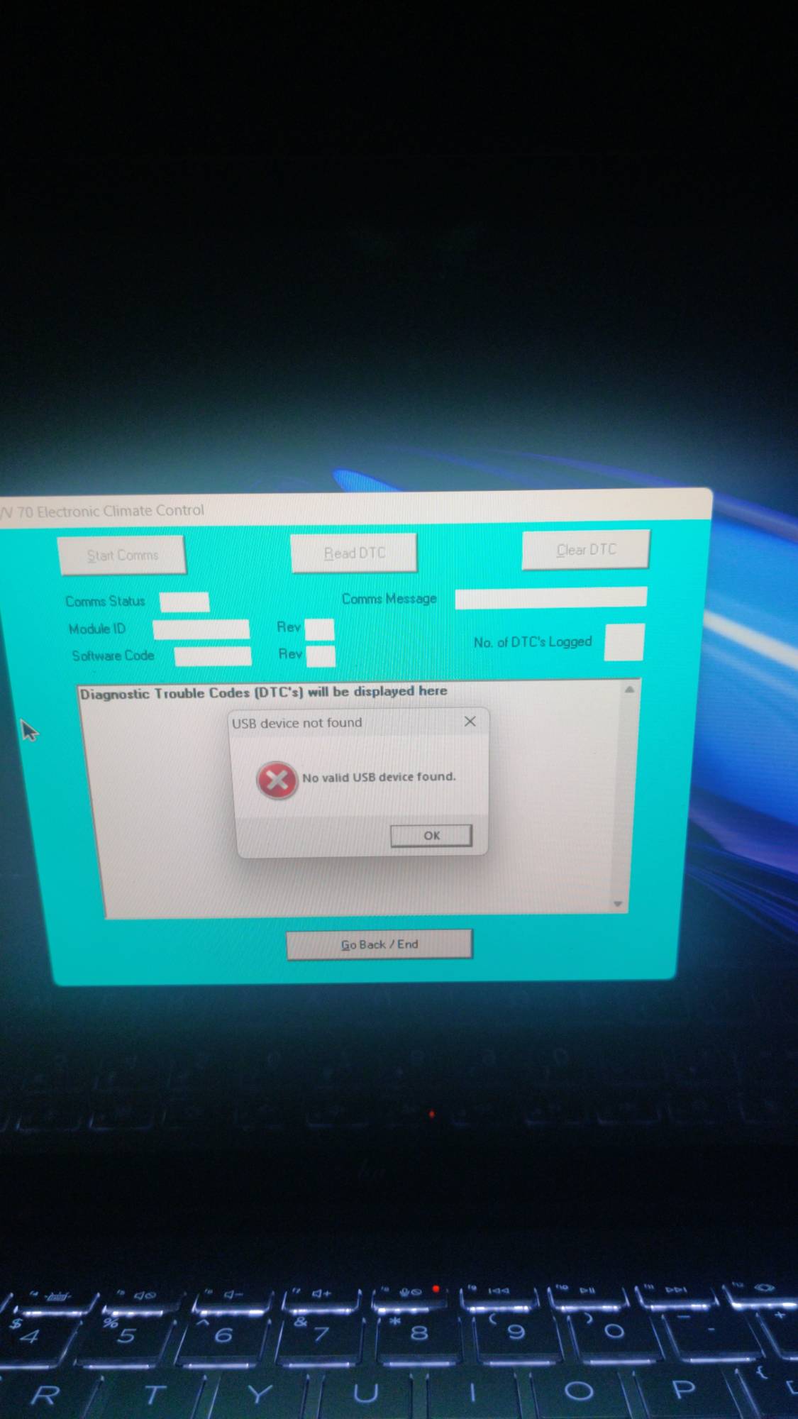

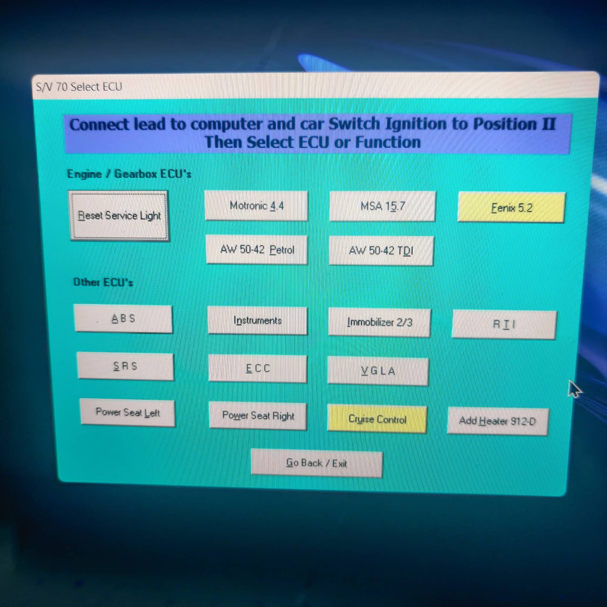

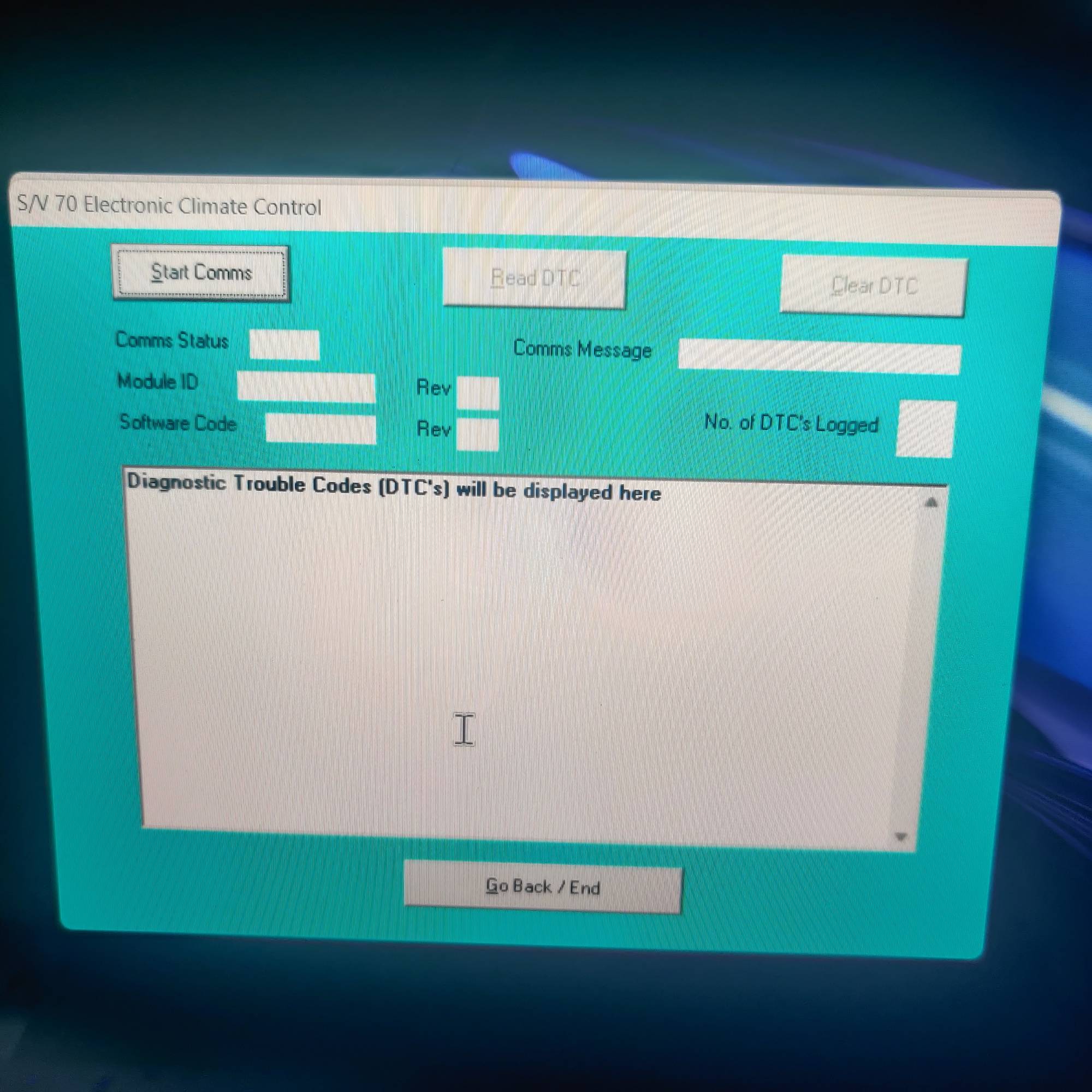

I got the cable connector from my laptop to the obd port in the console storage.
I downloaded the test (free) version of Volvo-FCR software
I'm not getting connection from my USB port to the software
QUESTION
is there a fuse to power up the OBD port what may be blown? what number and location?
I'm concerned that my ODB port isn't working (had issues with emmsions reading machines in the past, so this makes sense)
fuse number and location, any ideas?
here are some screen shots
thanks!

The problem is likely your cable or software. Get the 850 OBDII app and a Bluetooth dongle instead.
To verify the port has power, check for +12V on pin 16 and ground on pin 4/5

Is any other scan tool currently able to interface with the car? That would be my first question.

98 cars do not lock vins to the cluster. I swapped one with the trip computer enabled into my old car with no issues nor codes pulled on either the VOLFCR nor my scan tool. Id say you probably have an issue with the scanner itself. I had to install a few different drivers to get mine to work with a VAGKKL cable.scot850 wrote: 07 Nov 2023, 08:22 I'm trying to think why it would not work, but as you know I am no expert in this area of the car. I will try to have a look at a wiring diagram and see if the power runs through a fuse somewhere, but it is unusual for it to be on a sole fuse and not with something else.
Most issues are usually wiring related with a broken wire or dirty connection somewhere.
I'm wondering is if someone has even played with the ECU. On the 99- cars if you swap the speedo cluster, as it stores the VIN # you cannot then talk to the ECU as it checks that the Vin# held in both places is the same to prevent people mileage swapping their cars. I'm not sure on 98 cars if that is the same.
By removing the 2 connectors under the cover below the parking brake, you could check the connector has not been on the receiving end of a cup of coffee, but then also continuity check the cables to the OBD2 socket to make sure the wiring is good at least that far and that the socket is good/undamaged.
Hopefully someone with better knowledge of these parts can chip in.
Edit:
didnt read the last part of the original post. Ask autozone or someone to attempt to scan the car, if it cannot connect then proceed to the fuses. No use fiddling with something we have not confirmed is broken.
