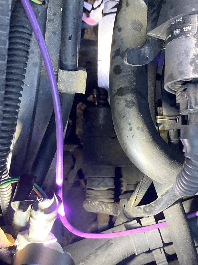

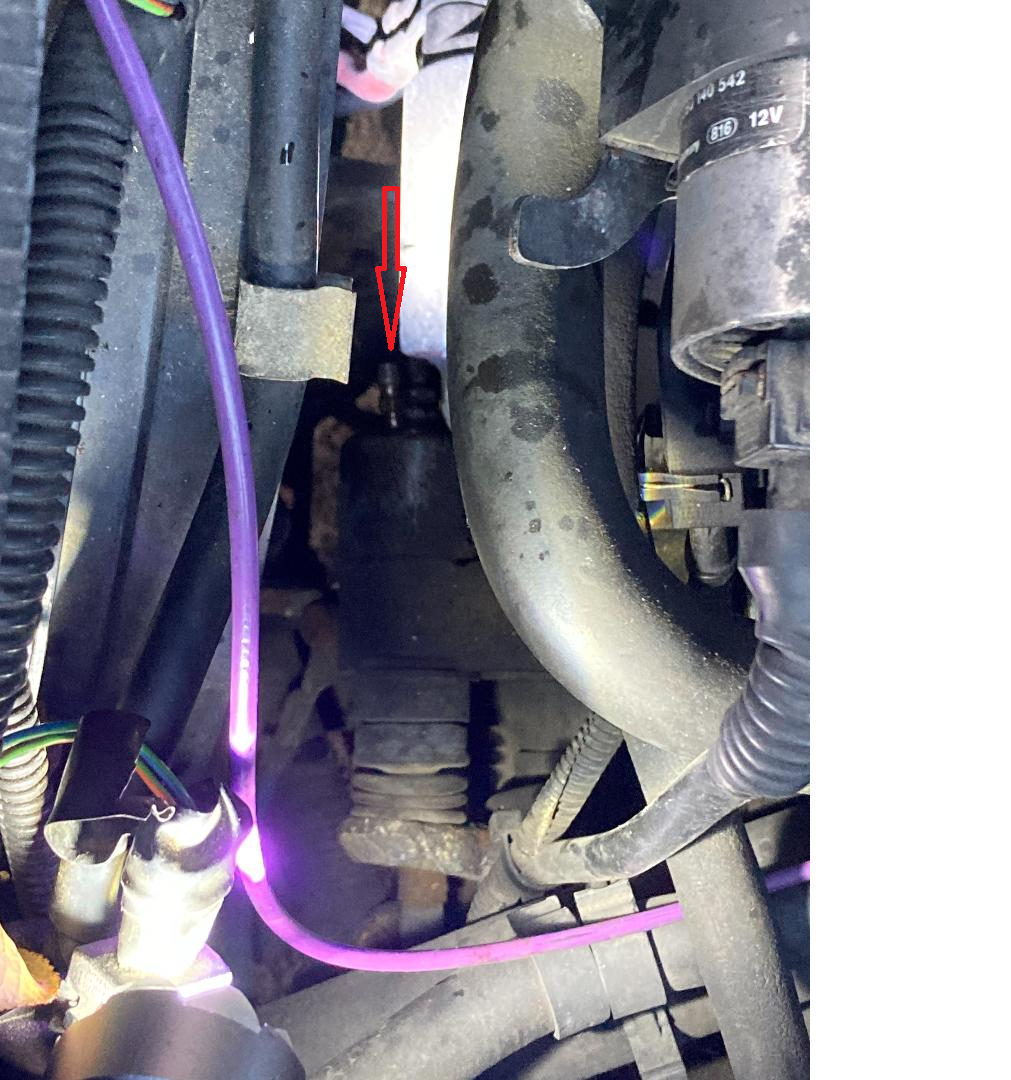

Just checked the brake fluid and it was about 1/2 way full. I will try a bleed.
Is this the bleeder screw? For the clutch?

- bleeder.jpg (134.6 KiB) Viewed 608 times
- bleeder with arrow.png (1.46 MiB) Viewed 607 times

These cars use hydraulic clutches, which self adjust and have no cables?This began as not too bad. While being inspected my mechanic told me my clutch cable was broken. I've replaced it and adjusted it per Robert DIY.
Puzzled ....

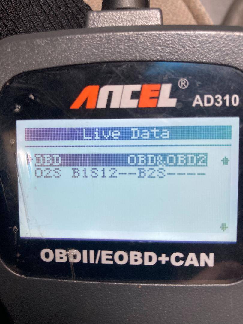

am I correct that this indicates a bad downstream O2 sensor and could this be my problem?
- data mia.jpg (142.14 KiB) Viewed 560 times
- data mia 2.jpg (104.92 KiB) Viewed 560 times

You have atleast 2 issues. You should not see exceptional amounts of white smoke coming out when stopped.
What is your long term fuel trim? LTFT
Ignore the kickdown i forgot this is not an auto. Post your LTFT. Also what is the max RPM your car gets too. If its high rpm no movement then usually its a trans issue, if its never getting to high rpm then maybe it could be your throttle. Do you have any foot floor protectors that are preventing the pedal from going all the way down?
