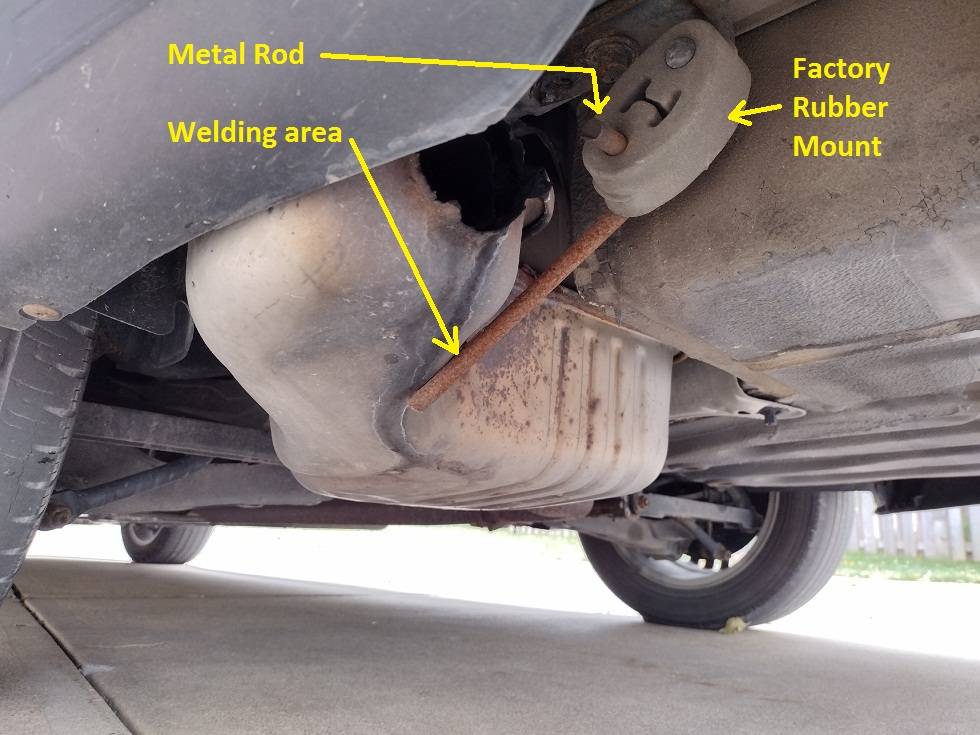

- The FCPEuro link posted above is for the pipe in the middle.
- For the muffler itself, use a rebar (muffler shop has it)
and weld it to the body of the muffler. The other end goes
to the rubber hanger. I will take a photo and post it later...

My 2007 S60..The tailpiece fix (on page 3 of the thread in the link below) just failed in one year.
viewtopic.php?p=636464
My 2006 S60...the previous owner had the local muffler shop did this repair using a rebar
as shown. In a way, this is a clever fix, I like it...
If you have a shop do it this way, make sure they support the weight of the muffler using a jack
or something before welding the rod in...

The bracket only works if the tail piece is still attached.
Even so, it is a bad place as it puts a strain on the welding spot. Bad factory design.
The photo I showed you above (done by the previous owner) should have been the factory design from day 1!
