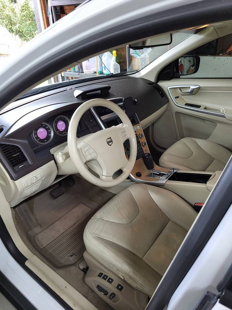

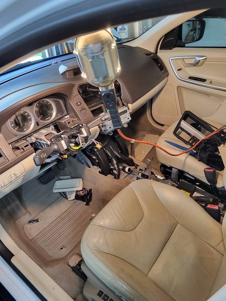

I recently retrofitted the 2013+ steering wheel (and gear shifter!) onto my 2010 XC60. Everything on the wheel works, cruise control, radio, Bluetooth, but NOT the horn.
I have verified the fuse is good, so that's not it.

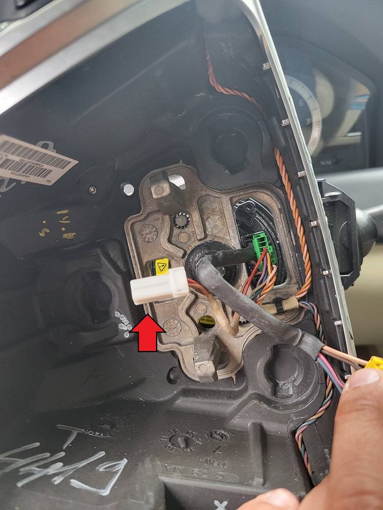

There is a white connector (red arrow) on the newer black steering that does not go to anything, and was not on the original tan steering wheel I took out. Does anyone know what that does?
I have also seen this https://www.ebay.com/itm/283394672166?_ ... p_homepage module on some wheels, but the connectors do not match.
I'm also thinking maybe I need to retrofit a newer clock spring. But I just find it odd because everything else works.
