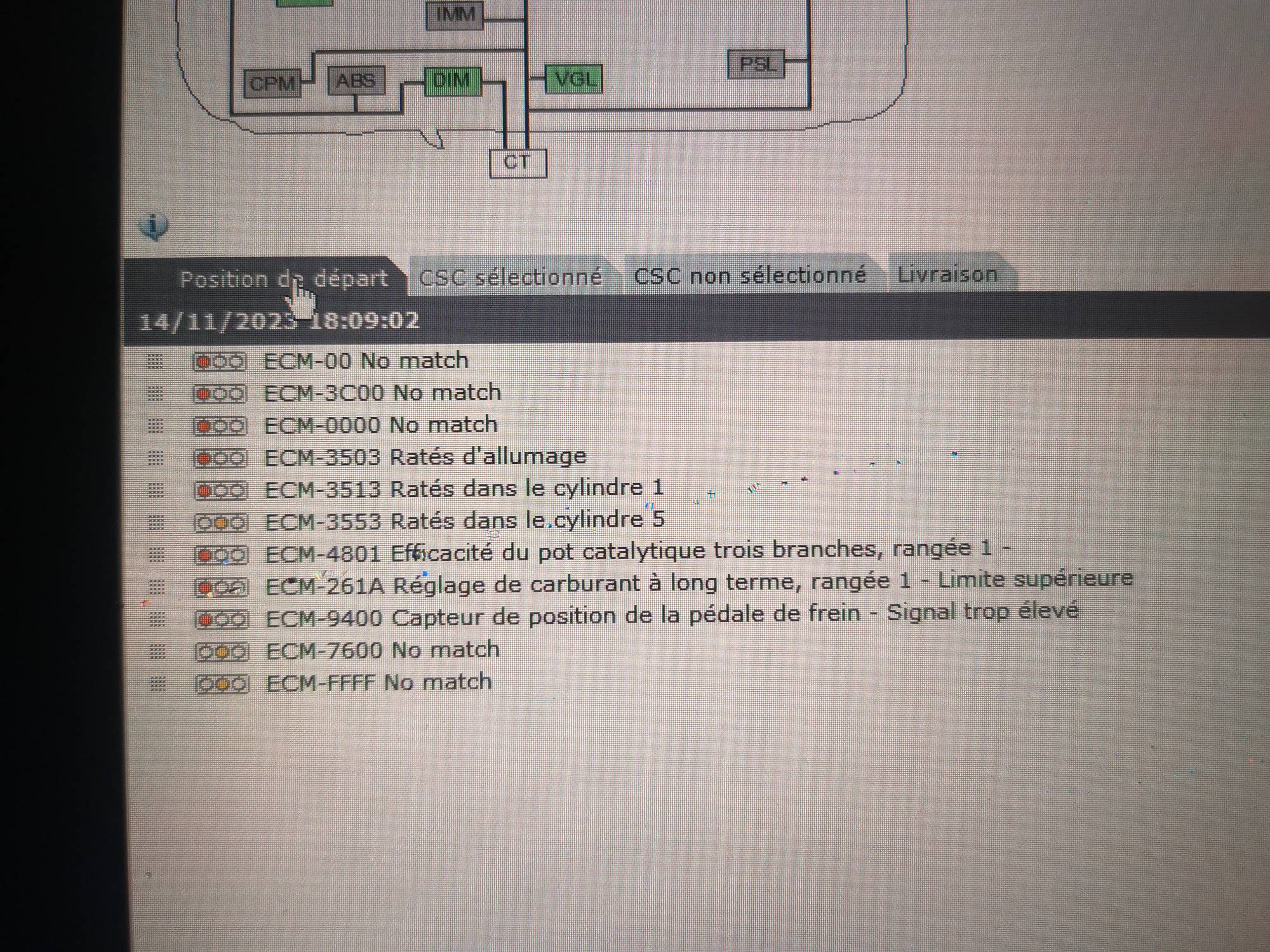

So here are the code that vida threw:
Ecm 3503 misfire
Ecm 3513 cyl 1 misfire
Ecm 3553 cyl 5 misfire
Ecm 4801 cat converter efficacity
Ecm 261a long term fuel trim, too high.

Can bad coils throw the long term fuel trim upper limit code?
Good question. until today I had no issue with the battery so I guess it is fine. i cleared all the code but if they came once, I can imagine they will appear another time as I regularly check for codes.wizechatmgr wrote: 14 Nov 2023, 16:37 I'd clear all the codes out with VIDA and try again.
What's your battery state of charge? If your alternator is weak and you sit in non-moving traffic long enough, low voltage makes these cars get majorly unhappy. If the voltage goes low enough the throttle control module will stick the car in idle and not let you accelerate.
