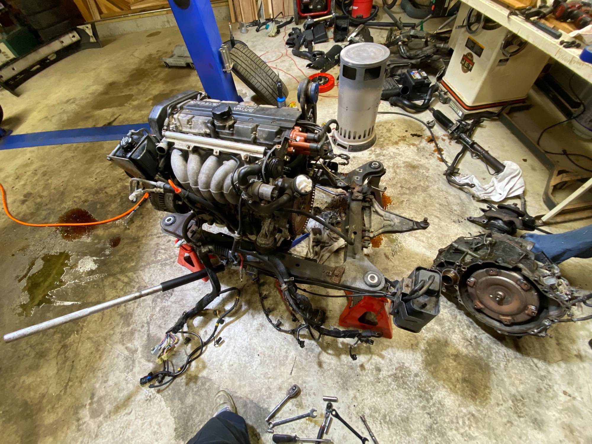

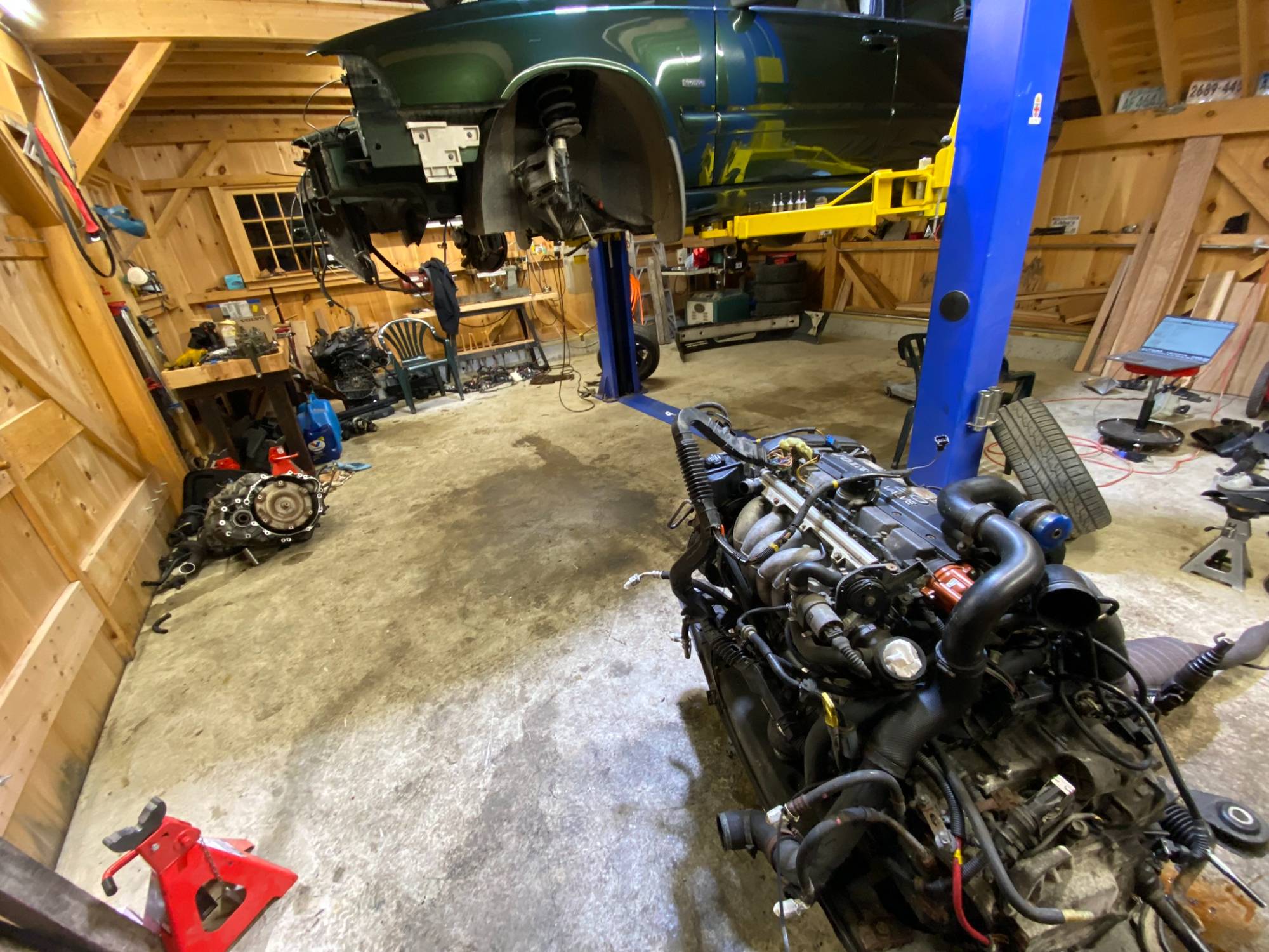

So, finished up the engine out service on my '98 V70 AWD to replace rear main seal, steering rack, cam seals, radiator, Japanifold, and 16T upgrade. Everything seemed great, but now I'm running into some odd issues with running and idling. Take it for a drive, and it runs fine cold (and when driving normally when up to temp). Pulling into my driveway, the car starts idling weird, misfiring, and occasionally just shuts itself off completely.

Pictures of the engine out service to give you something to look at:
