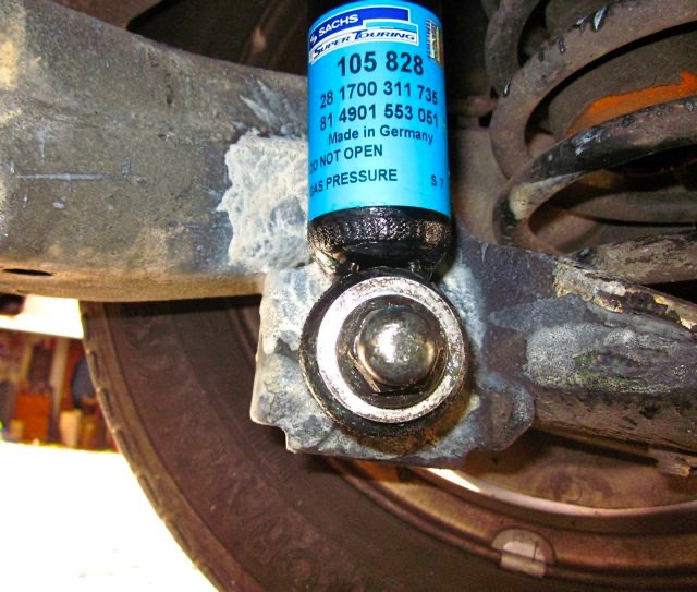

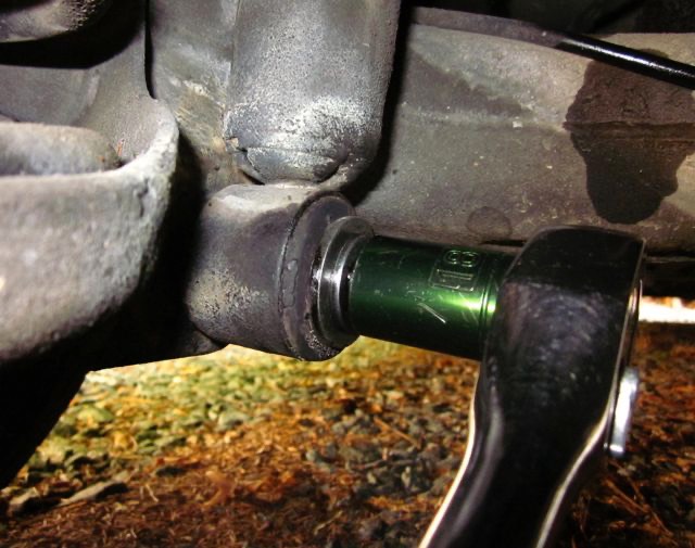

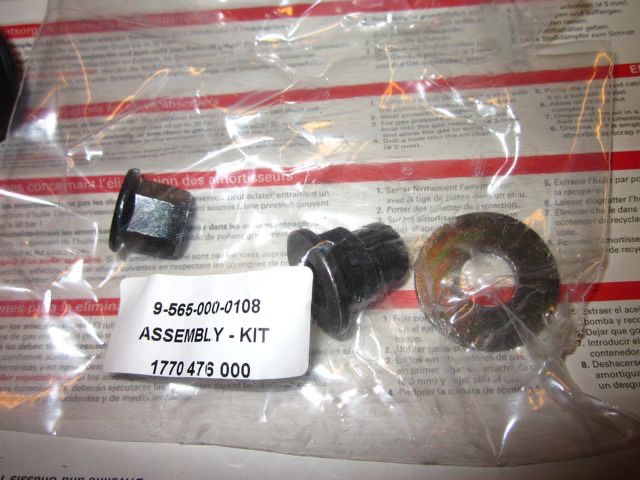

When I replaced the rear shocks on my 97 855, the kit came with a new nut and washer to go over the bottom bolt.
Here are some images of the kit and the washer in place between the shock and nut:

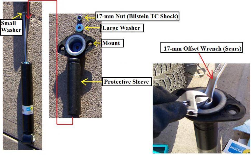

Sorry I meant these washers

The top nut on my kit had a flange, which I guess takes the place of a washer.
It sounds like you added a washer on top, which should be fine -- at least I can't see why it would cause a problem.
