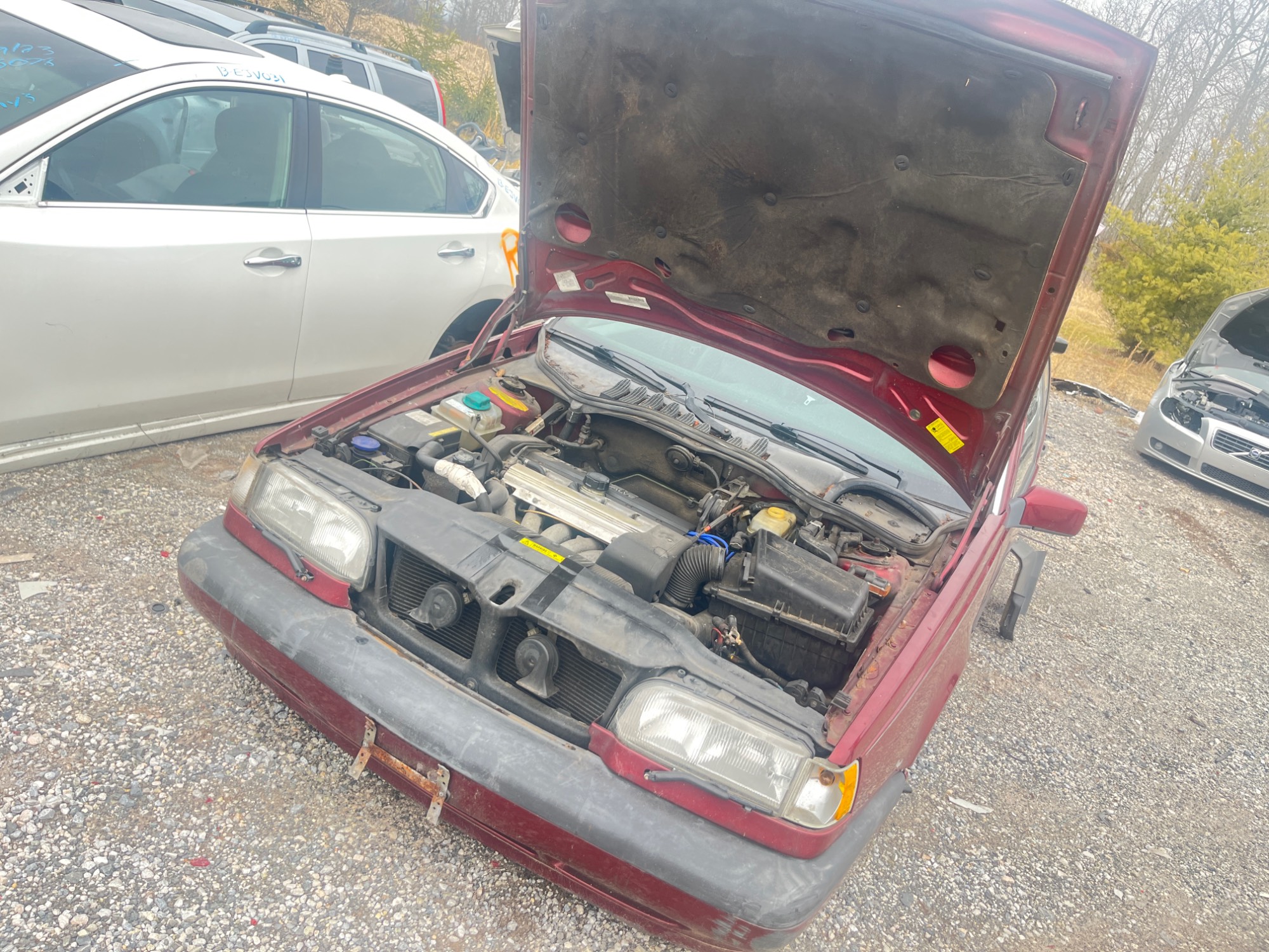

Hi all! I’m once again pinging the forum, but rather than begging for mechanical advice or asking a dumb question, I instead want to hear your thoughts about this 1995 850 Wagon at my semi-local junkyard:

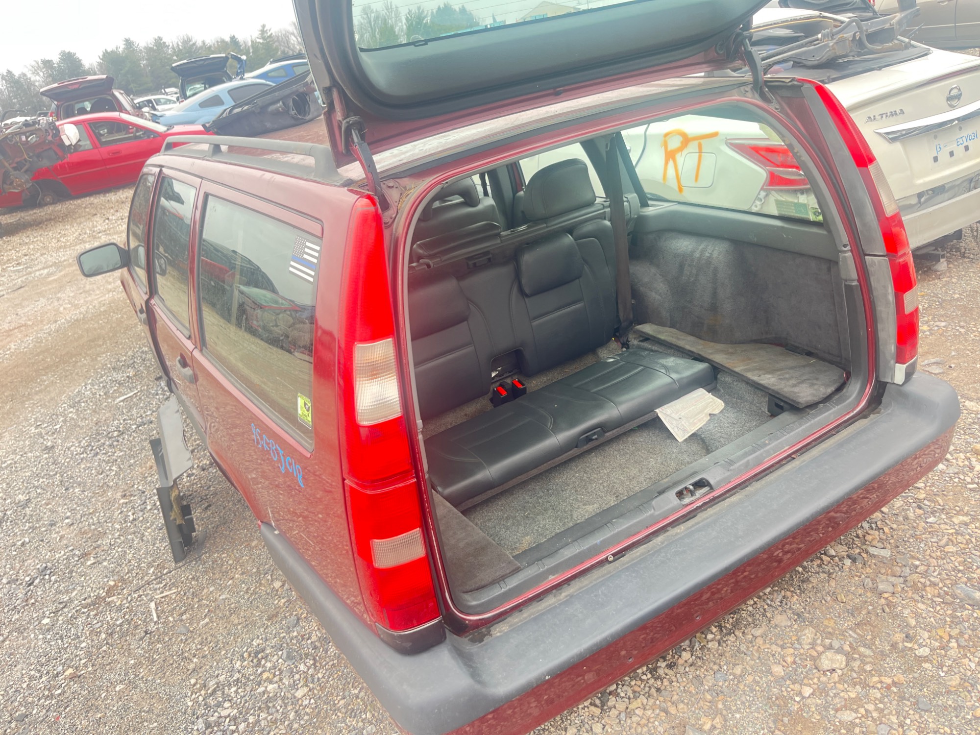

It’s not new, I just haven’t taken a closer look at it until today. Has brake fluid in the reservoir and the pedal feels good, very little stripped out of it, and rear facing seats in the trunk!!! They’re miserable for my 5’10” self to fit in but they’re so cool!!!
Anyways, I was wondering what you think may be wrong with it or if I could throw in a battery, fill it with fluids (oil, gas, trans if drained), and see what happens… though, idk how pick and pulls feel about trying to start a car on the lot… probably not too keen on it.

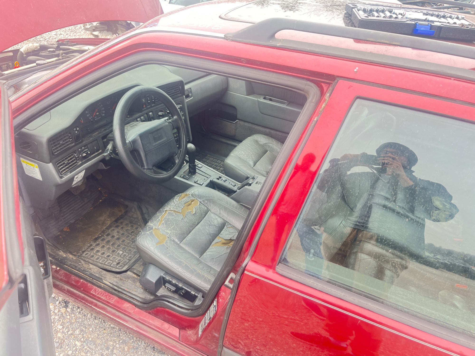

My guess is it is something to do with the automatic transmission. It has 190k miles which is still a low-ish number, and the registration was still valid (it’s in the glovebox, and I did take down the previous owners name). Seems too clean to be here and while I no room and no right to “save” this thing, boy do I want to :P

Probably a transmission issue, or perhaps even a snapped timing belt.
The dash looks to be in nice shape, which is a shame.
To the average person, these are just old cars, and not worth fixing when something "big" goes wrong.

Like Chuck says. You may never know why it is there. You may also find the yard is reluctant to sell whole as they can usually make more in parts that selling the whole car.
Check the timing belt to make sure it is not broken, if not then it could still have a head gasket issue, burnet/bent valves or who knows what else. If the yard is ok with you trying to save it and try to get it started then if you have the time, go for it.
